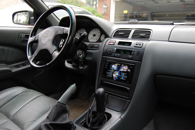

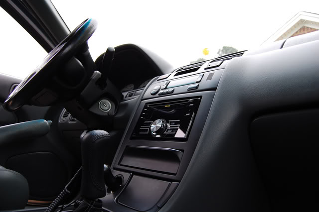

    Hard to decide which section (Buying Advice or???) to put this in but I originally got some info here so thought I'd post it here. Although I don't have an iPhone I found a thread in this forum that caught my attention regarding a new head unit for my car. I have a 97 Maxima SE ("Max", of course;)) that has the oem Bose system in it. I've been having problems lately with cd's that refuse to play all the way and the screen info comes and goes. So, I've been looking for a replacement double din unit. Looked at touch screens w/ and w/o nav and came to the conclusion that what I really needed was something with the following requirements: cd/mp3 capability (single cd was fine); iPod connectivity; BT so I could use my SE 810i; had to fit the oem "hole" without modification; and the price had to be reasonable. Oh yeah, had to look good and be of good quality. The Pioneer FH-P800BT was recommended by a poster here as working great with an iPhone so I started researching. This unit is fairly new but the reviews were very good. Price was right and it fit my requirements. The other day I went out with my sons and tried to hunt one down to check it out. Struck out at two places but the third had the unit and they were able to give me a demo. The unit looks great and had everything I wanted. You can add "HD" radio (not any stations here in Savannah), Xm or Sirius if you want. Very clean look as you can see. SOLD!
    :D Got my Pioneer FH-P800BT installed yesterday. WOOOOOOOEEEEEEE! First, it looks great! Fits in the same "hole" as the oem Bose, no adjustments needed. Second, did I mention that it looks really good? Not quite as understated as the oem Bose but it doesn't jump in your face either. Looks good. Sound is wonderful. I had the usb cord for the ipod run to the armrest box and it works great. The BT phone pairs easily with my SE 810i and has downloaded all my phone numbers and it works. Get into the car and the phone pairs and I'm ready to go. Tried the CD player and it works great but haven't tried a MP3 disc yet. Oh yes, mike for the phone is installed just above the rearview mirror....pretty unobtrusive. Really happy so far with the purchase. This is a very slick radio. About my only complaint is that the main manual is on cd and that the radio seems to have a bit of a steep learning curve. Interesting feature: blackout. You can black out the screen if you like. So, if you're looking for a new head unit for your car you might want to consider this Pioneer. Cheers
