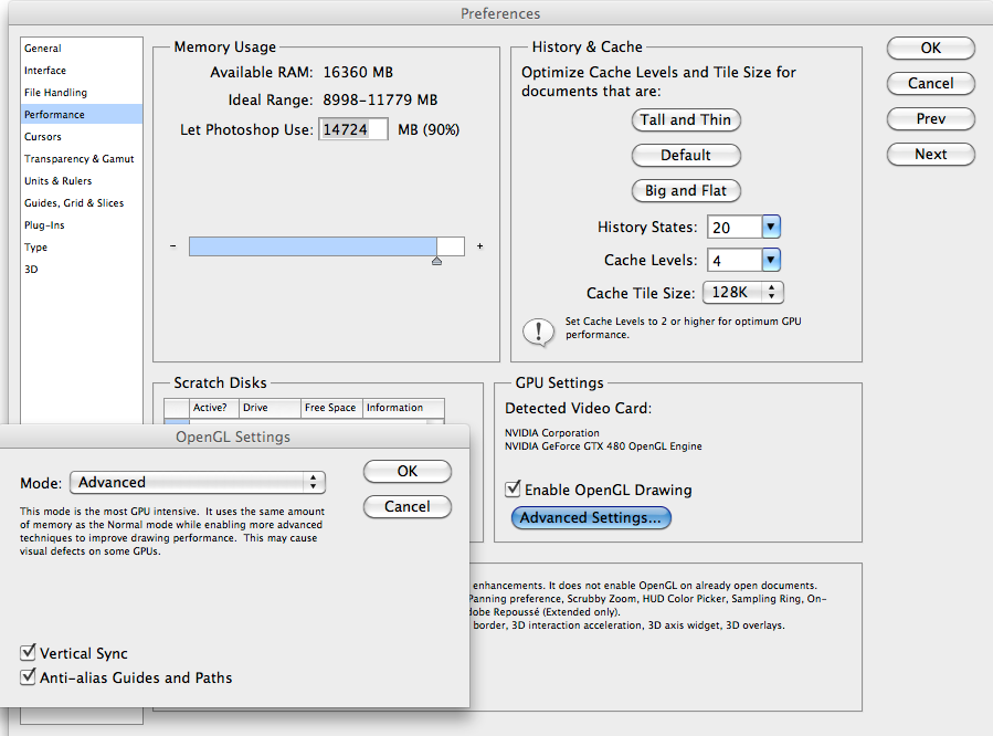

Time to update, Straus.
I'm also using an SSD as scratch disk.
GTX480 is doing it's part as well.
See Photoshop Fly !!!
Also, for some reason my it has started to say that my mac doesn't have enough memory to complete tasks (I have 8gb), shouldn't it just use scratch when it runs out of ram?
Are you sure it isn't the "not Enough Vram" warning when the GPU runs out of RAm and it turns off OpenGl acceleration?
A 256 Meg GPU does so pretty quickly.
