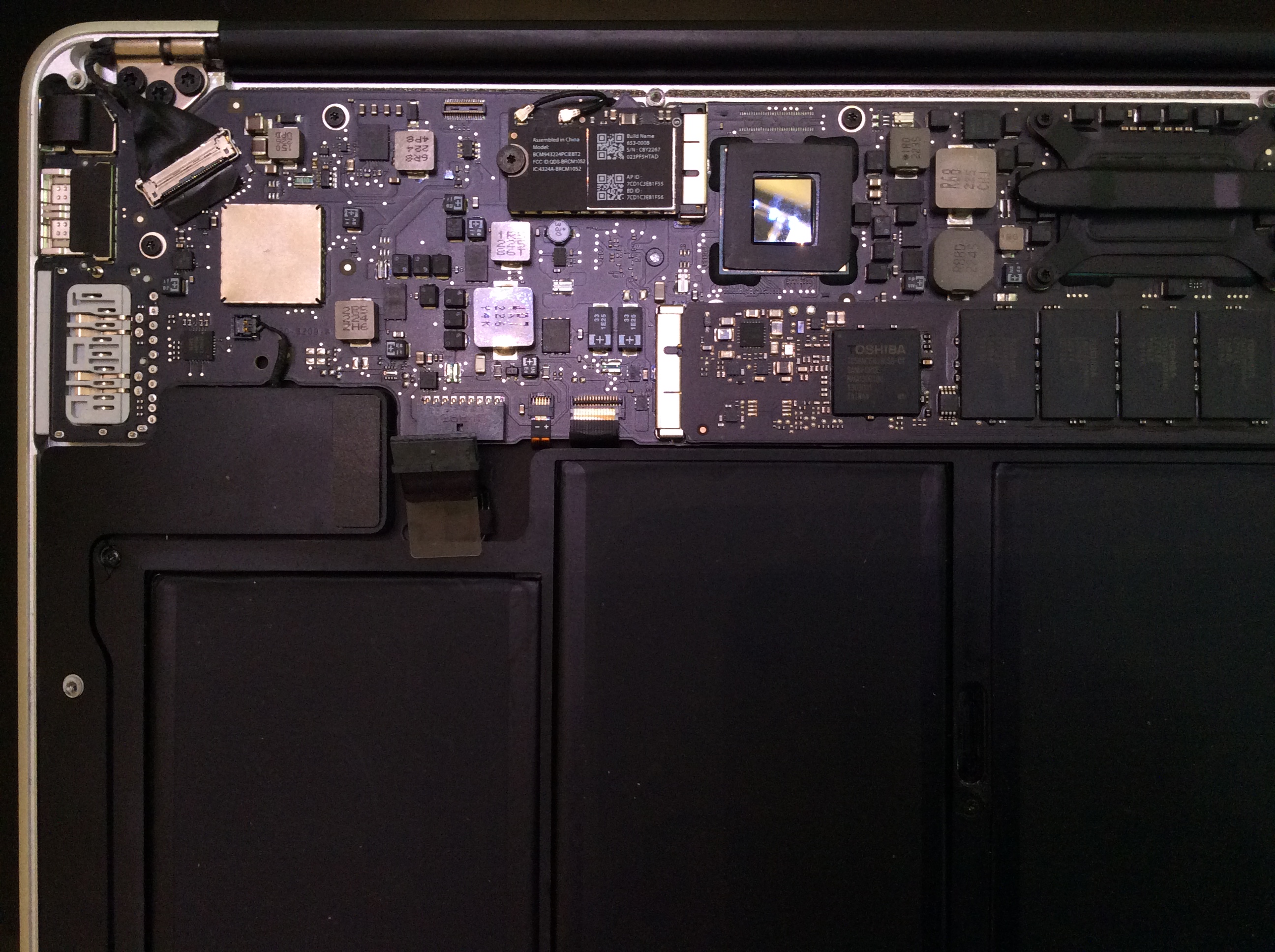

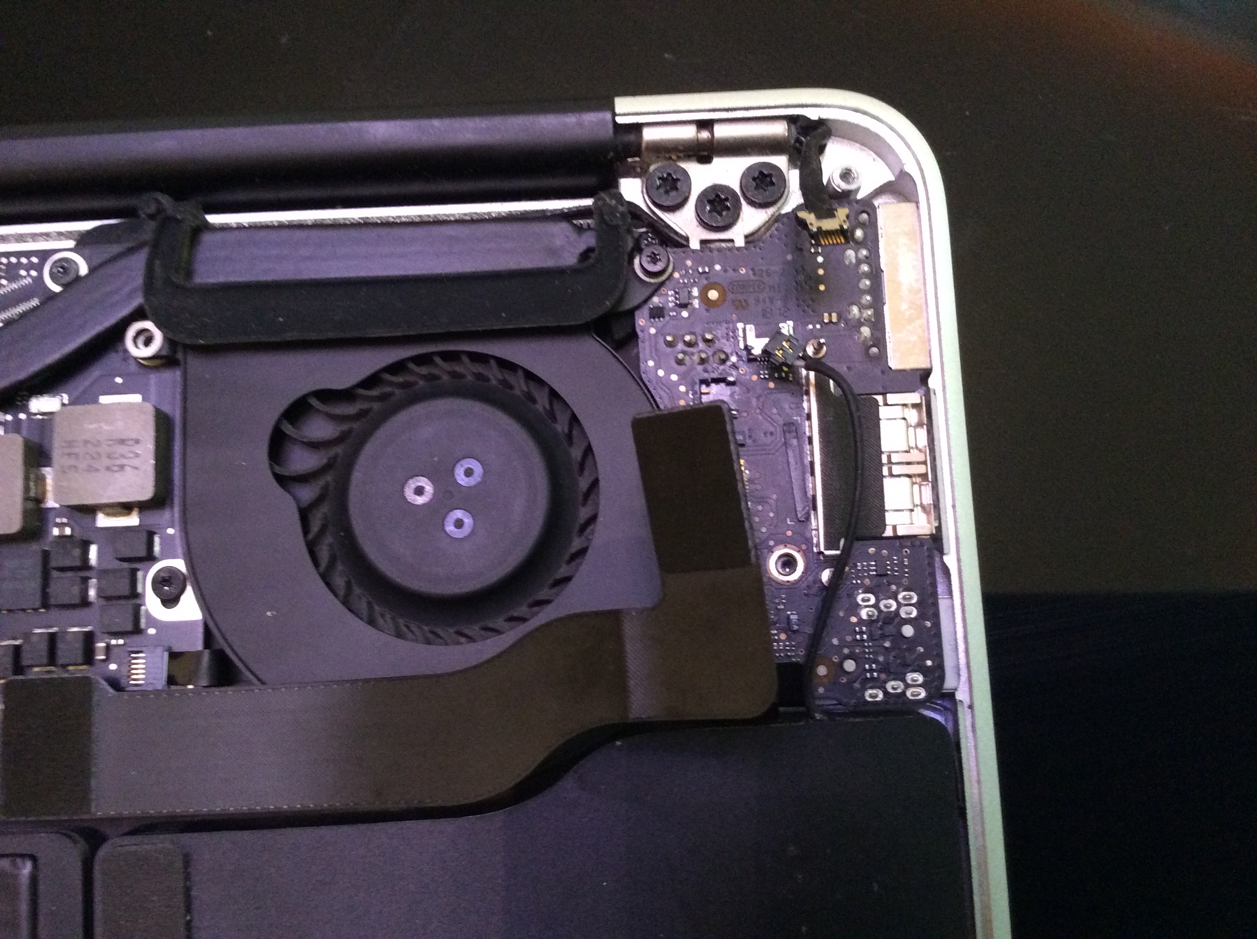

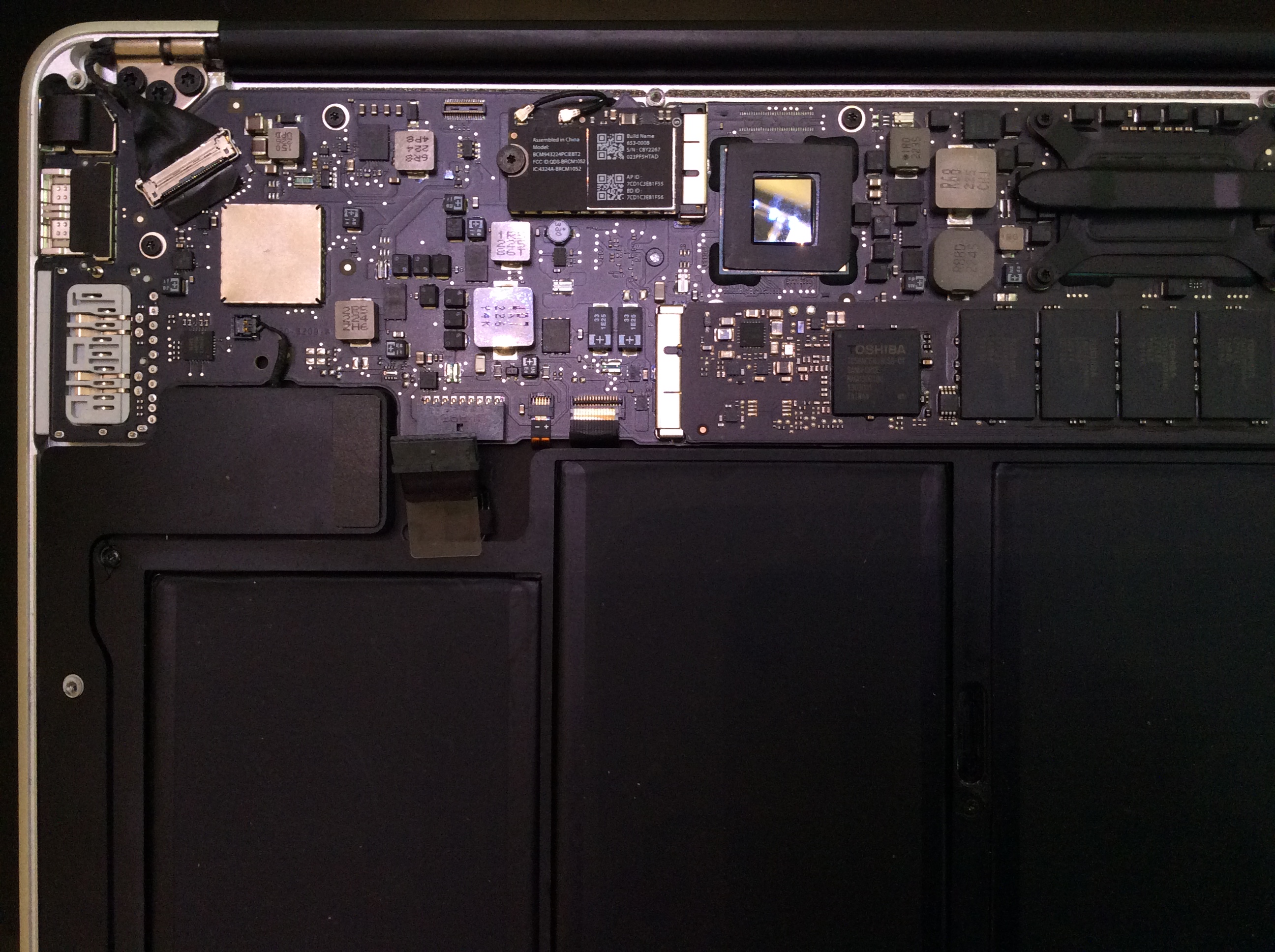

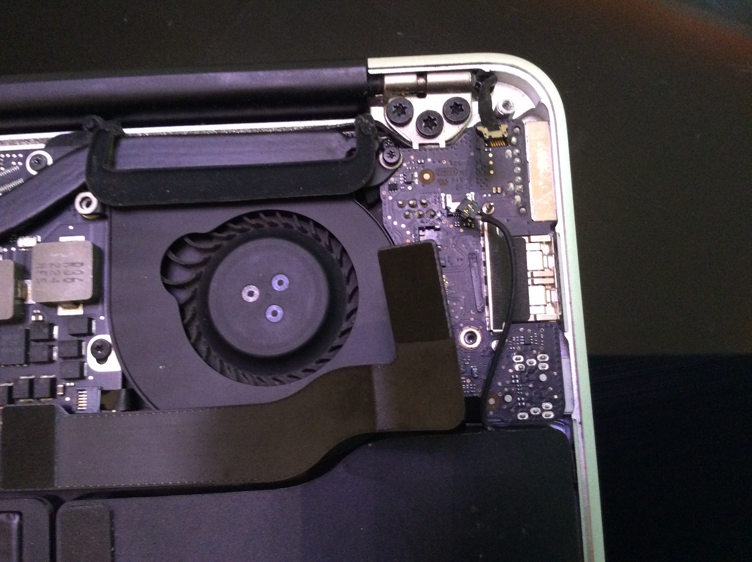

I cannot help opened my Mac just now, with a intelligent friend of mine who's learning micro chips, the plastic around the battery is so crispy that I did broke them...
Luckily we didn't break anything mainly. I learned electricity and electronics in college, but since I haven't use it for years...
I found the motherboard was safe and sound, nothing like a water spot. but the power board is full of white tints, so I did clean it(actually it's all dry) and tore out the keyboard and dry again, the back stickers almost ruined...
Then I power on to give a shot.
Not lucky! Cannot charging and the MagSafe light didn't work. When I push the power button the fan reached its max speed and at the hence the apple came out, Mac shut down itself.
Later, My friend used a voltage indicator and the power supply seemed to be fine. Harsh problem.
Later we disconnect ports from the main board and found out the keyboard was the black sheep, if it was disconnected, the MagSafe cord will work properly, and when it's plugged, it seems SMC has cut it down to protect the system.
Now I will buy a keyboard and try later, I actually messed the backlight of the original keyboard now.
But there is another problem, the fan is running crazy. I don't know if I change a new key and reset SMC as well as PR, what will happen to it.
Here are some pictures of the main board and the screw holes I broke...

You took classes in electronics before? Well, sorry to break it to you: just because the board 'looks' ok, does NOT mean that it is. And now that you broke it, there's almost NO chance of Apple helping you at all.
At this point, sell it for parts as you've basically destroyed it.:(

Thanks, I actually checked the votage and conductivity of the main board between some ports, turns out to be fine.

The keyboard itself is likely fine.
The keyboard & touch-pad USB controller mounted on the underside of the touch-pad is likely burned out.
Remove the touch-pad and look at the two chips on the underside.
One is for the keyboard, the other is the touch-pad.
I wager your magsafe I/O board is also bad, OR look very close at the flat ribbon cable to see if you see any leads within it burnt, you may need to replace both them parts, magsafe I/O board and the ribbon cable.
The touch-pad needs to be replaced with the right model year as they have changed the key layout and that is stored within those chips on the underside.
btw:
until you remove the logic-board, you are only seeing half the story
btw:
Disconnect the ONE narrow ribbon cable from the track-pad to the logic board.
Easy to disconnect at the logic board
If the controller board on the underside is bad, that will make your fan run full speed and use a bunch of cpu cycles making the machine run real slow.
