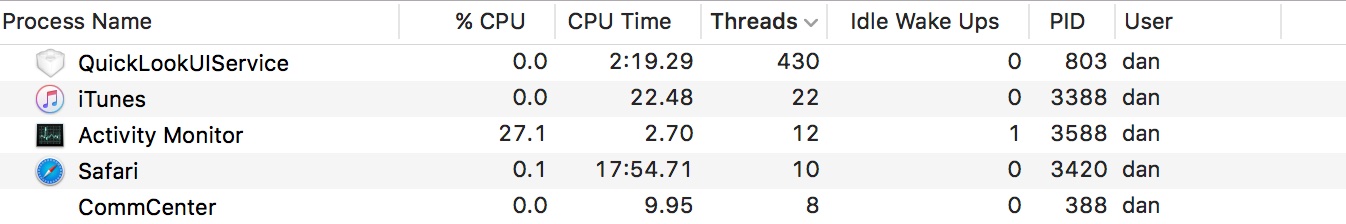

Plz help Ram Problem QuickLookUIservice Beta 10.13

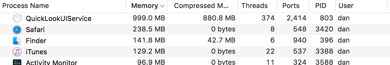

Plz can someone help I have the maxed out 2017 MacBook Pro and with the new high siiera beta 3 my ram keeps getting maxed out and this is the problem QuickLookUIservice is it safe to close it and it just keeps coming back, what is it and is it a beta problem cos it seems to be making my machine slow and eats so much ram up, look at the pics
many thanks

So, you had a few questions there...
1) Is it safe to close it? – Yes it is. However, in my experiences with the beta, it hasn't been responding properly to SIGTERM and I've had to send it SIGKILL (signal 9).
2) What is it? – So you know how when you select a file in the Finder and click the spacebar, you then get a preview of the file? That's what this process gives.
3) Is it a beta problem? – From what I've seen, QuickLook does seem to misbehave a bit throughout the High Sierra betas. In my case, what I've experienced, is that it unnecessarily hangs attached devices.
And something you didn't ask, but I want to comment on
4) – Whilst it's definitely more RAM usage than it should be, it really doesn't seem like that much in the grand scheme of things. From your photo it's using less than 2 gigs. On a 16 gigs machine that isn't hosing a VM or doing RAM intensive tasks that should be no sweat at all. As long as your RAM usage is less than 100% it doesn't matter how much is being used in terms of speed. Well, aside from the fact that the more active memory is in place, less can be used for intelligent caching.
How does Memory Pressure look in Activity Monitor? If it isn't near the top in the red, I wouldn't worry about RAM.

thanks for this, yeah sometimes it stays small like the photo then if I'm using vlc etc it can go all the way up and my clean my Mac 3 says ram is used up and it uses about 10gig, it seems to be running in the background for a while like 3 hours etc.

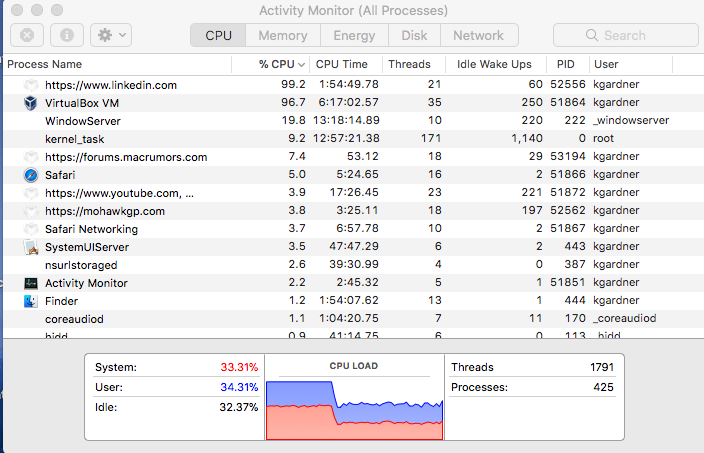

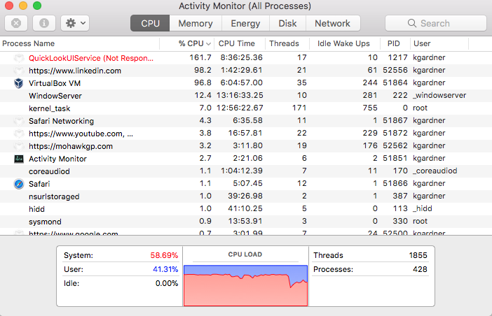

We're now quite past the High Sierra betas and these kinds of problems are persisting. I'm focused particularly on your #4 here; saying the 2 GB should be no problem on a machine not hosting a VM or doing RAM-intensive tasks is great, but I am hosting a VM and doing RAM-intensive tasks (well, nowadays everything seems RAM-intensive, as others have pointed out). For me though the problem is not always just the memory hogging, but the processor. My system was bogging down horribly and it's usually the VM when in sleep mode, but this time Activity Monitor showed QuickLookUIService was using 275% of CPU resources!
I'm not sure what triggered it but it then went to red "not responding" status, dropped to a mere 160%, and I had to force quit. Immediately upon doing so VirtualBox VM and linkedin (for some reason!) rushed in to fill the void, each showing 95-99% CPU usage, although the chart at the bottom dropped from being pegged at the line, down to about half way.
None of this is a big deal if it's still leaving clearance to proceed with the work, but I literally have to
[FONT=Verdana, Arial, sans-serif]stop working and wait for things to respond in order to do anything, at least a couple times a day it seems, all since High Sierra. Currently 10.13.2. I dannae is she can take any more, Captain!
[FONT=Verdana, Arial, sans-serif]stop working and wait for things to respond in order to do anything, at least a couple times a day it seems, all since High Sierra. Currently 10.13.2. I dannae is she can take any more, Captain! View attachment 749291 View attachment 749290 [/FONT]
Sorry, made, but I have no issues with High Sierra on either of my systems, so i cannot truthfully complain about these issues, as to me there have been no issues. i will acknowledge that you still have problems, but since HS has worked as well as Sierra for me, well, a tad better in fact, I can't say HS is riddled with issues like you make it seem. It obviously has issues since you're having these problems, but they don't manifest themselves for all
