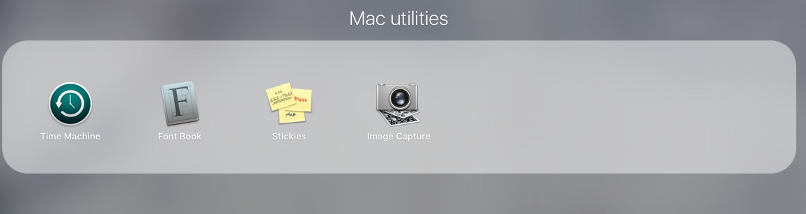

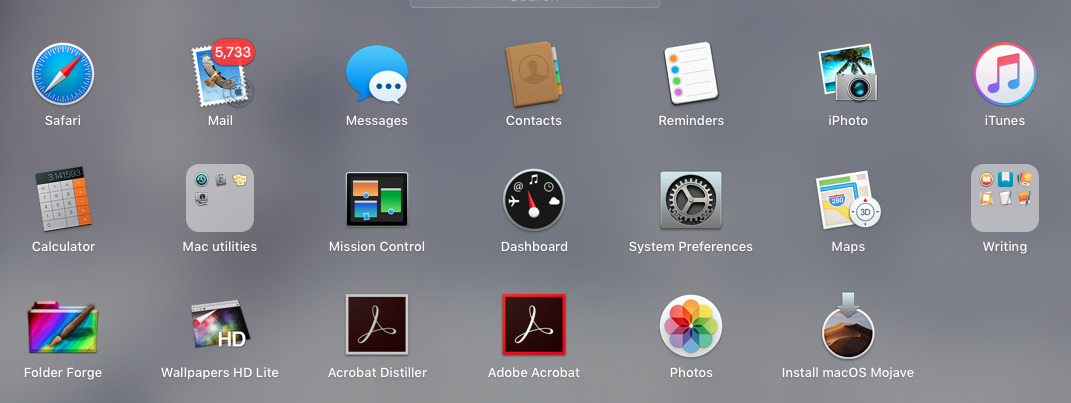

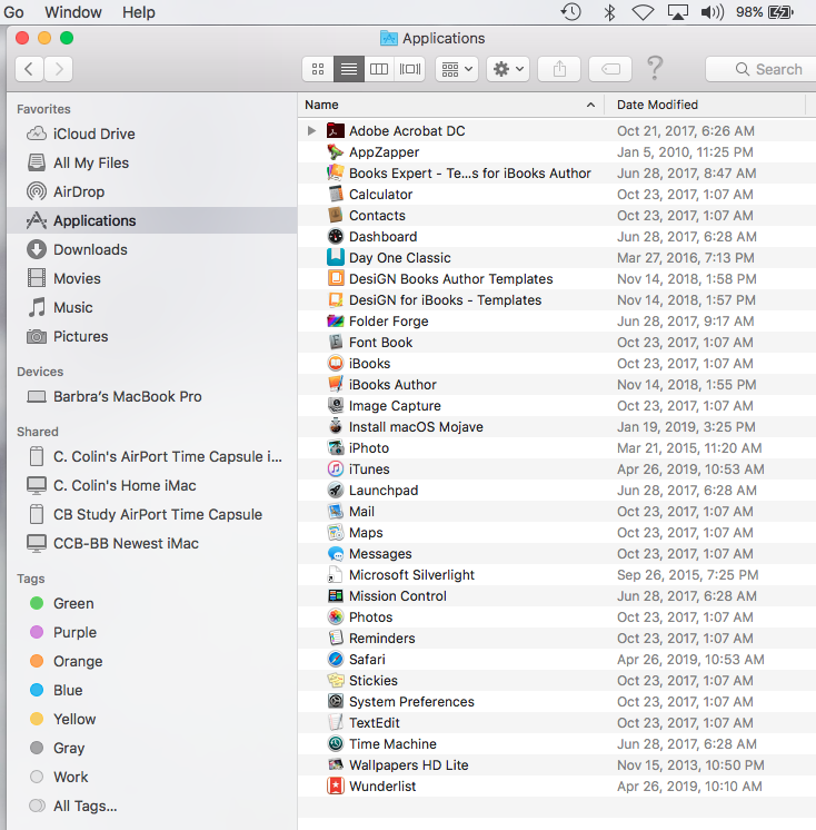

    1. I attached screenshots of
      1. the FULL list of applications;
      2. all applications showing when selecting Launchpad
      3. inner folder of Mac Utilities from Launchpad

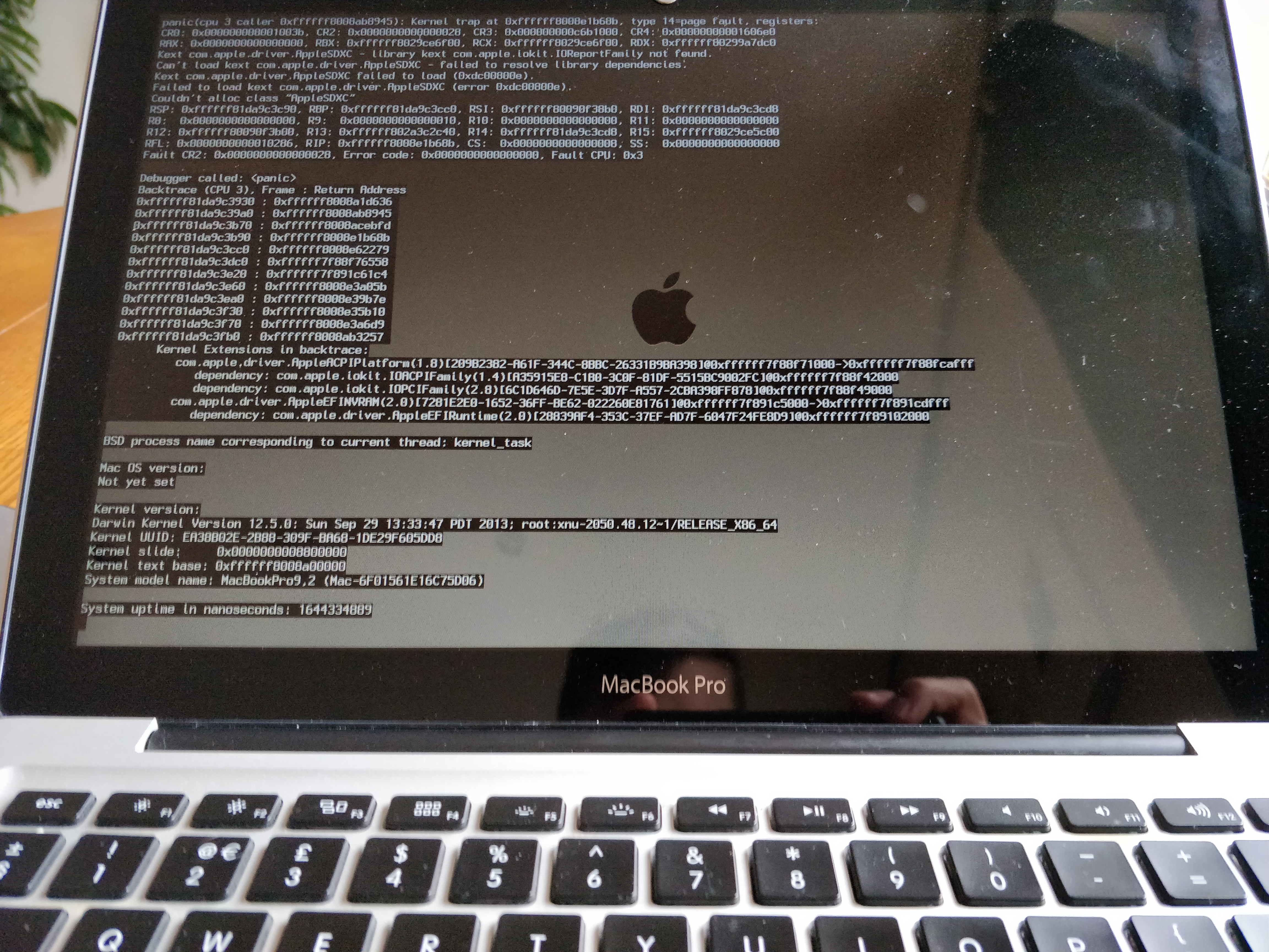

[doublepost=1557666896][/doublepost]UPDATE: Posting this brought up a list of similar threads.
One had posted a screenshot that I had forgotten had occurred in this week-long event.
I copied it here as I had a similar looking screen the first time or two I attempted the restore from Time Machine and then it rebooted. It never came up again after that. I added this in case that triggers any other ideas on this problem.
(last attached screenshot is NOT from my MBP but from the other post)

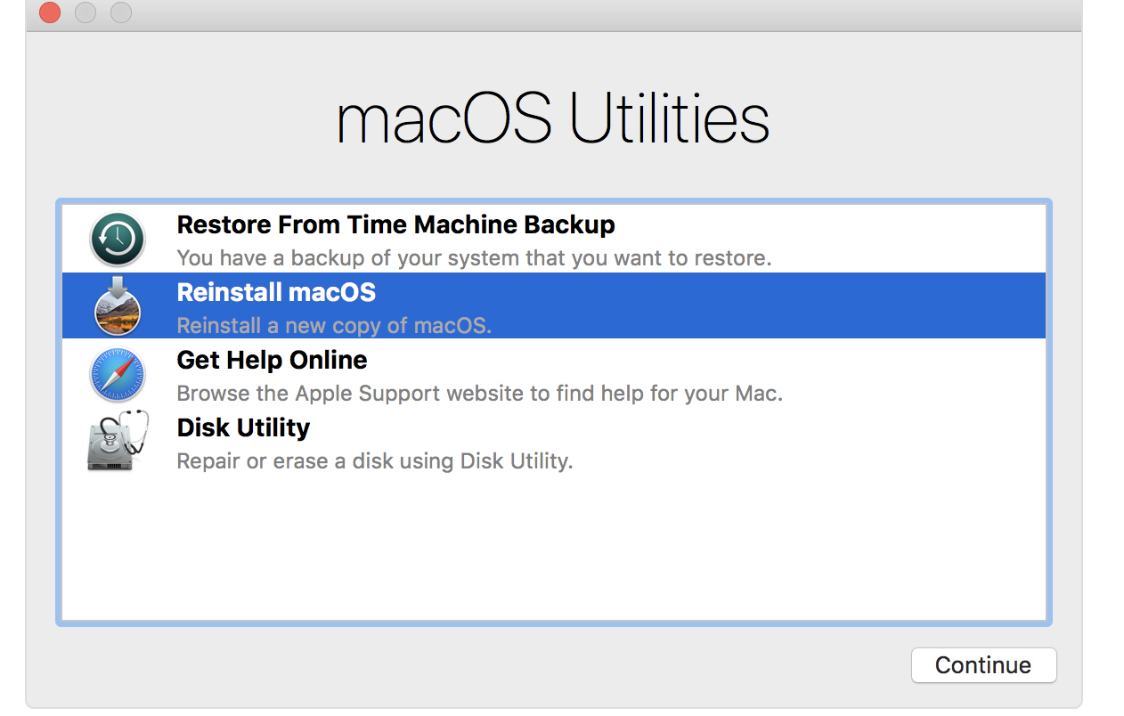

I just restored from the opening screen following a Command-R startup. (attached)

ADDENDUM. If you have a screen similar to the last screenshot you posted which you say somebody else posted - this actually looks like it could be a HDD cable problem.
