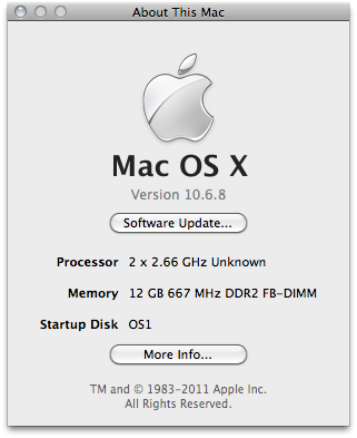

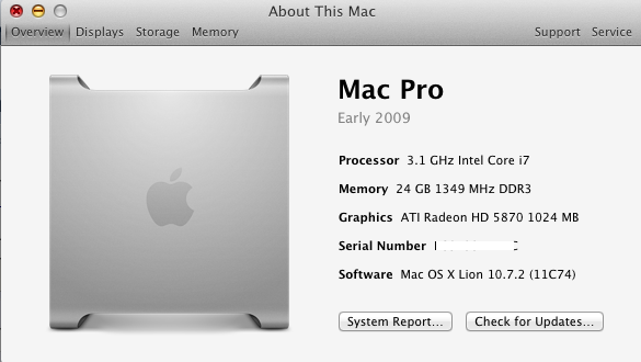

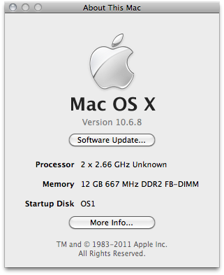

    All you folks who have upgraded your MacPros to some "non-standard" config, how bout posting your "About This Mac"...
    I'll start with my 1,1...

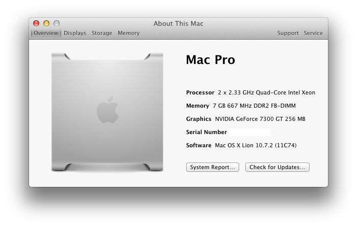

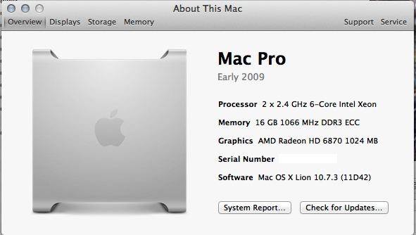

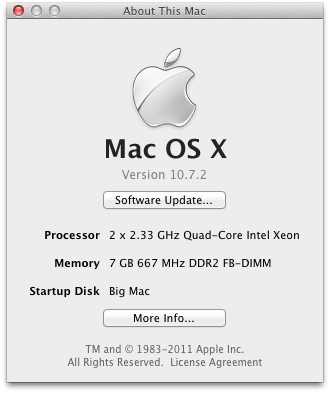

    A little while ago I Frankensteined my quad core 1,1 Mac Pro into an octo core. Scary stuff (at least for me) but worked out well. I wrote about the experience on my blog: http://bartkowalski.com/2010/11/octocore/
    I'm itching for a new Mac Pro as are many others. I've been *this* close to pulling the trigger on a hex 3.33 over the last few months. I keep telling myself the update is coming, the update is coming…

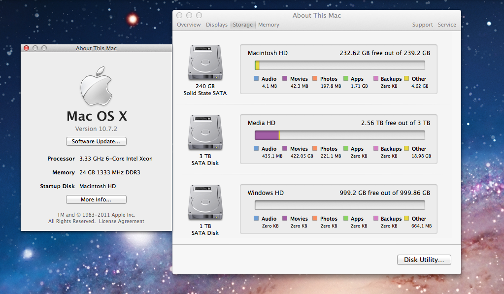

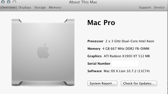

    I got the 2010 Mac Pro (hex model with 6 GBs of RAM)
    Since then I have added a 3 TB HD, 240 GB OWC SSD, and removed the 6 GBs of RAM and put in 3 x 8 GBs of ECC RAM.

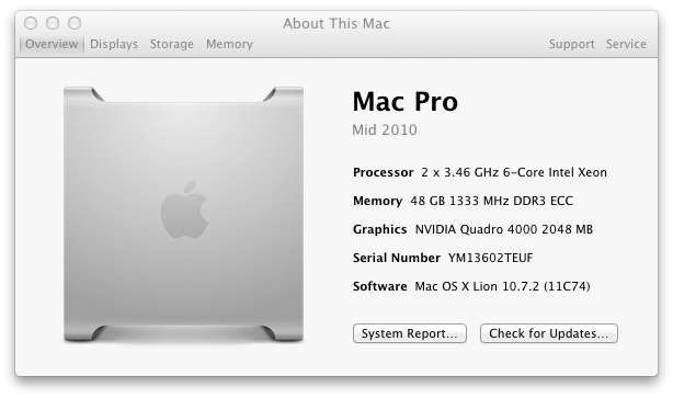

    Upgraded from 1,1 2x2.0GHz dual core to x5355's with 2,1 firmware

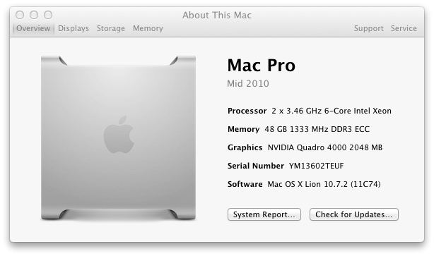

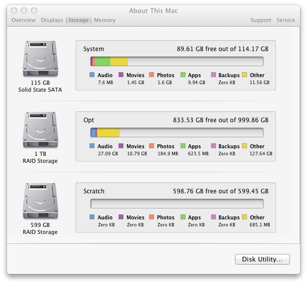

    #8

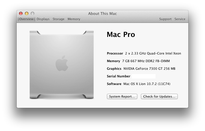

    I posted this in another thread, but my 2010 was originally a 2 x 2.4GHz e5620 and was upgraded to a 2 x 3.46GHz x5690 system.

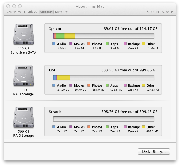

    For storage, I have 5 drives in the machine. One SSD in the 5.25" bay under the BD-ROM drive, 2 1TB 7200RPM drives mirrored together in drive bays 1 and 2, and 2 300GB 10000RPM drives striped together in drive bays 3 and 4.
    jas

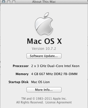

    My Mac Pro 1.1 2006
    How or what CPU upgrade can I do with my Mac Pro. Any ideas will greatly appreciated. !!!!!! I really think that this a steal for $550.00 just as is, and I would like to know what possibilities I have as far as upgrading it.
