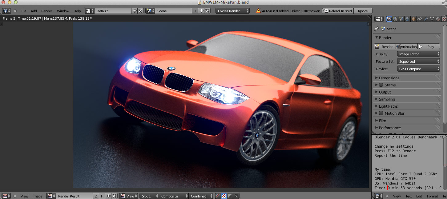

I can post tests of 7950, 7970 and GTX 680 4GB later this day, if you're interested. I have only demo of Octane, so maybe Blender Cycles will do instead? Stay tuned.
Edit: due to attchments limit, updated this post with GTX 680 Blender 2.69 Cycles result.

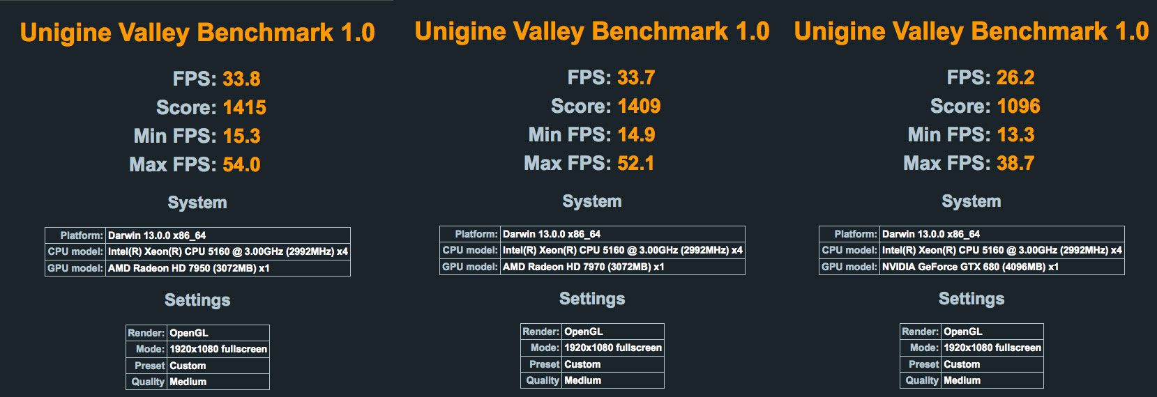

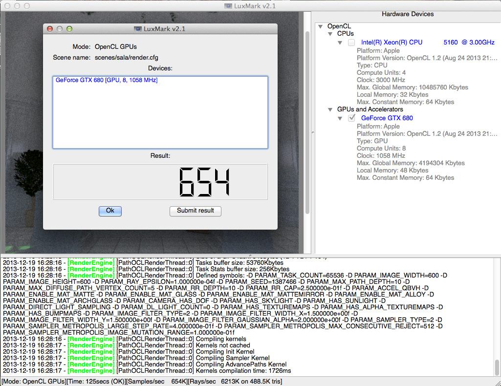

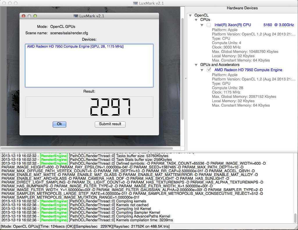

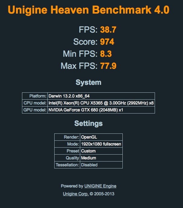

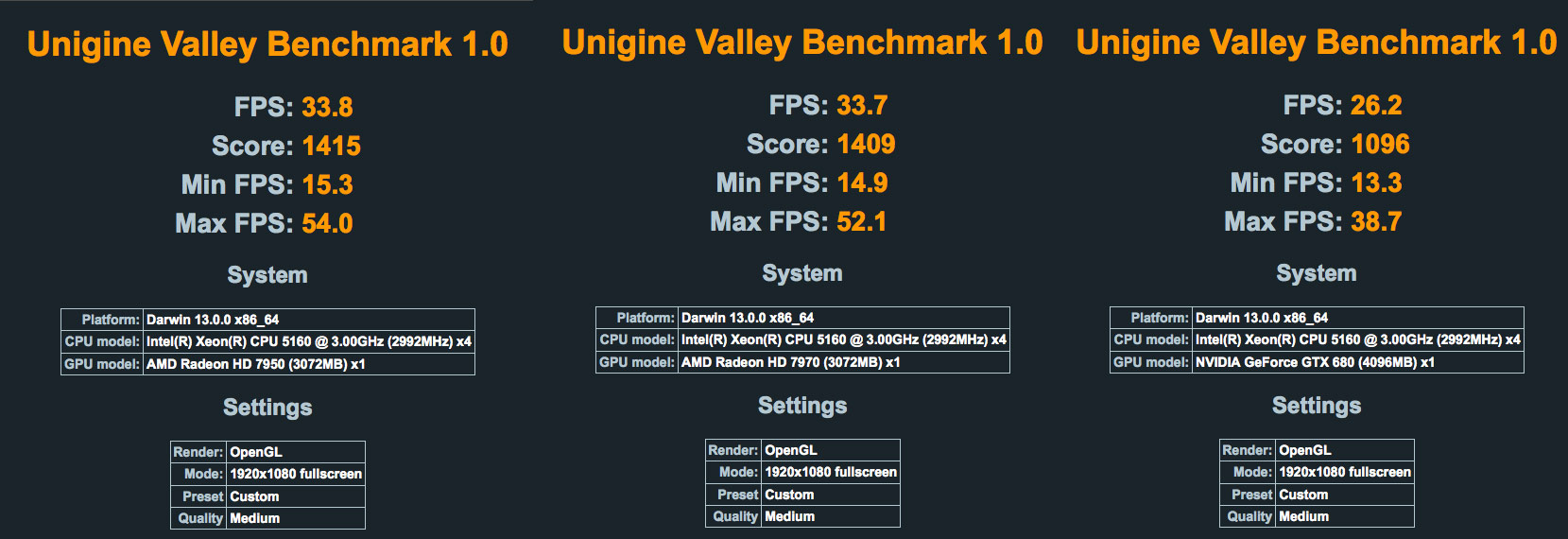

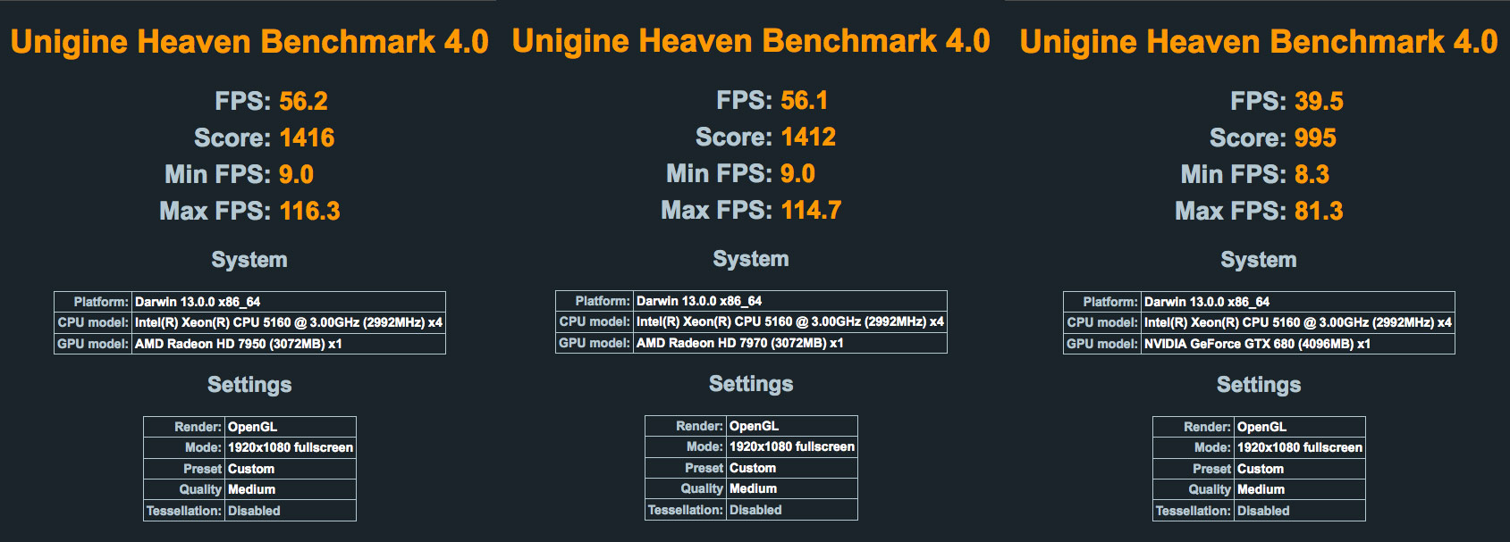

Here you go. GTX 680 was the worst performer of these three.
7950 and 7970 are overclocked (7950 much higher, hence scores very close to 7970), 680 runs at stock clocks.
Heaven and Valley are in some % CPU dependent, so results aren't very clear.
Luxmark showed PCIe bandwidth limit penalty more accurately IMO (I got about 10% higher scores in 5,1).

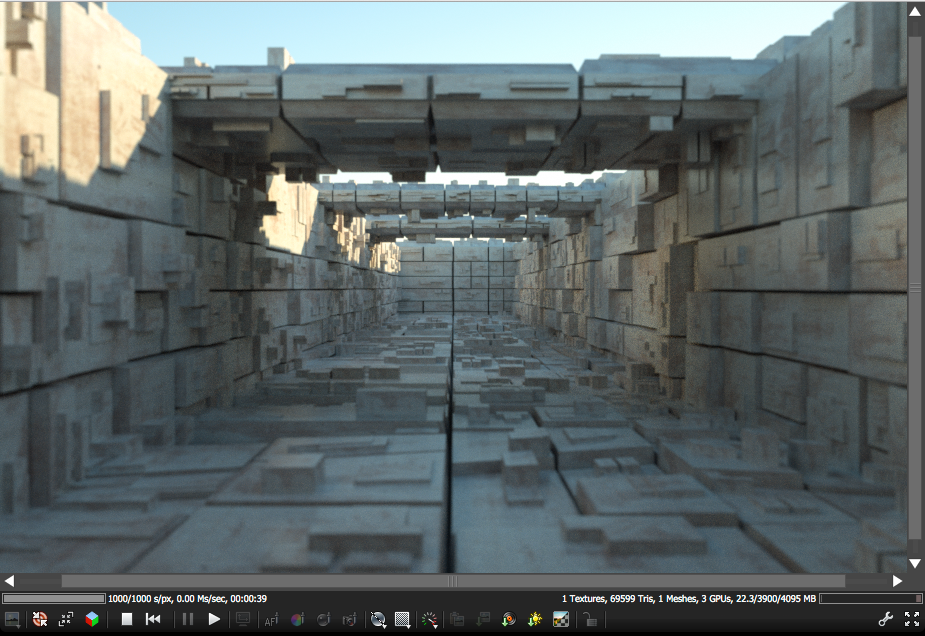

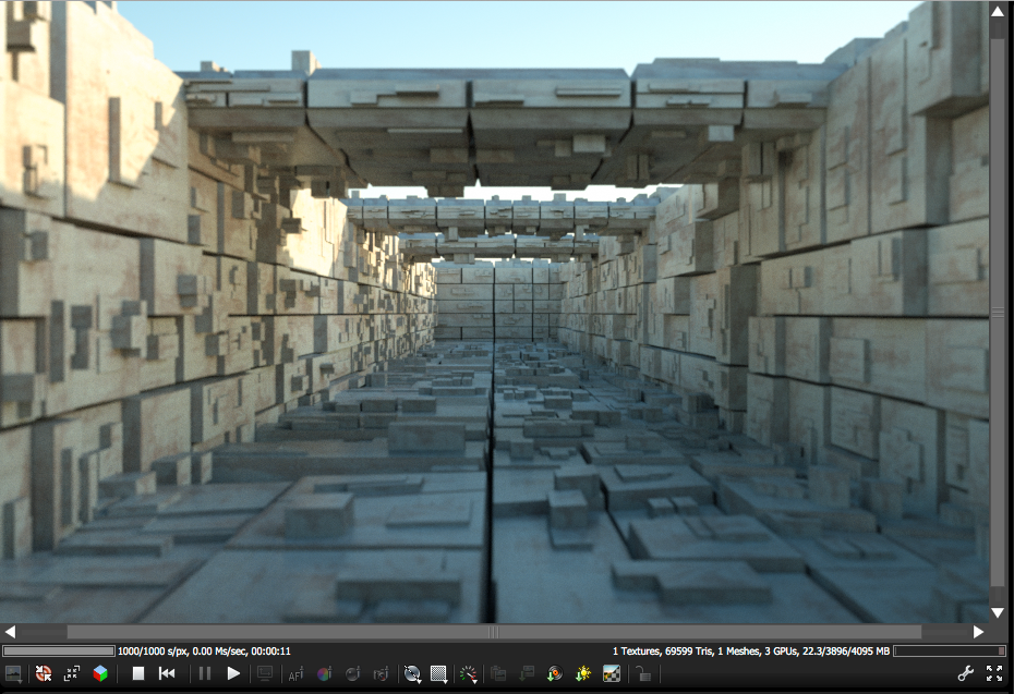

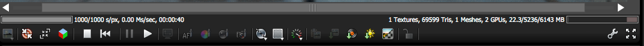

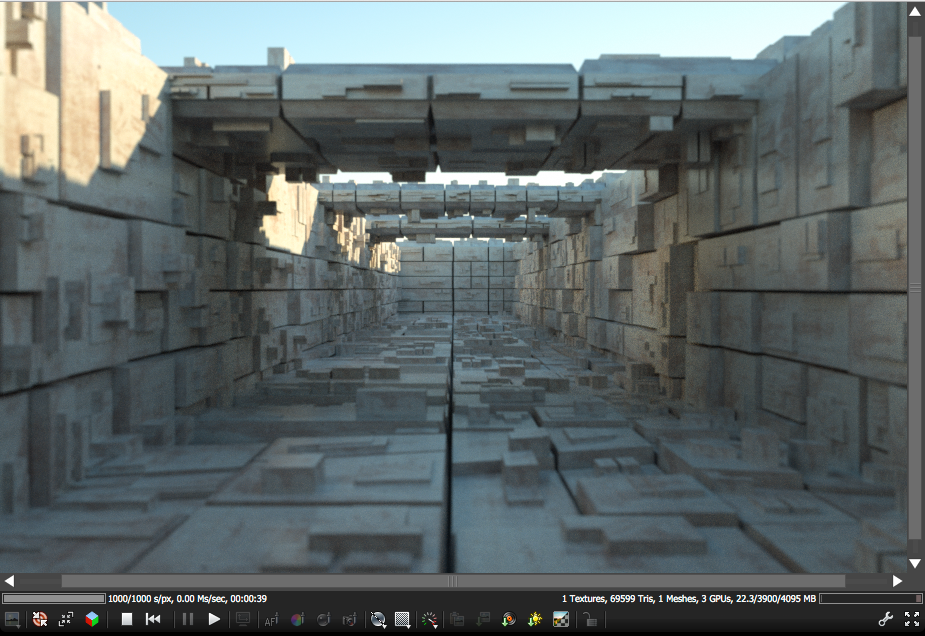

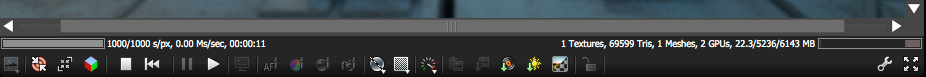

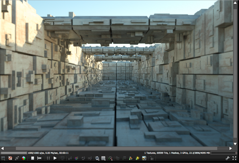

Here they are for a 2007 Mac Pro 2,1 with 2 early EVGA GTX Titans/6g SC (GK110A) plus an EVGA GT640/4g: The first one using OctaneRender's RenderTarget DL (11 sec.) and the second using OctaneRender's RenderTarget PT (39 sec) (which was used in Barefeats test - http://www.barefeats.com/gputitan.html - where the one Titan that he used rendered the scene in 95 sec. OctaneRender linearly leverages like GPUs, so two of the Titans used by Barefeats would have rendered that scene in 47.5 sec. The GT640, that I use mainly for making interactivity smooth in scene building and tweaking, didn't appreciably affect the scores: it improved the PT render by 1 sec., but did nothing to improve the DL render (see two small pics below.); thus, the scores with only two Titans are - RenderTarget DL (11 sec.) & OctaneRender's RenderTarget PT (40 sec). So one of my Titan SCc (Super Clocked) would render the scene in 80 sec. using RenderTarget PT.

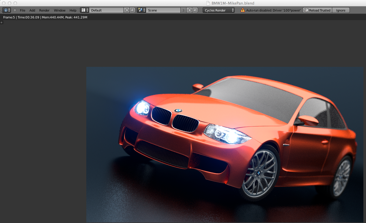

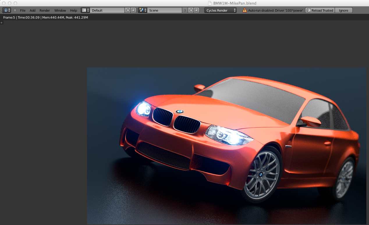

Here is one (36.09 sec.) for a 2007 Mac Pro 2,1 with 2 early EVGA GTX Titans/6g (GK110A) plus an EVGA GT640/4g: Using Mike Pans' BMW BenchMark Scene.

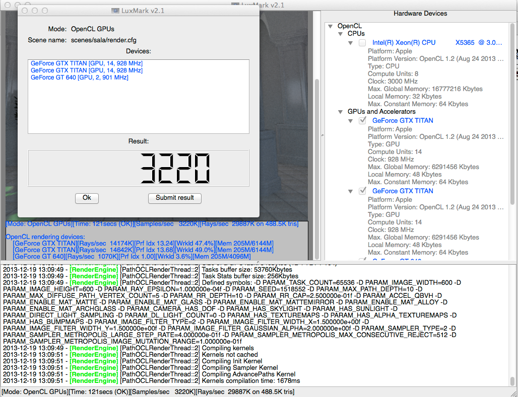

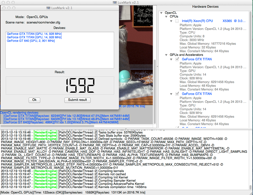

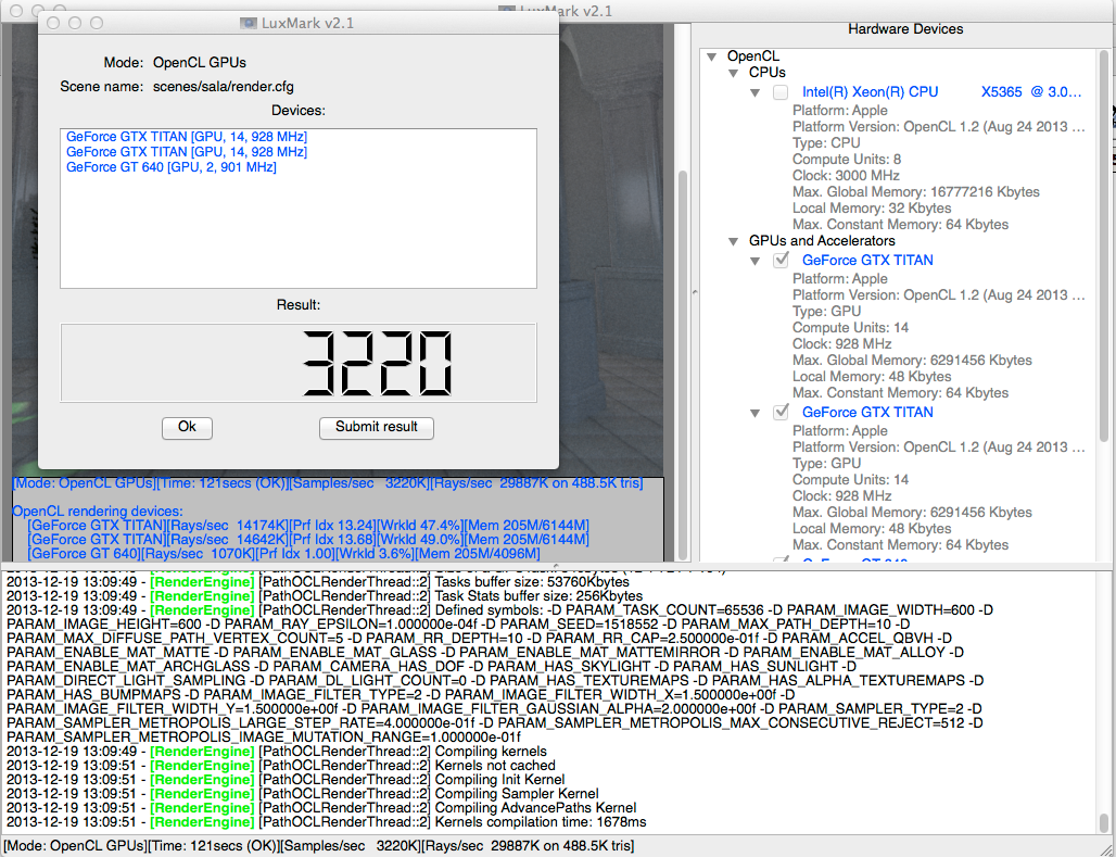

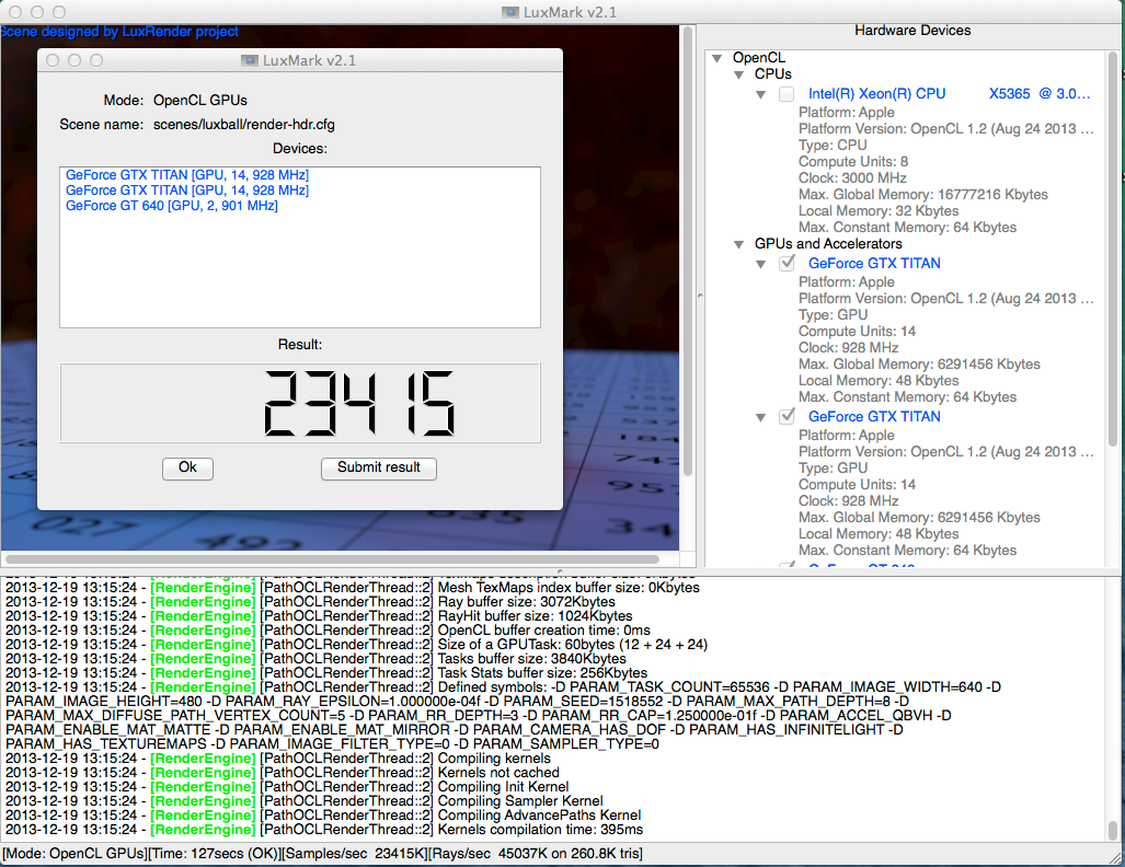

Here're three for a 2007 Mac Pro 2,1 with 2 early EVGA GTX Titans/6g (GK110A) plus an EVGA GT640/4g: Using LuxMark's three benchmarks: 1) LuxBall (23,415); 2) Room (1,592); and 3) Sala (3,220).

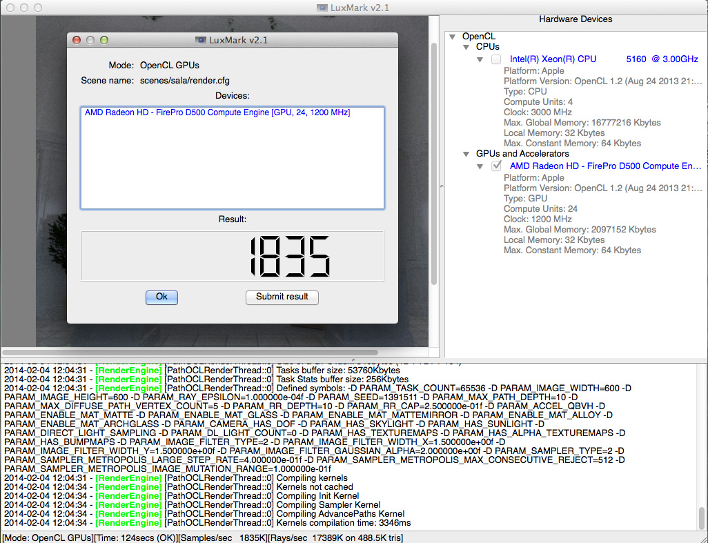

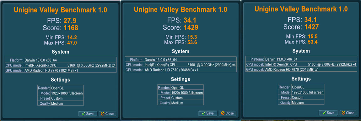

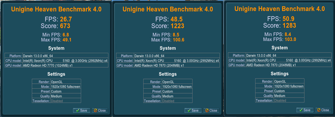

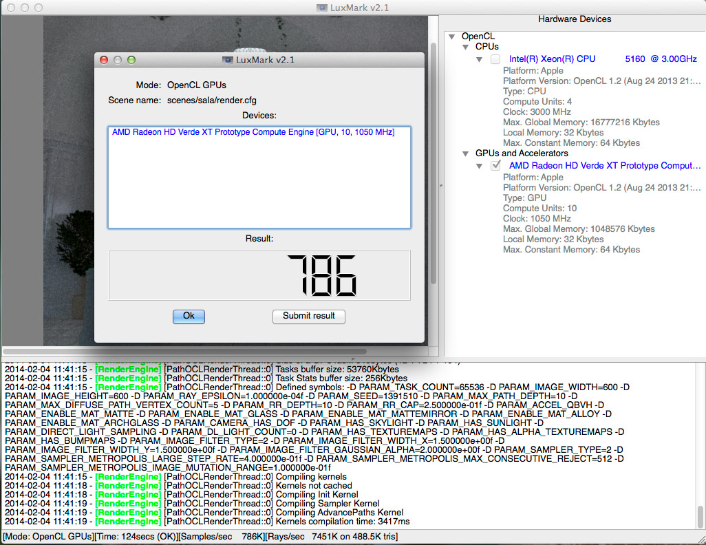

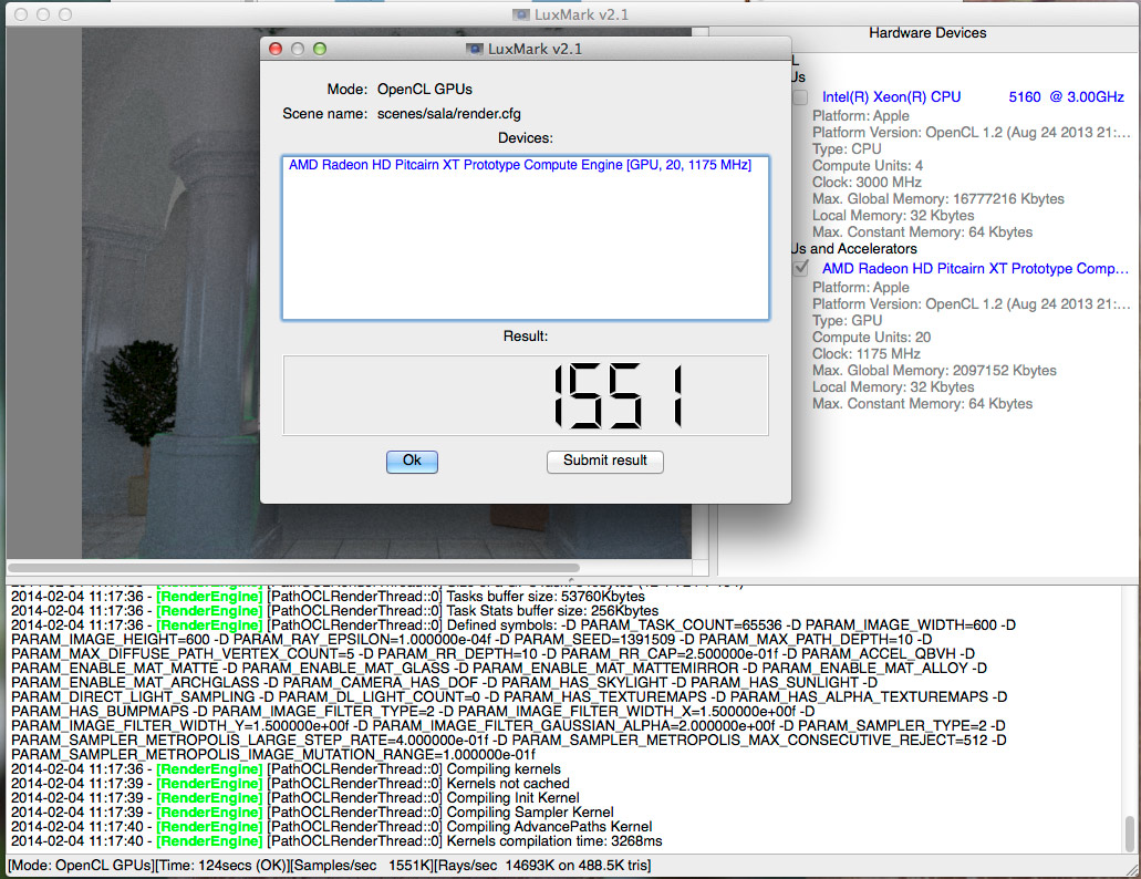

Some more...
This time few AMD 7xxx series cards, in following AMD 7770 1GB, 7870 2GB (Pitcairn), 7870XT (Tahiti LE). 7870XT still as D500 (10.9.1). All overclocked a bit. 7870s work with digital bootscreens, 7770 only with analog (DVI->VGA adapter needed).
As you can see, both Unigine benchmarks are CPU bound.
thx for your contribution, it is clear that the open Gl is cpu limited, the border is between the 5770 and 5870 as bare feats showed. It depends the game engine also probably but we have our answer. For open cl, no limitations, could be used for FPX probably as fast as the newMP ! keep going, some FPX test would be nice !

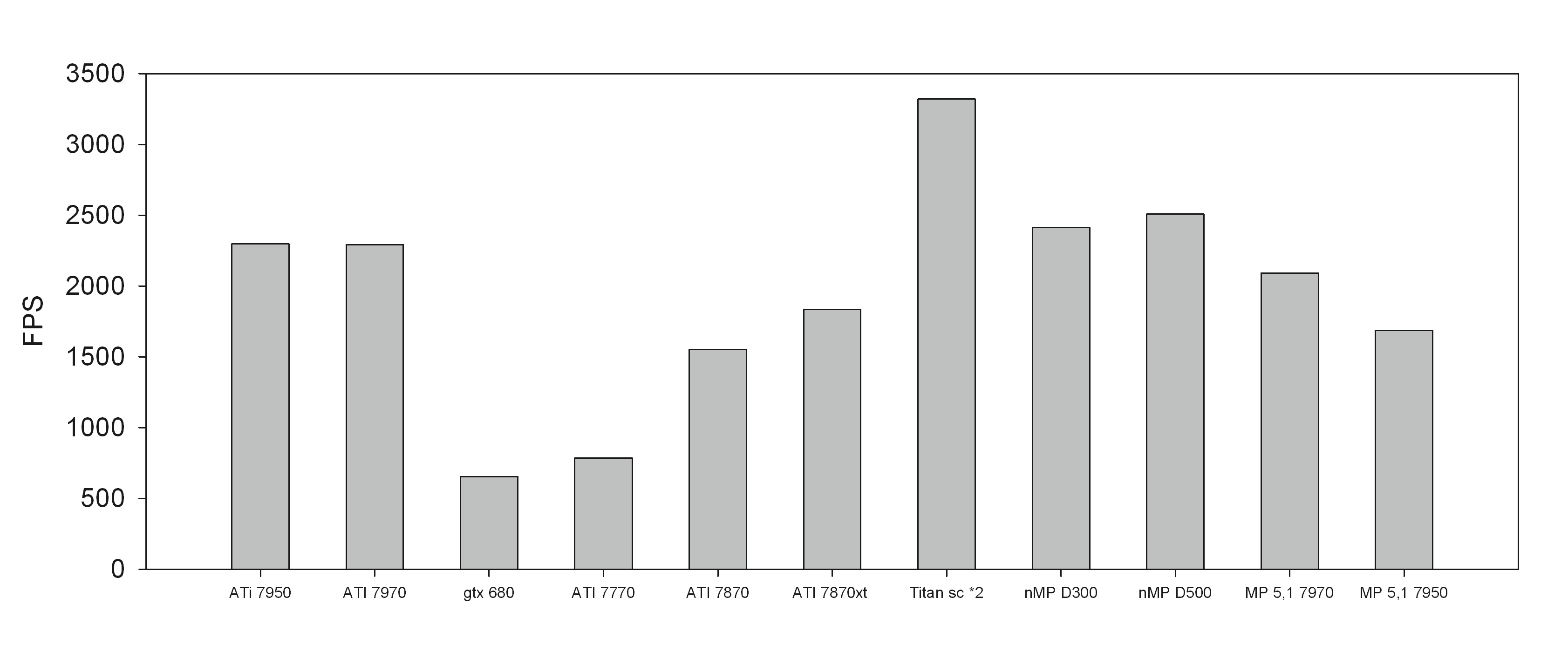

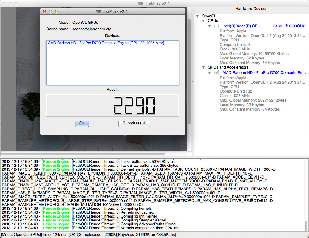

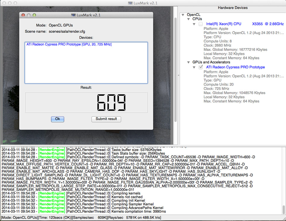

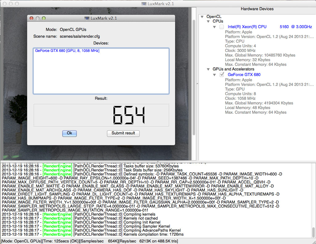

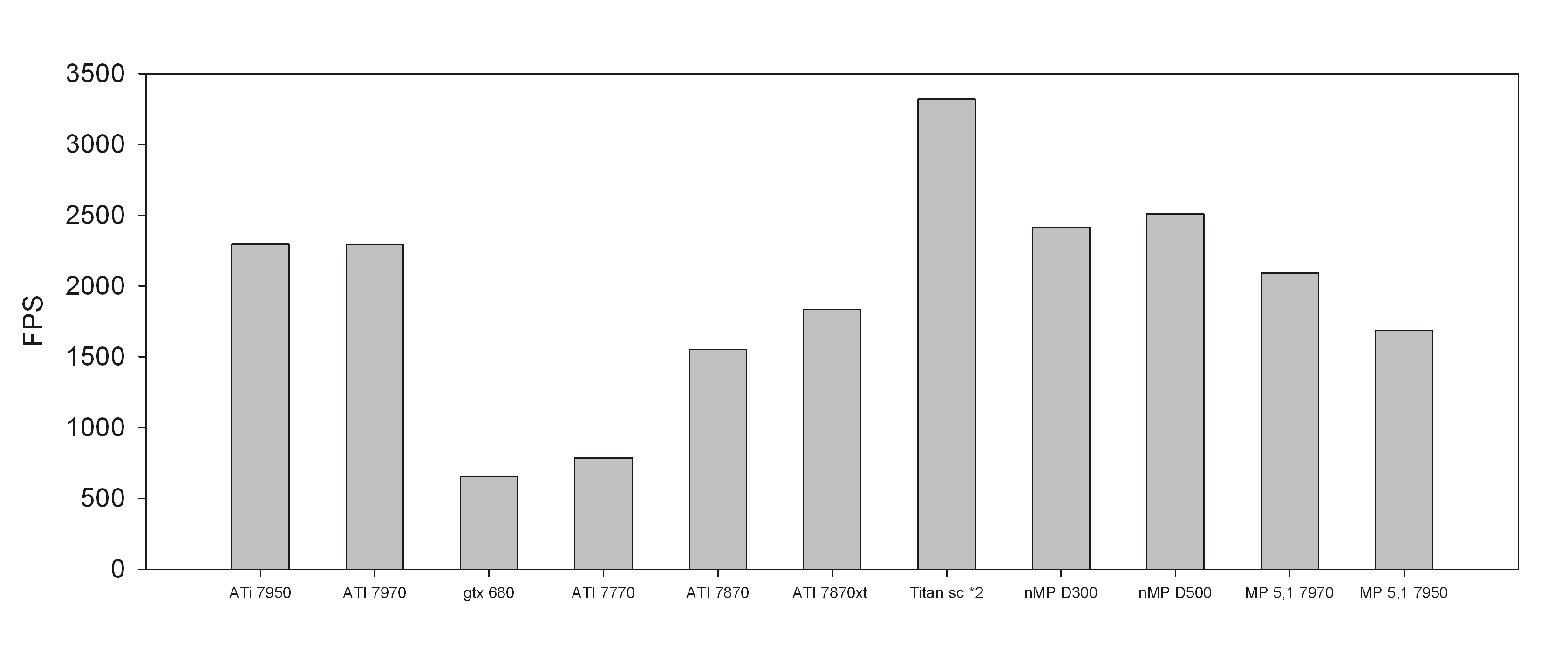

I plot a chart of different open CL results :
Mac pro 1,1 from blacksheep and tutor
and nMP and 5,1 MP from bare feats
The 1,1 MP is almost fast as the nMP with dual GPU ! and beat the 5,1 with single GPU ! Rominator has see similar result on netkas with a 7950 ! http://forum.netkas.org/index.php/topic,8206.15.html

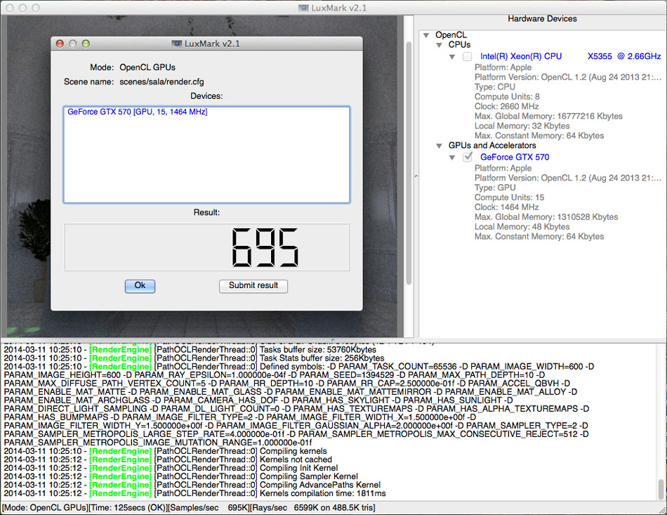

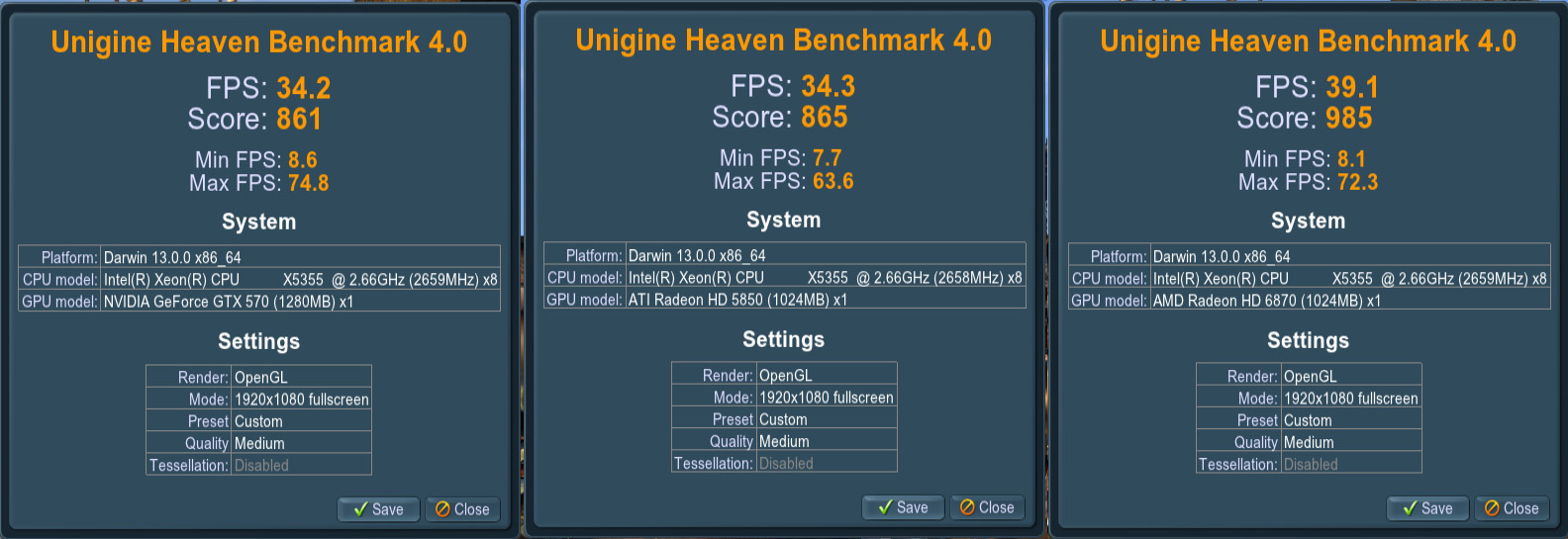

...and another portion...

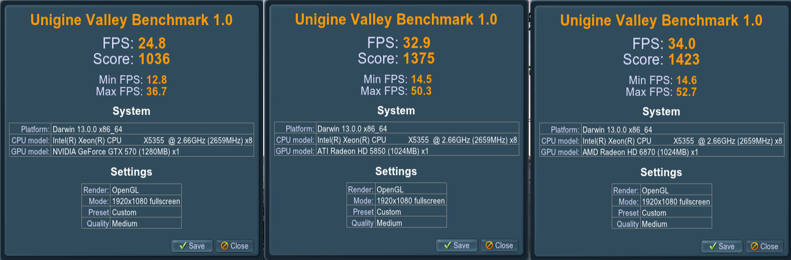

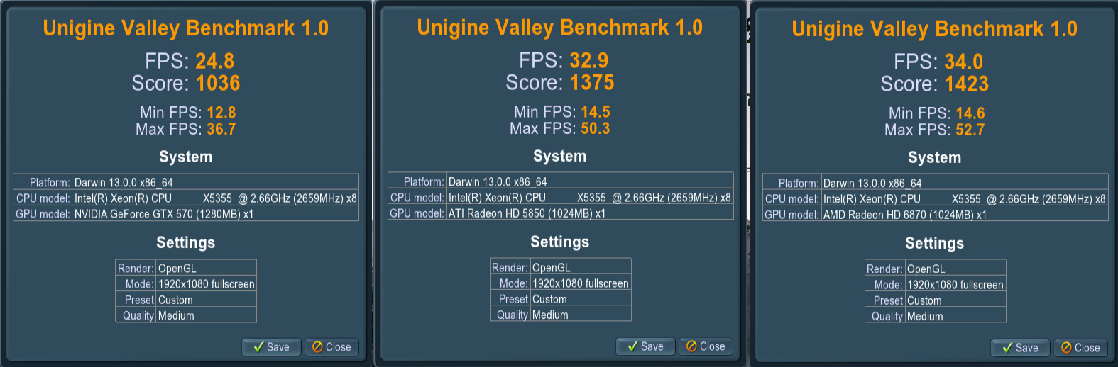

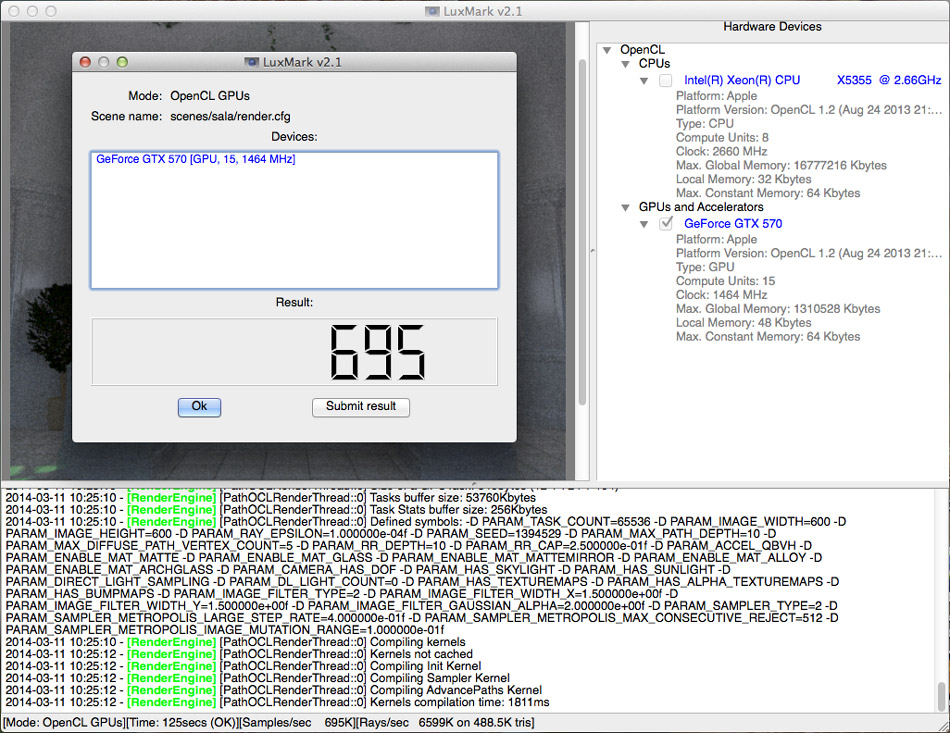

This time AMD 5850, 6870 and Nvidia GTX 570.
I put a pair 5355s instead of 5160s, so Heaven and Valley scores are ~10% lower than they would be with 3.0 GHz. Used stock OS X drivers for Geforce.
6870 is pretty well OC'ed (as for 6870): 970/4800 MHz vs stock 900/4200.
Due to attachments limit, FCP X BruceX benchmark and Blender Cycles benchmark of GTX 570 in next post.

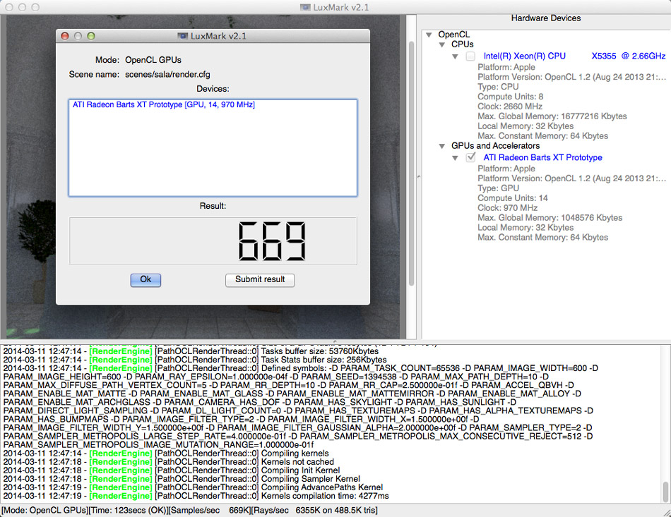

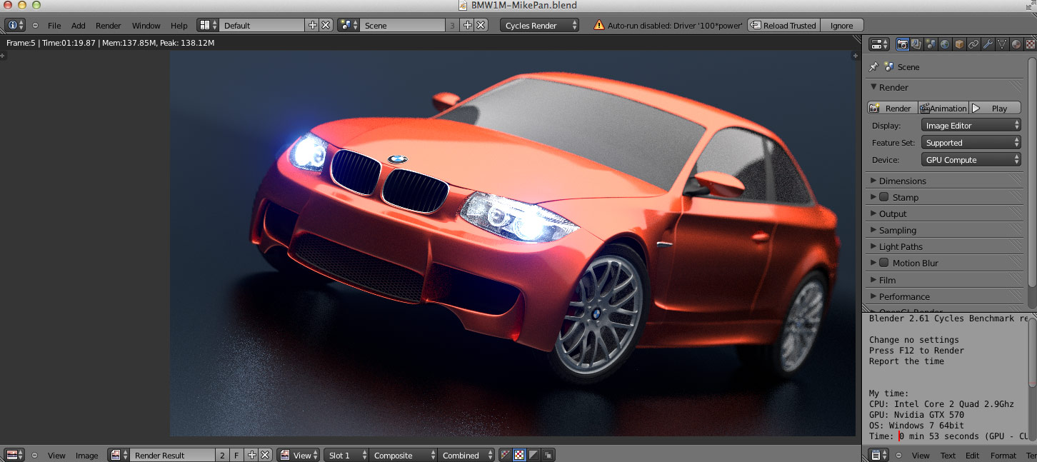

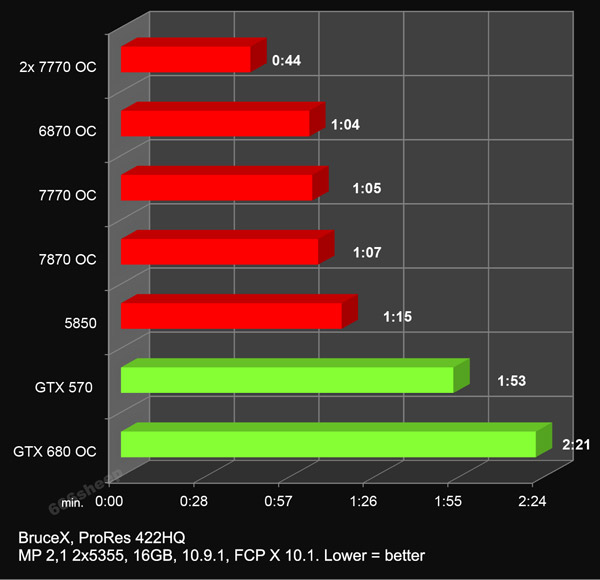

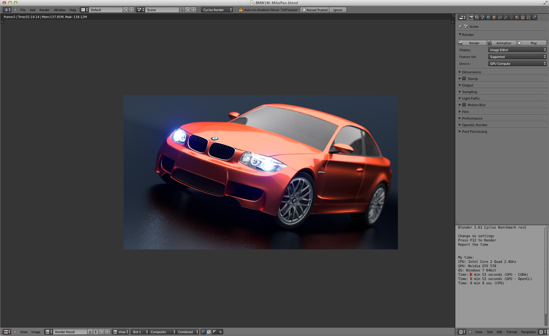

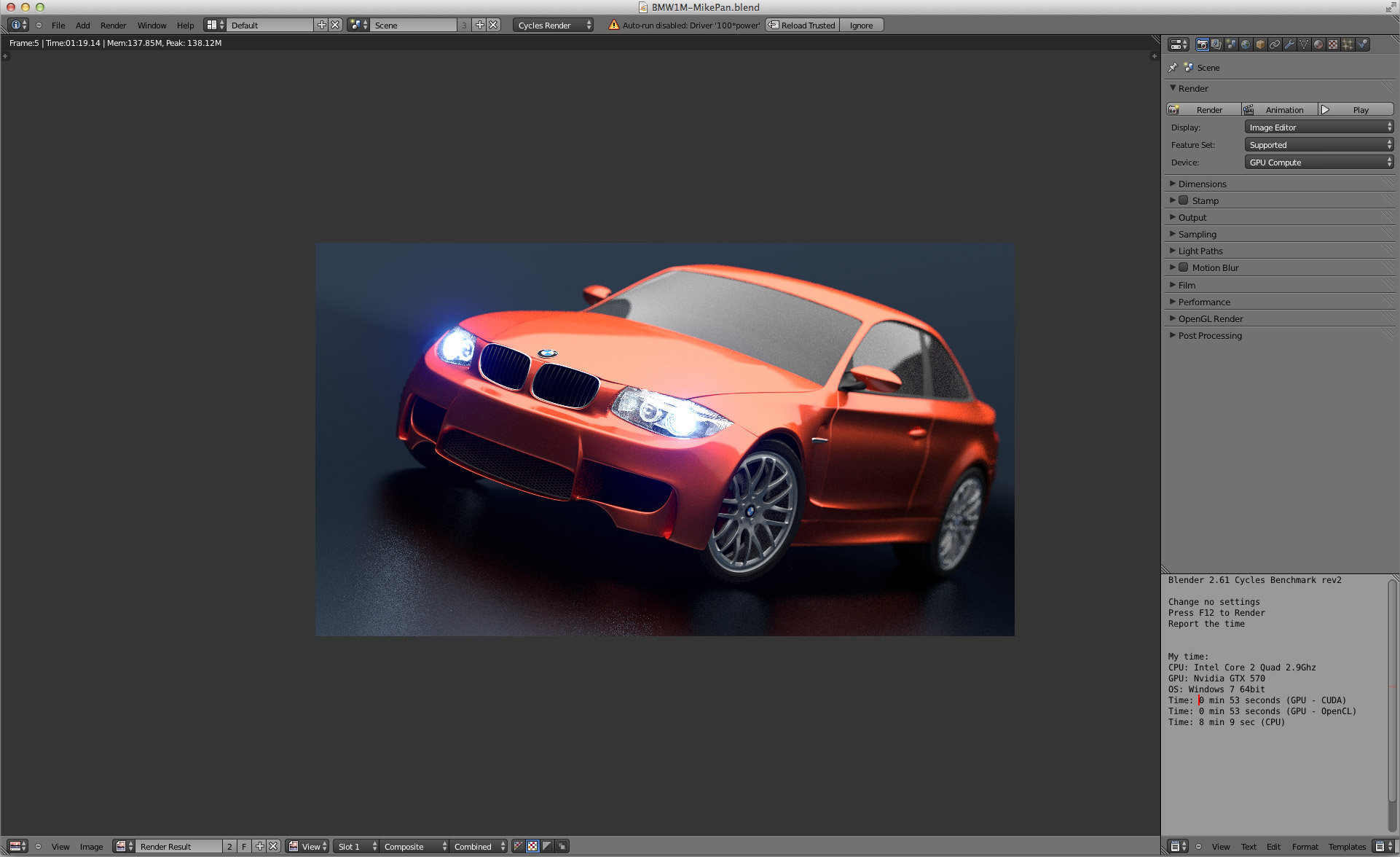

...and FCP X 10.1
Blender Cycles on GTX 570 performed well, even a bit better than 4GB GTX 680.
I didn't include my latest OC'ed 7950 in BruceX graph, because it overloaded PSU in my 2006 during this test (tried twice). Gotta lower the TDP of 7950 for 2006 :D. 2009 handles this 225W+ card very well.
Performance of 7870 2GB (Pitcairn) is a bit disappointing.

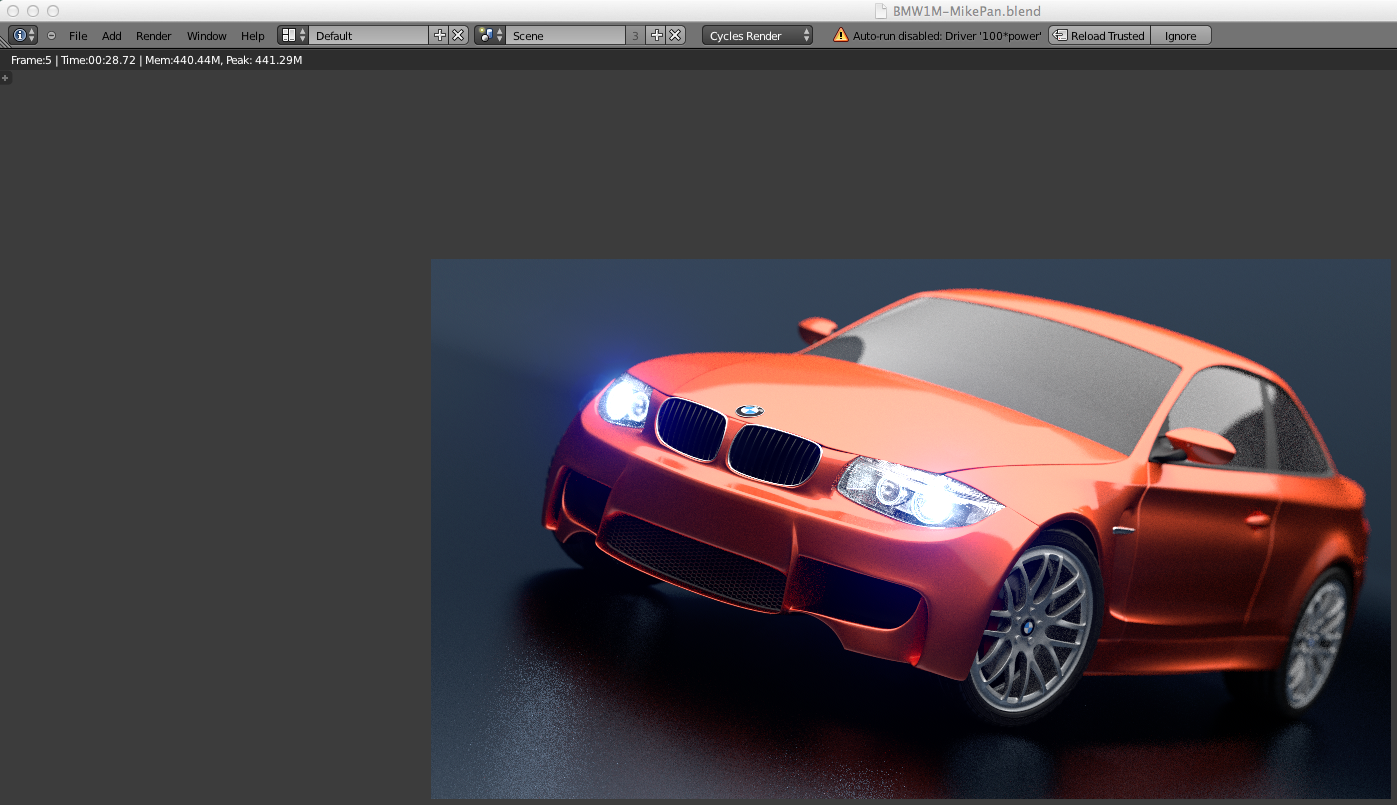

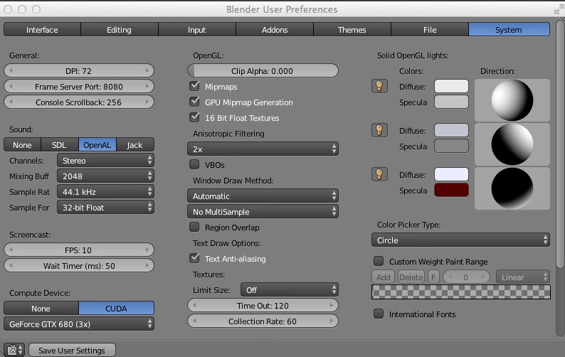

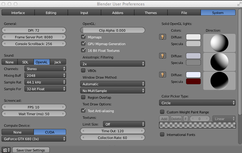

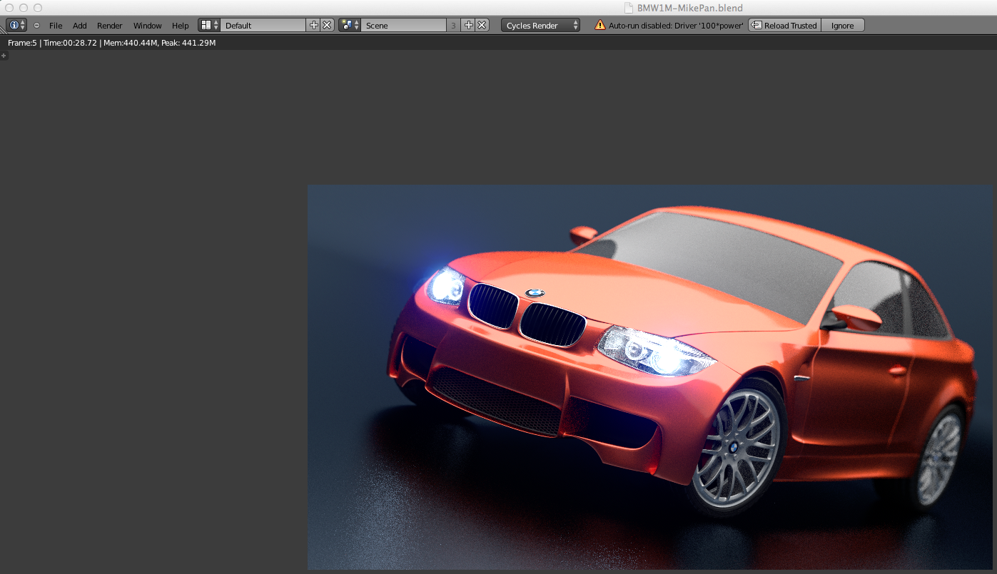

28.72 Seconds for Mike Pan's BMW and 56 seconds for Octane Render Benchmark on Mac Pro 2007 with 3 GTX 680s for CUDA support.
  • MikePanBMWonMacPro2007w:3GTX680oc.png

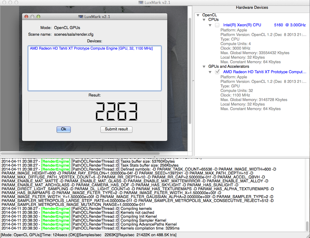

Fastest single one for FCP X... R9 280X!
I put flashed R9 280X in my 2,1 and it performs very well, as you can see on screenshots. It did BruceX FCP X benchmark in 49 seconds!
