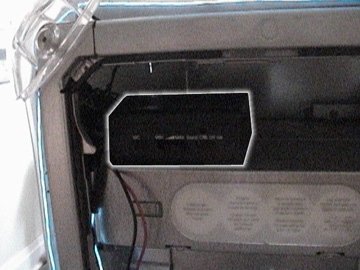

-Here is the inverter, switch out so that changing it over to sound-sensitive is easy.
Note that I mounted the inverter in the useless space above the CD drive. You can see the power wires from MOLEX P5 leading to it on the left.
Inverter highlighted...

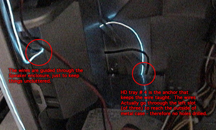

-Here's the big one.
This entire mod is held in place by tension - mostly at the corners. Tension is important to keep the glow consistant. If there is a slight bend the lighting may not be as bright.
