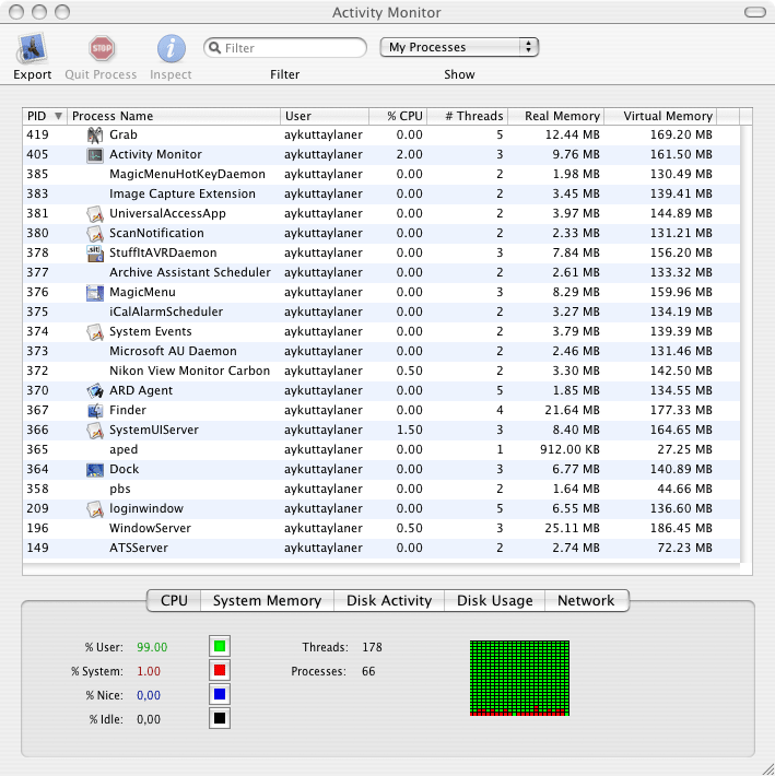

    I'm in desperate need of some advice. Almost all of my powerbook cpu processes are being taken up by the Finder. I've tried repairing permissions and clearing the PRAM but nothing seems to work. I only noticed the problem because the fan won't stop running. I've attached a picture from the activity monitor and am continuing to search the web but I can't seem to find anything.
    It's a 1.25ghz Powerbook G4 with 512mb of memory and 10.3.4.
    Does anyone have any suggestions?

    i did every thing....when i leave my PB and do nothing even then the fan is on :mad:

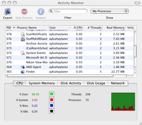

    If you sort by CPU usage, can you go to the top or bottom so we can see what process is using your CPU?

    here is my CPU usage list

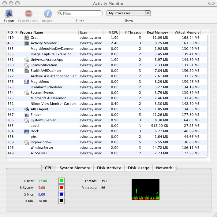

    i noticed something.... i just disconnect my PB froom the internet... i turn off my cablo modem.... and look what happened...but as i turn it on it gets crazy again...

    You are still sorting by Process ID (PID), though. You need to click on the CPU column until you get an arrow pointing down. Scroll all the way to the top, then send us that image.

    ... and change the drop down menu from "My Processes" to "All Processes" to find the name of the process that is sucking up you CPU resources.

    the problem was NORTON ANTI VIRUS AUTO PROTECTION..... but i did not understant why??? i am using it for 10 months maybe and this is the first time i had such a problem....i know what think abaout me "you fool why are you using virus protection, macs dont have any viruses... :mad: " i realy dont know the answer :eek: ..... but anyway THANKS TO EVERY ONE HERE!!!!
