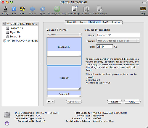

    You can create one partition on the 500GB MyBook HDD, that will suffice for your backup clone (you have 232GB used on the internal 297GB HDD, so create a partition using Disk Utility that is around 250GB, and then use SuperDuper or CarbonCopyCloner to clone the MBP to that MyBook.

    thanks... so how do i devide the 500gb wd hdd? i mean 300-200 or 250-250? please help... i'm new to all this. Thanks

    what type of partition
    what type of partition do i choose? i mean to clone my hdd? i saw: GUID, APPLE PARTITION MAP, AND MASTER BOOT RECORD?

    To answer your question... use GUID partition table.
    You can still clone your existing hard drive even if you don't have the OS X restore disks. Get a copy of Carbon Copy Cloner and then connect your external disk, run Disk Utility and select your external drive, and erase it, choosing MacOS Extended (Journaled) format. Then, run CCC and select your source disk (your Mac HD) and your target disk (the external) and do a "backup everything" clone. The first time you do this, click "delete items that don't exist on the source" and it will do a complete copy of your hard drive which should be bootable. When this is finished (could take a little while depending on how many gigs have to be copied) reboot your Mac from the external disk to make sure it works. Once you're sure it's a good clone, you can swap the drives out if you're upgrading your internal drive, and should be good to go. If you're only doing it as a backup, then you can just keep doing incremental backups to the clone. It's fairly self-explanatory once you're doing it.
