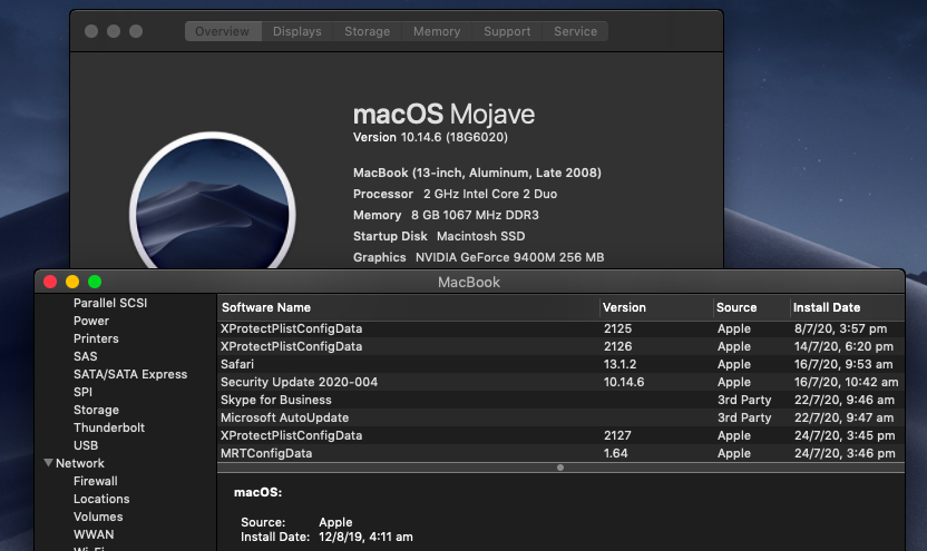

Erase, format as APFS and clean install. No issues on my MacBook5,1, it was made for Mojave.
I did an installation after formatting my drive to APFS and found it too slow running as the hardware doesn't recognise this format you install Dosdudes fix which must be a translator and acts at every read/write so the hardware thinks its HFS. A clean install only loads 10.14.6 minus the security updates of which there are a few...as far as I can tell but I may be incorrect here. I want it to run as HFS and install the updates as they come out. I was able to install all manually bar the current issue SecUpd2020-004Mojave...not sure why. Are you saying you have the current update running?
Yes, I do. Your issue is common, even High Sierra hates doing updates on HFS.
Sorry, I wasn't doubting you. I should have added I have a mechanical drive not SSD and dual boot with windows 10. There has to be something subtly different in the SecUpd 004 outside the distribution file contents that is causing a validation error. I can live with it but its annoying.

As I said you will get the same validation error on High Sierra, I believe it has to do with updating recovery, APFS recovery is updated differently and thus not producing this error.
Just tried it with the recovery update package commented out in the distribution file but same failure.... it writes files then puts out the failed banner.
I would not trust your ability to "comment out" any installer packages from the distribution file. I know it has been done before successfully(read the High Sierra on unsupported Macs thread) but in my opinion it is a totally useless exercise as APFS gives you the ability to install updates natively.
