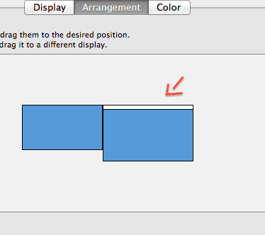

    In display prefrences, in the arrange tab, you'll see a little white bar that represents your menubar.
    [​IMG]
    drag it to place your menubar onto other monitors.

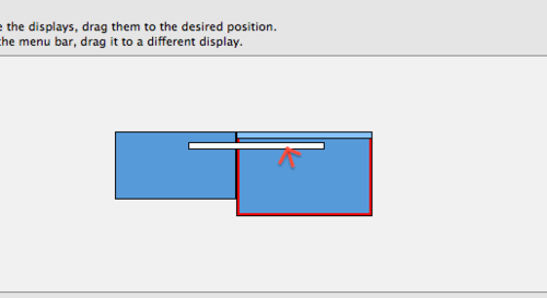

    [​IMG]
    this will also effect the placement of the dock.
