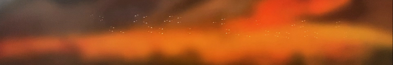

Just FYI,
Item 1 below- 1st clip:
Here are the moving 'dots,' always the same when rebooting ***from*** High Sierra only. Today I had instances of high speed fans without these dots. I'm booting from High Sierra to the same High Sierra using the select boot alt/option.
Item 2 below- Picture:
When restarting without login these dots appear on the out of focus stage while login out as in the picture below.
Item 3 below- 2nd clip:
The end of boot just before the login page (that does appear.)

The dots/squares are common when transitioning from the EFI frame buffer to the macOS driver (when past the halfway at the loading bar), but mostly when rebooting with some AMD GPUs and some macOS releases, High Sierra and RX 580 is a common one, when the GPU driver unloads to the EFI frame buffer again. To me this always seemed a VRAM buffer that was not cleaned, I’m not sure.
Sometimes happens even with late-2013 Mac Pro.
