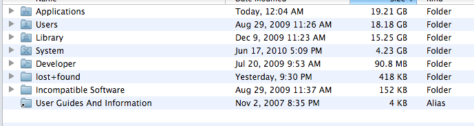

I tried to squeeze my OS drive down, and I got to 57 gigs. I didn't think about moving less-used apps to a different HDD, I can see what that does. Alot of the space was from the CS5 suite, which I use all the time, and then there seemed to be some other larger installs of things I rarely use, but being a former "Windows User", it never occured to me that I can just move entire app folders to a different drive with little consequence.
Most apps can be moved without issues but bigger ones like CS5 suite is more troublesome but if you use it all the time, it's better if it's in the SSD. I have a friend with 80GB SSD in his Mac Pro and he moved pretty much all but normal OS X apps and CS5 to an HD. Saved him a lot space.
You can also remove unnecessary languages and printer drivers, they eat few gigs.

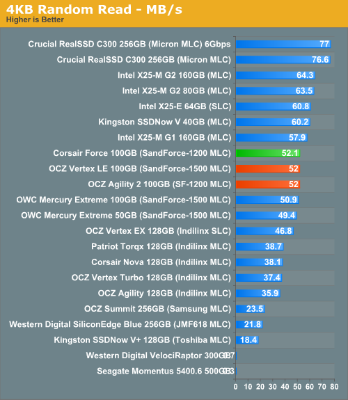

Just get the Intel SSD. It holds up as well if not better than any other SSD (even without TRIM which OSX doesn't provide). Plus it's a great size for your needs.
The most important drive performance metric for an OS/Apps drive is Random Read performance... Note how well the Velociraptor performs in this test... The Intel also out-performs the OWC by about 25%

I went on a move/delete spree and got the folder down to 43 gigs so far!
I was able to get my home folder down to about 5 gigs, there were tons of large, useless files in there like old cache's and log files. VisualHub had about 3gigs of log files alone.
I'm moving the home drive now, that should get me down to around 39 gigs. It's almost a challenge now, to get the smallest system drive possible.

Firefox didn't seem to like me moving my home folder. Even though the firefox profile says its located in thew new location, a bunch of addons and core firefox components are giving errors every time I start it up now.
edit: false alarm - I re-dragged Firefox to the applications from the download DMG, and it reset the profile and addons.
Down to 36 gigs now. That's probably plenty small for a 60gig SSD.

Man Apple and Adobe include a TON of sample files and templates.
I'm down to 28 gigs now by moving my home folder, and just mass-deleting garage band loops and iDVD templates, neither of which I'll ever use on a Mac Pro.
