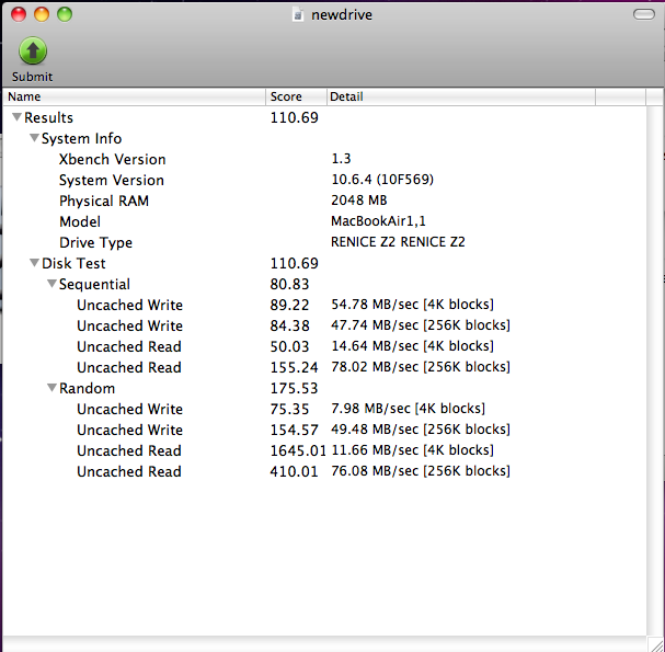

    Now to the BEST part. I was hopeful that the Renice SSD would prove a worthy upgrade to the stock SSD, and it didn’t disappoint. It was fast, and more than DOUBLED the MBA’s stock 64GB SSD with storage of 128GB.
    The results - 128GB Renice K3VLAR xBench Score vs. Original 64 GB SSD xBench.
    128GB Renice SSD = 110.69
    vs.
    64GB Stock SSD = 41.88
    How would you like a drive that outscores your original 64GB SSD by over 2.5X? Or, over the stock 4200rpm HDD by well a ridiculous amount of extra speed and give you more storage! I also noticed that the Renice PATA SSD is outscoring some SATA SSDs on xBench’s comparison site. Please notice I am using OS X 10.6.4 for both xBench reports below.
    Details…
    128GB Renice K3VLAR
    Results 110.69
    System Info
    Xbench Version 1.3
    System Version 10.6.4 (10F569)
    Physical RAM 2048 MB
    Model MacBookAir1,1
    Drive Type RENICE Z2 RENICE Z2
    Disk Test 110.69
    Sequential 80.83
    Uncached Write 89.22 54.78 MB/sec [4K blocks]
    Uncached Write 84.38 47.74 MB/sec [256K blocks]
    Uncached Read 50.03 14.64 MB/sec [4K blocks]
    Uncached Read 155.24 78.02 MB/sec [256K blocks]
    Random 175.53
    Uncached Write 75.35 7.98 MB/sec [4K blocks]
    Uncached Write 154.57 49.48 MB/sec [256K blocks]
    Uncached Read 1645.01 11.66 MB/sec [4K blocks]
    Uncached Read 410.01 76.08 MB/sec [256K blocks]

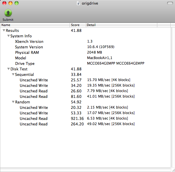

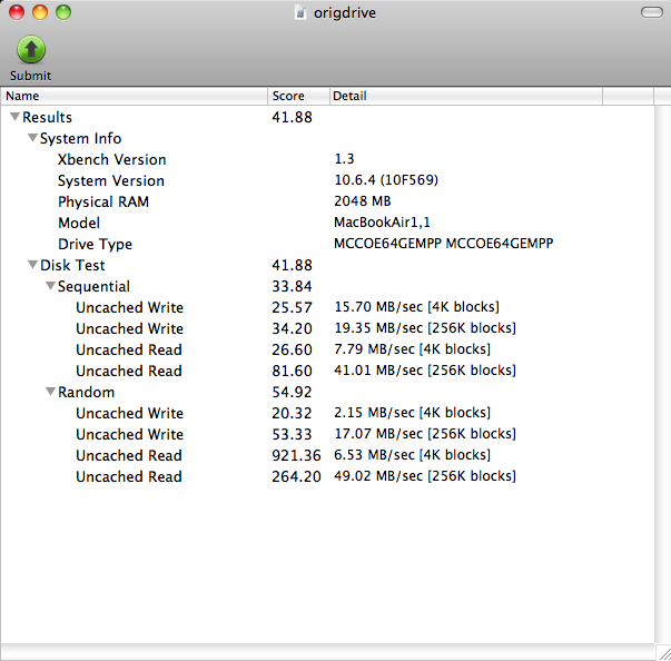

    64GB Stock SSD
    Results 41.88
    System Info
    Xbench Version 1.3
    Model MacBookAir1,1
    Drive Type MCCOE64GEMPP MCCOE64GEMPP
    Disk Test 41.88
    Sequential 33.84
    Uncached Write 25.57 15.70 MB/sec [4K blocks]
    Uncached Write 34.20 19.35 MB/sec [256K blocks]
    Uncached Read 26.60 7.79 MB/sec [4K blocks]
    Uncached Read 81.60 41.01 MB/sec [256K blocks]
    Random 54.92
    Uncached Write 20.32 2.15 MB/sec [4K blocks]
    Uncached Write 53.33 17.07 MB/sec [256K blocks]
    Uncached Read 921.36 6.53 MB/sec [4K blocks]
    Uncached Read 264.20 49.02 MB/sec [256K blocks]
