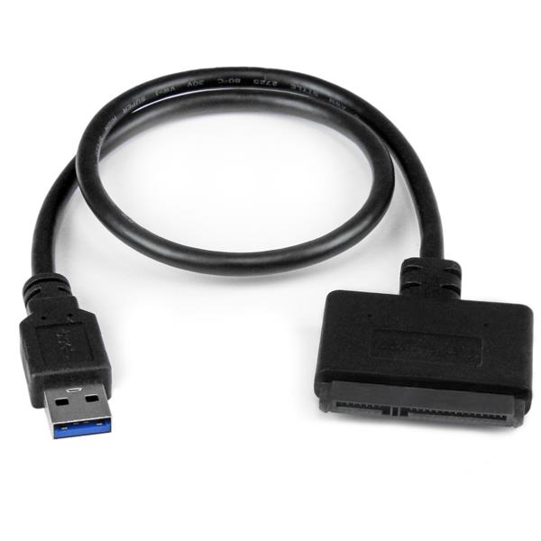

    For only $12 and given that SATA is 2.5" now, these adapters are very handy to have around. You can test the drive, you can test it's ability to boot, and you can clone your previous drive before it goes inside.
