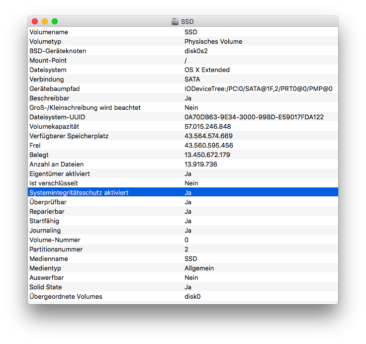

    I really tried every option on each Beta version and at least 3 different MacBooks.
    It never ever worked, although I always got the message that it is disabled and I have to restart.
    Now csrutil seems at least to work directly in the recovery terminal. On Beta 7 it was hidden in some folder, where I had to go first. Just followed the link from @w0lf and tried it again.
    The status says it's still enabled, but these configuration options are all disabled. I don't know if they were before. Are these extra options or is it completely disabled now?
    csrutil status
    System Integrity Protection status: enabled (Custom Configuration).
    Configuration:
    Apple Internal: disabled
    Kext Signing: disabled
    Filesystem Protections: disabled
    Debugging Restrictions: disabled
    DTrace Restrictions: disabled
    NVRAM Protections: disabled
    The DiskUtiltity application is displaying too that it is still enabled, they even forgot to translate it:
    Edit: By the way, I was thinking about switching to english because I write mostly here. But than I cannot report translation errors to Apple anymore. What do you think should I do?
  5. KALLT, Sep 2, 2015
    KALLT macrumors 601
    Joined:
    Sep 23, 2008
    #5
    csrutil is a work in progress, it is possible and likely that the information shown is not accurate yet. In fact, the status operation was expanded only two betas ago (before it wouldn’t even show you that much information). Also the info window in Disk Utility is not accurate with respect to System Integrity Protection, it has been a known issue.
    In short: don’t solely rely on what the utility or the system says. What are you trying to do anyway, have you confirmed whether that works?

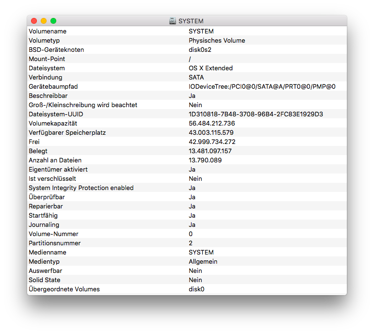

  6. Erdbeertorte macrumors demi-goddess
    Joined:
    May 20, 2015
    #6
    I just thought some issues with applications might be caused by that. But that was in the first beta, when there were not any beta versions of these applications. I think I just don't need to turn it of anymore. Everything is running fine.
    They even got translated it now in the GM Candidate:
