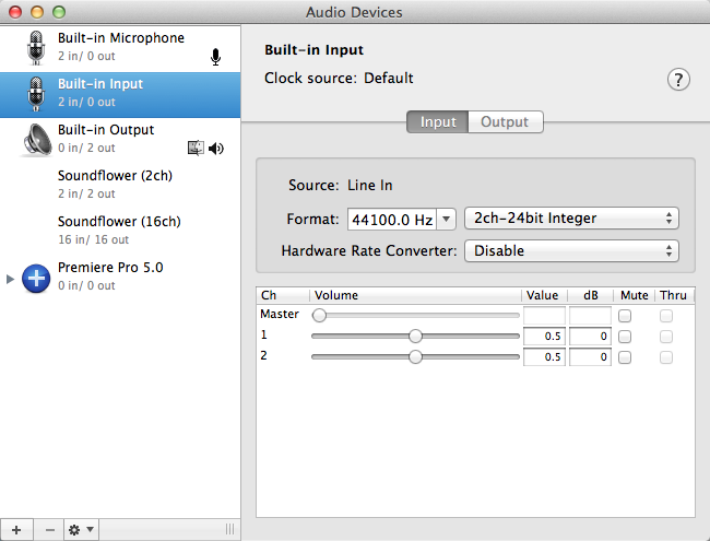

    I would also try with different audio formats in MIDI Setup app:
    [​IMG]

    You shall change the values on Format line (ie Sample rate & bit depth).
    I must have misunderstood you. Basically you get the sound from TV speakers, instead of receiver's speakers (meaning also, sound circumvents receiver's surround decoder)? In that case you have sound routing problem within your receiver. Check if Marantz has full user guide available online.
    It should be possible to route sound into receiver's internal processing, esp if it's an AV receiver (having surround decoder).
    PS E.g. on a Sony receiver, there's a "HDMI Settings menu", which has the control "HDMI Audio Out" that lets you set where the HDMI audio signals from the playback equipment connected to the receiver via an HDMI connection get output. You can choose between:
    AMP: The HDMI audio signals from the playback equipment are only output to the speakers connected to the receiver.
    TV+AMP: The sound is output from TV’s speaker and the speakers connected to the receiver.
    I'd imagine, the Marantz receiver exhibits similar configuration options.
