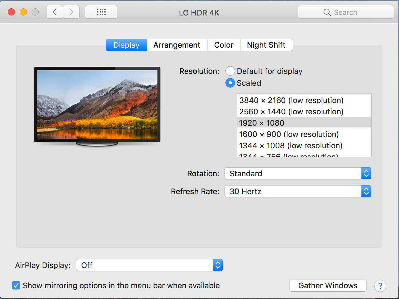

I just bought a 2018 MBP with a LG-27UK650 (didn't buy the usb-c version in order to save about $200 that I will use toward an eGPU later on which will work with a single cable for display and charging etc.)
I love the "More Space" scaled option on the internal screen, everything is big enough and I have plenty of space. On the 4k monitor I don't see the scaled options. This is what I have instead:
I can only choose 3840x2160 not scaled 2560x1440 not scaled or 3840x2160 scaled to 1920x1080 where everything is too big and it cancels the main advantage of having a 4k screen.
I tried holding the option key to have more resolution options and I even installed Retina DisplayMenu but I can't find a scaled option somewhere in between. I'm thinking an output of 3840x2160 with everything scaled like 2880x1620 would be perfect.
I'm currently using a cheap usb-c to hdmi adapter which I thought would do the job but apparently I need a usb-c to DisplayPort for 60hz. Could it also be the reason why I'm not seeing more scaled options?
Thank you for your help!

I should have updated this thread. I did get the Moshi displayport adapter and with it the options I was looking for appeared 🙂 it’s also running at 60hz which is noticeably better.
On the other hand the scaled resolutions affect performance and even simple things like opening the app launcher is choppy. Anyway, it seems my eyes got used to the full 4k so I’m using that 😳 I’m afraid of causing eye fatigue like that but for now it seems better than on my old low res mbp.

I don't get the option to switch my monitor to 60Hz. Is that because I'm using a USC-C to HDMI lead? Do I need USB-C to DisplayPort?
Depends on what Mac you're using and what kind of USB-C to HDMI adapter.

From what I understand you can't get 4k 60hz over HDMI. I think you need USB-C to DisplayPort.
https://support.apple.com/en-ca/HT206587
I'm sure I've seen people doing this. I could be wrong, as I cannot seem to find where I read it. If I did at all...
I have a 2018 13" MacBook Pro. I'm using one of these from my mac straight into the monitor. Amazon says it supports 4k@60Hz
https://www.amazon.co.uk/gp/product/B07B7LGK1F/ref=oh_aui_detailpage_o03_s00?ie=UTF8&psc=1
Can't comment on that particular cable, but your machine with the right adapter & HDMI cable should definitely support 4K 60Hz over HDMI.
However, I've always found HDMI to be a mess. DisplayPort is much simpler and more consistent, in my experience.
