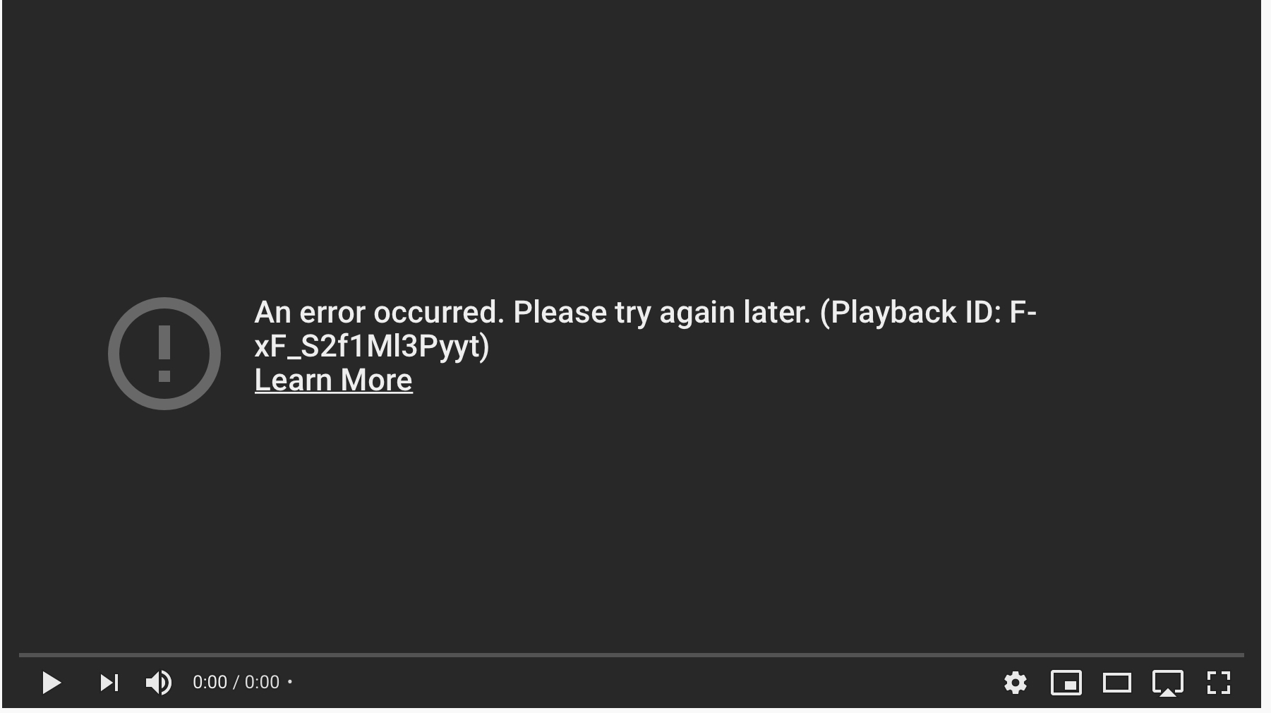

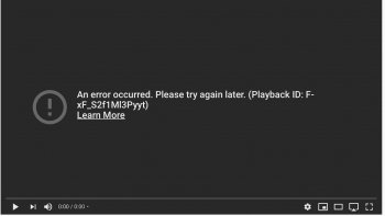

i just posted the same issue. If you just installed 13.6 I believe we have the same issue. On my iPad Pro I can turn off the content/ad blocker which will get the video to load and play properly. Also if you request the mobile site version the video will play correctly. The video issue does not occur on the phone since it uses the mobile version by default. On my ipad if I tap the black area where the video should be I get the error message in the screenshot below, if I didn’t use the mobile version or turn off the ad blocker.

In the web site option from the Safari address bar turn off the “request desktop site” option, now the mobile version will be the default and that works properly even with an ad blocker enabled.
