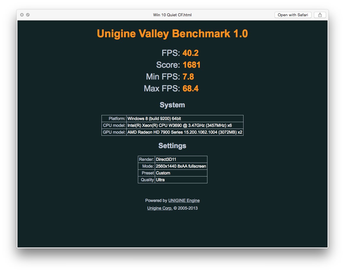

    Just tested it. If any card use a Mac EFI ROM to boot, both card will have the ability to show boot screen. However, may have trouble to use crossfire.
    So far, my tests result is as follow (Win 10, SSD via SATA 2 port in optical bay, no bootcamp driver installed, latest non beta CCC).
    Both card boot from Mac ROM, stuck during boot (after crossfire activated).
    Both card boot from non EFI ROM, takes a bit longer boot after crossfire activated. But can use it without problem.
    The card attach to a monitor without EFI, but the other one boot from a EFI ROM. Boot screen still available from the non EFI card. Sometimes it can boot (I didn't time it, but feeling that cost more time to boot than both non EFI card), but sometimes it stuck. If boot successfully, crossfire will be available.
    In any case, if crossfire no working properly. Recycle the crossfire option in CCC will fix it easily.
    Update 1: Install bootcamp drivers won't affect the crossfire. And here is the 7950x2 Valley benchmark (everything maxed out with V-sync in 2560x1440).

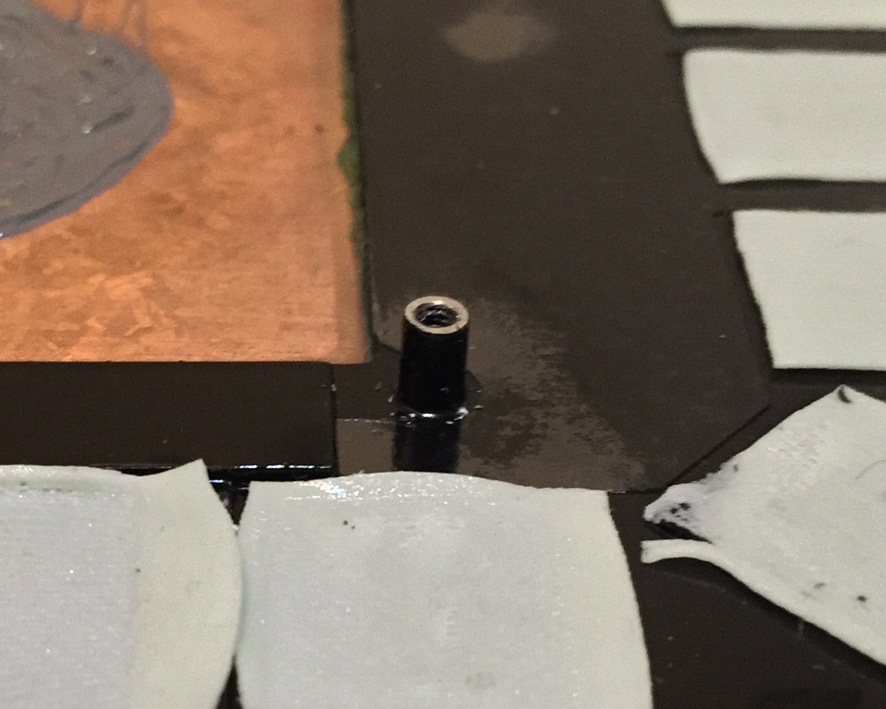

    My only problem is that after my 7950 Mac Edition card RMA. Sapphire sent me a replacement that with a very poor cooler. The card overheat straight away. I open it up and replaced the dried out thermal paste. Helps a bit, but when I replace the paste. I realise there should be quite a big gap between the card and the GPU. I need to use a lot (around 3x normal) AS5 to make the cooler able to "contact" the GPU (I test it by applying the paste, put the heat sink back, and then remove it to check if the pea become a disc and cover the whole GPU). So now, the card works, won't overheat, but still very hot and very noise (60% fan and 88C max).

    Problem fixed. I open the card. Cut these 4 screw hold bar a bit (half mm may be). And remove some extra thermal paste (I prefer to re-apply it, but I have no more paste on hand now). Now the card run Valley benchmark at 70C @ 36% fan speed with that poor reference cooler. Just very very little fan noise now. I am extremely happy with the result :D
