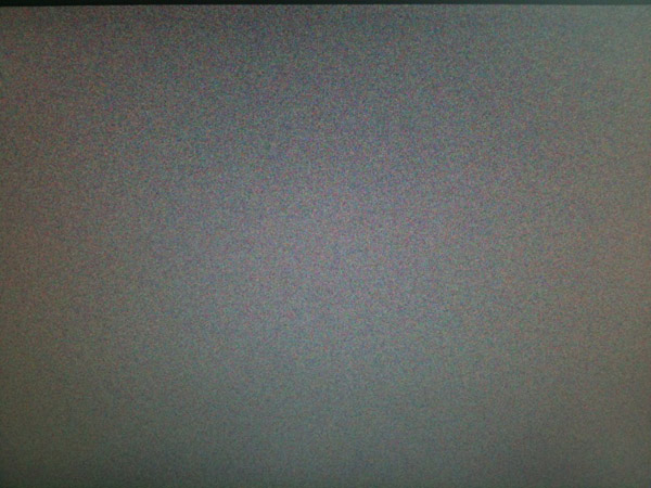

    Been working with a new mac mini in my office the last 2 days. The power settings are set to make the display only go to sleep after 15 minutes. System set to never go to sleep and hard drive never spins down.
    3 of the 4 times since working with this thing when moving the mouse to wake up the display I get nothing but noise and snow on the screen. To get back to functioning correctly I have to put the computer to sleep with the power button and back on again. Once it comes back, it will work fine.
    new mini 2.4 running 10.6.4. monitor is hooked up via DVI through the mini displayport.
    Anyone heard of something like this happening before? Brand new machine so you think it should go back?
    [​IMG]
    Thanks

    I am having the same issue with my new Mini.
    I am completely convinced that it has something to do with the mini display port specifically. I have tried several different configurations to test what situations show the static.
    HDMI -> HDMI - no static
    HDMI -> DVI Adapter -> DVI - no static
    HDMI -> DVI Adapter -> DVI-HDMI Cable - no static
    Mini Display Port -> DVI - static when waking from sleep
    From researching this very wide spread issue (which has been going on for several years), I have only seen people indicate this is a problem when using the Mini Display Port. The same monitor had no issue on a iMac using the Mini DVI -> DVI connection.
    I would be curious to know if anyone here has a Mini working on two monitors using the Mini Display Port, where they do not get static when waking the display from sleeping, or pressing CTRL + SHIFT + EJECT. If you do not have this issue, can you let us know what model monitor you are using in this setup. I don't have a MDP -> HDMI adapter, so I don't know if that would cause an issue or not.

    Still happens about 50% of the time. I found I can just cycle my monitor off and then on again and that solves the problem. Also, if you have it set up to password protect on wakeup you can put your password in while the screen is filled with noise, hit return and the monitor will wake up.
    I too am 100% convinced this a MDP issue. LAME!!!

    ^No it doesn't correct itself. I saw it worked for others so I tried the other day. Woke it up to static, swapped my laundry and when I came back it was still static. 22" Acer.
