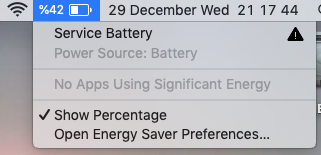

Recently a relative of mine handed me her MacBook Unibody Late 2009 (A1342) by noting that it no longer worked. When I got it it didn't even power up and it had a hefty bump at the middle of the keyboard and the touchpad. The battery had been badly swollen. I told her that it could be fixed by replacing the battery but she was not interested in using or even seeing this laptop. Apparently she had discarded it for a time. She said that I could do anything with it, sell it for parts or fix it, that she didn't care. So I decided to buy a new aftermarket or a used original A1331 battery and use it. Recently I've bought a used original Apple battery for about $35. The seller tested it on his A1342 MacBook running Windows 10 and sent a video showing it. It was performing quite good on Windows 10, displaying at least 4 hours Remaining. After I've connected it on my MacBook running 10.14.6 Mojave I've noticed that when I connect the power chord, it wasn't being charged. The orange LED at the tip of the chord was lighting for a couple of seconds then it was turning off. The battery was apparently not being charged. I've checked the cycle count of the battery. It's 704. After a search on Google I saw a suggestion at Quora, which said : Deplete the battery completely and leave it off for 24 hours and then plug in the charger. I've tried that and it worked. The battery was being charged and it was charged %100. After that full charge I've been using the laptop for hours. I haven't really counted how many but many hours and the decrease in percentage was steady, i.e. it decreased one by one, it didn't jump to lower values. So, basically it's operating fine and I'm quite pleased with it. The only problem is, it doesn't show the time Remaining, it shows instead the Service Battery remark:
Is there a way to get rid of this and make it display the "Remaining" ?

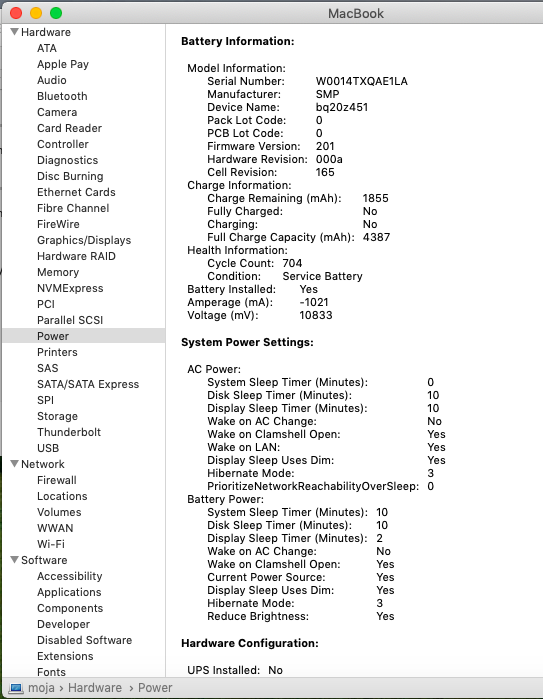

Here is the Power info:

Reset SMC. https://support.apple.com/en-us/HT201295 :cool:
