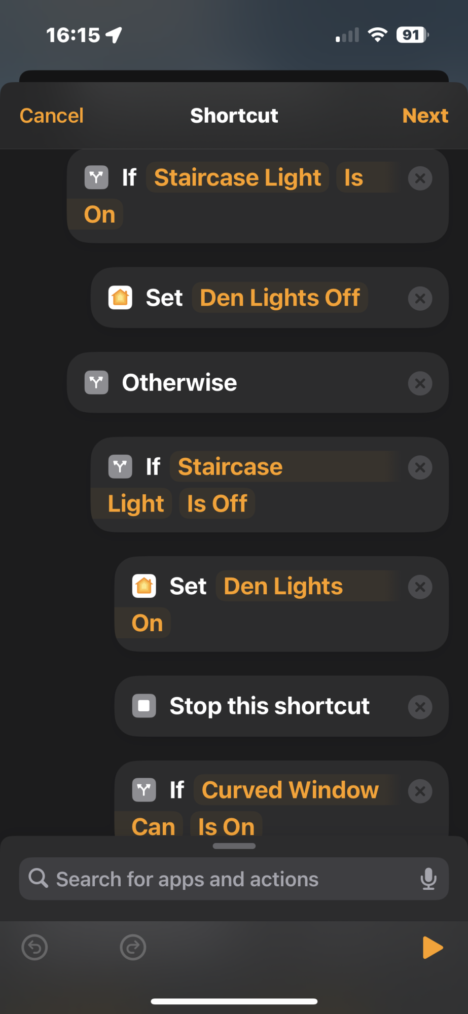

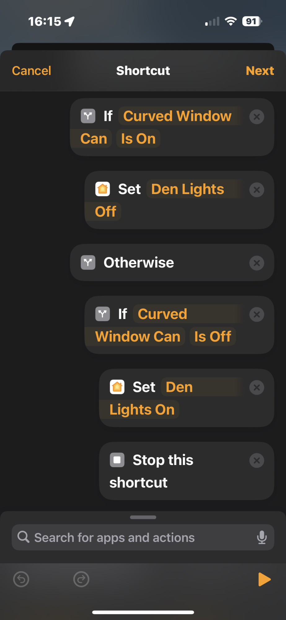

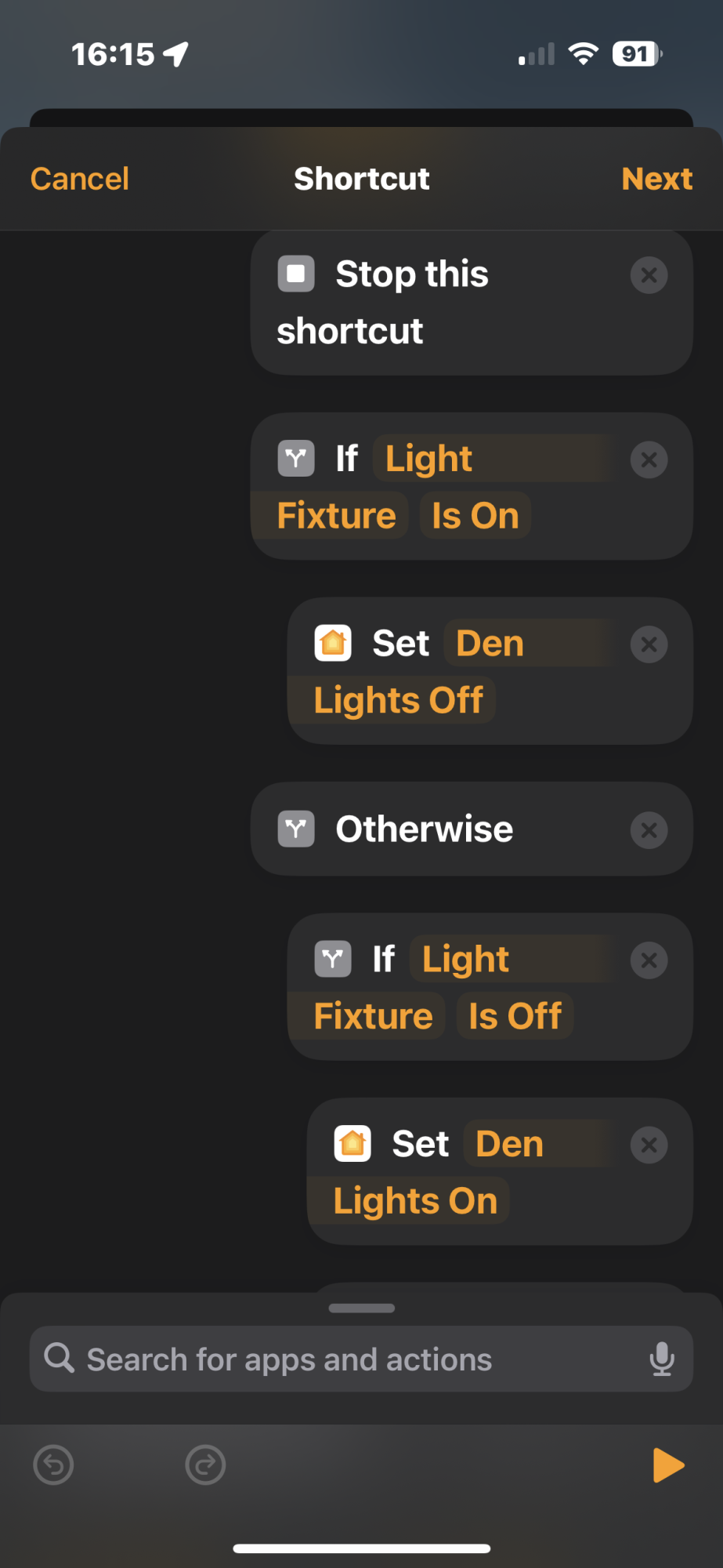

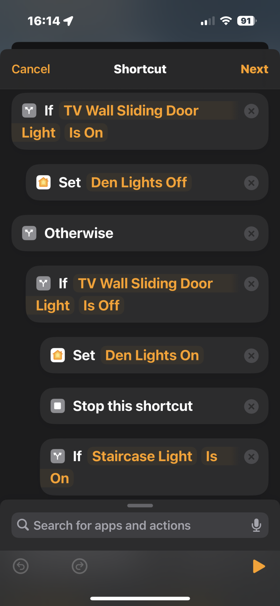

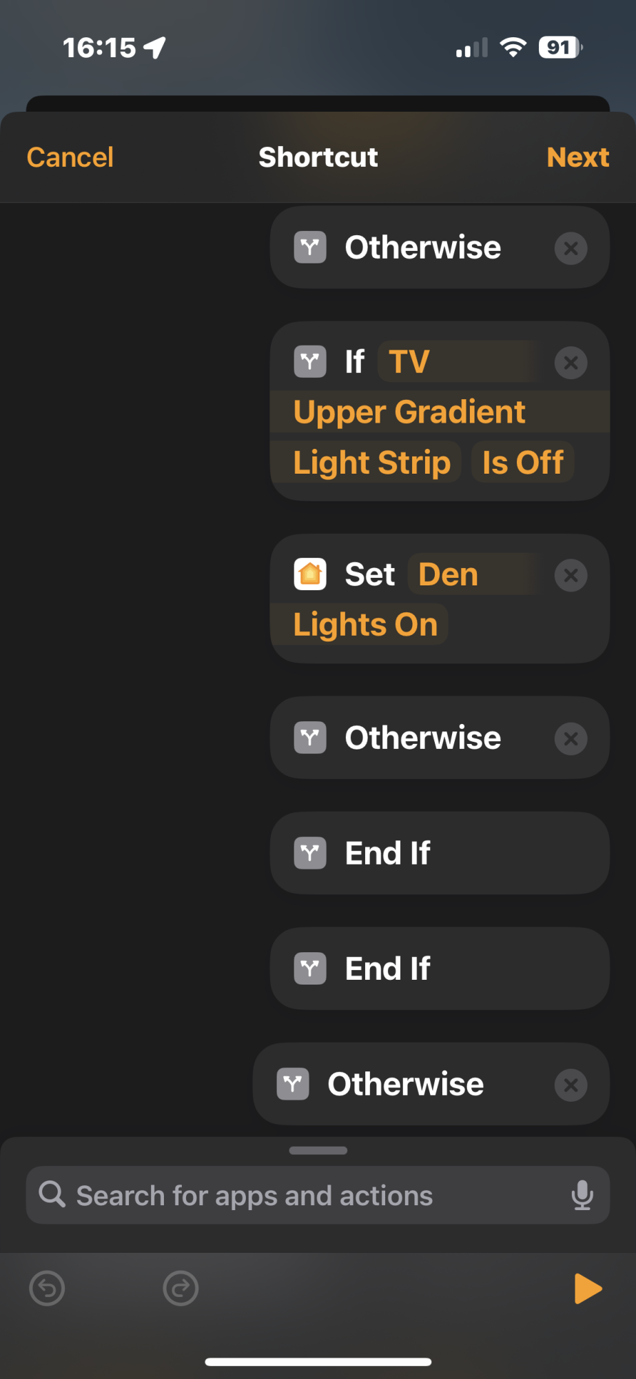

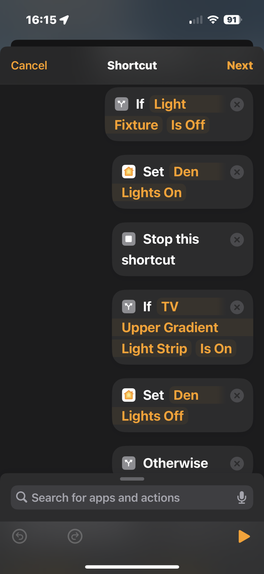

This is a staircase switch that I want to tap just once to turn them all on when I’m walking down or turn them all off as I’m leaving a walking up. There are two separate rooms in this zone.
This is what the Shortcut ended up looking like, in case anyone else is seeking the same solution.
Note that in the “if” actions, it is only able to take one bulb from a group of bulbs. Shortcuts doesn’t recognize a group of bulbs. So for example, “TV Wall Sliding Door Light” is included in a group of lights called “Theater Lights.”
There are two rooms in this zone: Zone is: Den, Rooms are: Theater and Game Room.
“Stop this Shorcut” adds an “or” action.
It’s a long shortcut but it checks the power state of each light bulb in the mix and if any one of them are on, it turns them all off. Conversely, if any one of them are off, it turns them all on.
This doesn't make sense, unless I'm misunderstanding something. If some lights in the mix are on and some are off...you can only turn them all off, or turn them all on. You can't have it both ways.
For example (based on your shortcut you posted), say your Staircase Light is on and you want to turn it off...it'll only turn off if the TV Wall Sliding Door Light is also on. (Because if the TV Wall Sliding Door Light is off, it turns all lights on.) On the flip side, say your Staircase Light is off and you want to turn it on...it'll only turn on if the TV Wall Sliding Door Light is also off. (Because if the TV Wall Sliding Door Light is on, it turns all lights off.) This is only dealing with the first two lights in your shortcut. It gets a little more complicated the further down you go and a light may not have the behavior you expected.
View attachment 2236713View attachment 2236715View attachment 2236716View attachment 2236714View attachment 2236717View attachment 2236718
This is a good start, but it has unnecessary "if" statements. You are checking to see if a light is on, and then checking the same light again in the "otherwise" clause to see if it's off. The light can only be on or off. If it's not on during the first check in the "if" statement, you already know it's off...so no need to check it again. Your shortcut could be simplified to:
Code:
If TV Wall Sliding Door Light Is On
    Set Den Lights Off
Otherwise
    Set Den Lights On
    Stop this shortcut
    If Staircase Light Is On
        Set Den Lights Off
    Otherwise
        Set Den Lights On
        Stop this shortcut
        If Curved Window Can Is On
            Set Den Lights Off
        Otherwise
            Set Den Lights On
            Stop this shortcut
            If Light Fixture Is On
                Set Den Lights Off
            Otherwise
                Set Den Lights On
                Stop this shortcut
                If TV Upper Gradient Light Strip Is On
                    Set Den Lights Off
                Otherwise
                    Set Den Lights On
                End If
            End If
        End If
    End If
End If
Also, just for clarity, "Stop this shortcut" isn't an "or" action. The reason why you are needing it in your shortcut is because you are turning the lights on in the previous line, so you need to quit the shortcut before the next "if" statement checks to see if a light is on.
You'll still have the "unknown" behavior mentioned above, based on whatever state each of your lights are in. If you want a more consistent/"known" behavior, it would be best to decide what you want to happen if some lights in the mix are on and others are off. Do you want to turn everything off, or turn everything on?
This example will turn everything off first if a light is on; if all lights are off, then it'll turn everything on. I know you said this didn't work before, but it should. Pay close attention to the nesting and position of the statements. Post screenshots if you still have trouble.
Code:
    Set Den Lights Off
Otherwise
        Set Den Lights Off
    Otherwise
            Set Den Lights Off
        Otherwise
                Set Den Lights Off
            Otherwise
                    Set Den Lights Off
                Otherwise
                    Set Den Lights On
                End If
            End If
        End If
    End If
End If
Reactions: Itinj24
