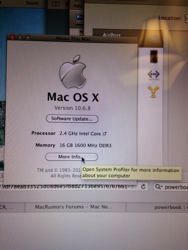

    My fourth attempt: I took the SSD and rammed it in to my old white MacBook, shoved an OS X 10.6.0 DVD, installed it, installed the combo 10.6.8 update and stuck the SSD back in my MBP, and to my surprise, as it is a late 2011, it booted, and works perfectly. After using snow leo it feels like a true desktop OS, and not a big fat iPhone. Don't believe me?: ImageUploadedByTapatalk1375943348.071819.jpg

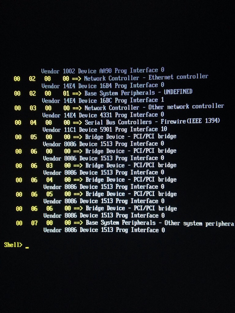

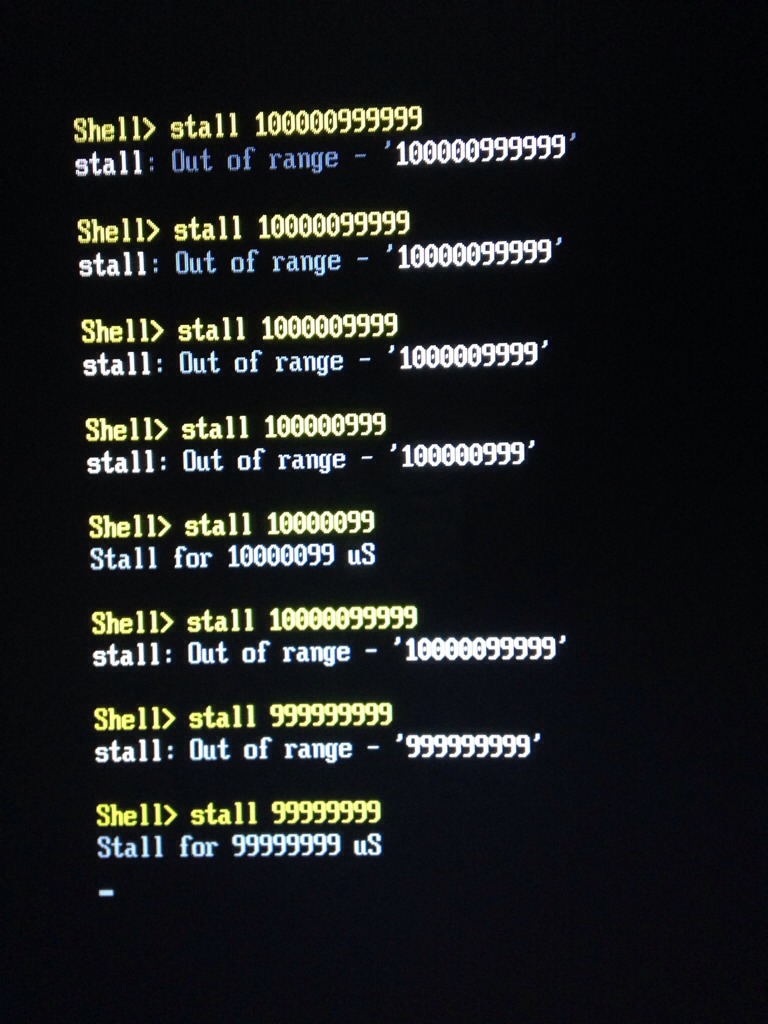

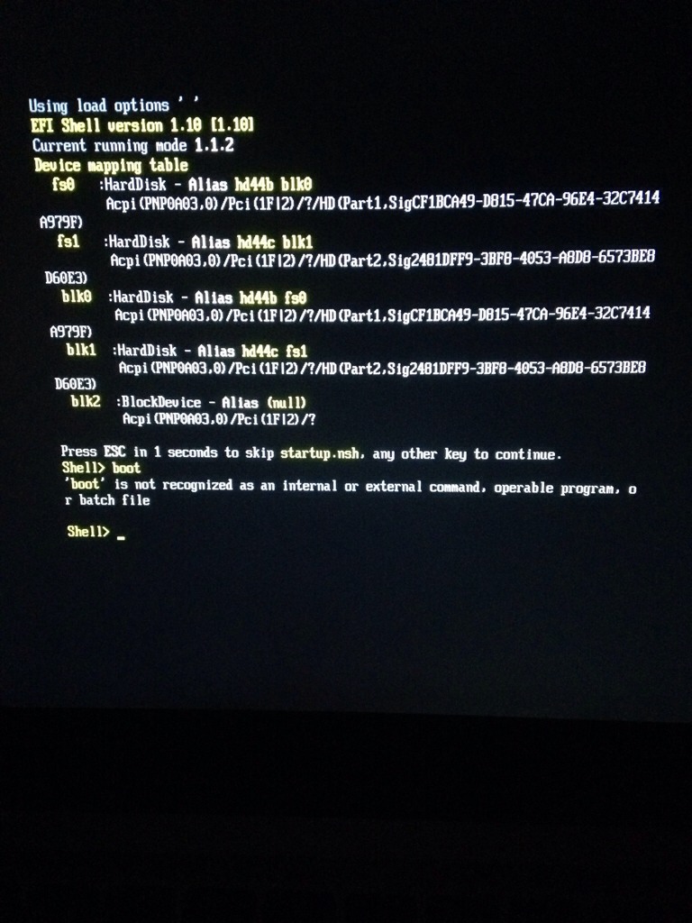

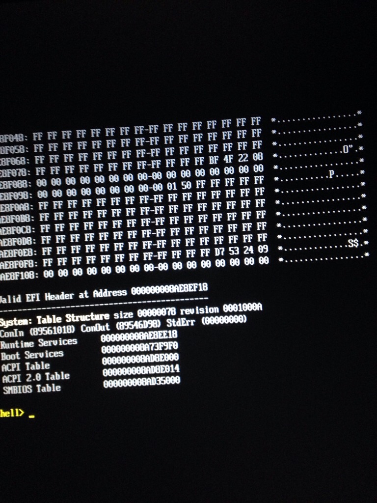

    My 5th attempt: I cracked EFI, and am trying to monkey with the CPU speed settings. Does anyone know commands? Don't believe me?: ImageUploadedByTapatalk1375943177.168678.jpg ImageUploadedByTapatalk1375943190.401960.jpg ImageUploadedByTapatalk1375943202.335587.jpg ImageUploadedByTapatalk1375943215.135854.jpg

    I have a Late 2011 17" MBP. The Early and Late 2011s are basically the same machine, with the Late 2011 having slightly newer versions of the same CPU and GPU family as the Early 2011. The 10.6.0 installer needs the updated Sandy Bridge drivers that were added in 10.6.7. The later 10.6.7 install disk that came with the Early 2011s is only preventing you from installing on the Late 2011 because Apple has a compatibility file on the disk, which I believe you can remove and re-burn to disk (or copy to a USB flash drive).
