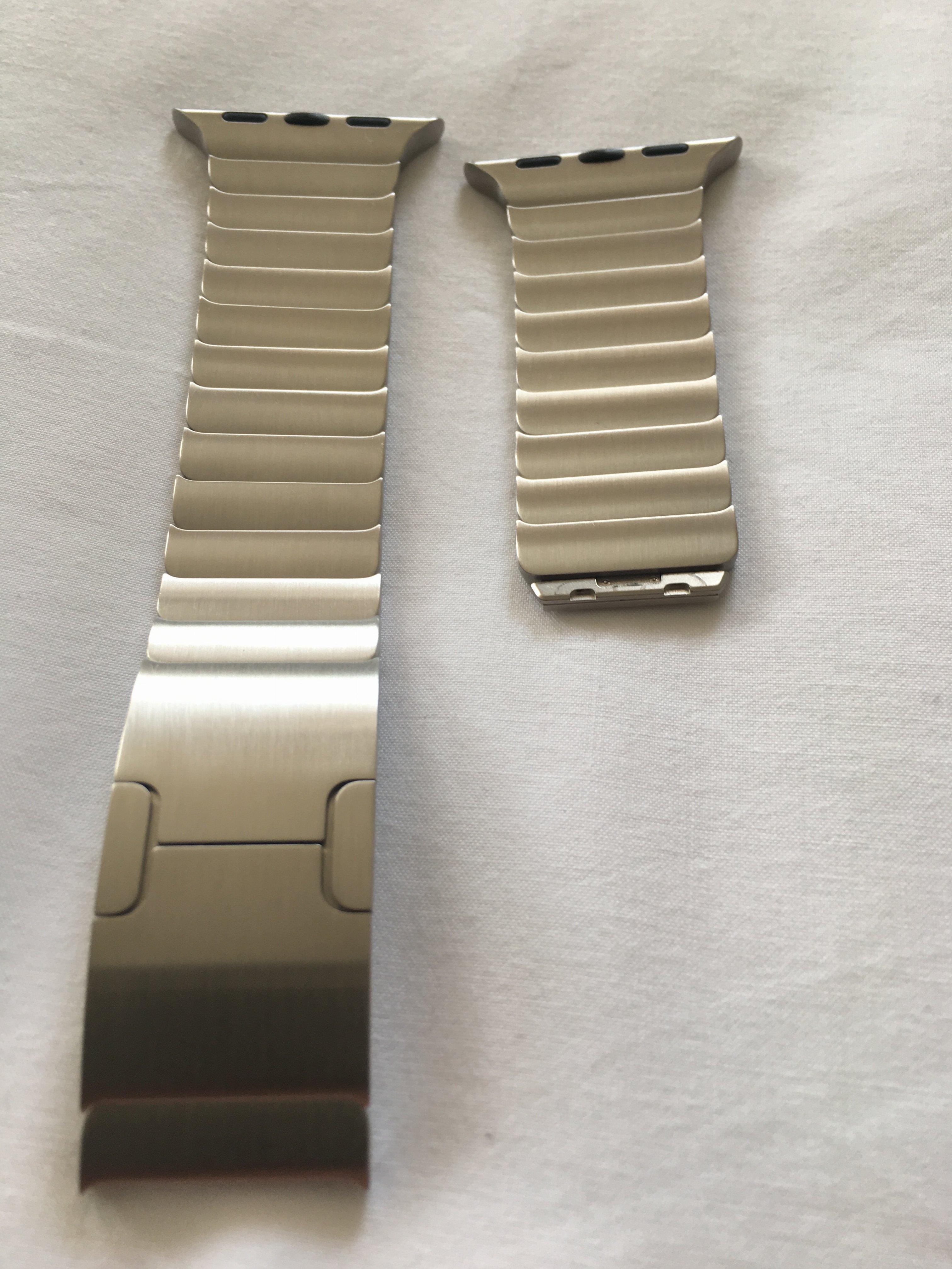

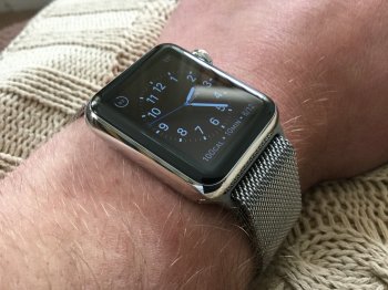

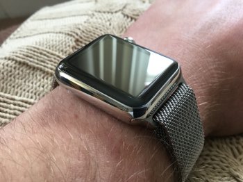

    image.jpeg image.jpeg Here is my almost one year old SS version. I usually polish once a month. It's pristine. I would hate to see what it looked like without polishing. I have zero micro scratches on my watch body or crystal. Any marks in the photo are just pieces of dust.
    I use a Cape Cod cloth, kitchen paper to remove the black stuff that the cloth leaves behind, then wash the watch body under a warm tap using a sponge. Then I dry it, polish to a lustrous shine with a microfibre cloth that's it. Easy. I keep the Cape Cod cloth away from the screen. So - after polishing now 12 times or more, the watch looks and operates perfectly. No speaker or mic issues either.
    (Also, just recently I got a grey 3M Scotchbrite pad and removed several scratches from my link bracelet and Milanese loop clasp too - this pad worked amazingly well! It looks brand new again - I can post pics if anyone wants to see it)

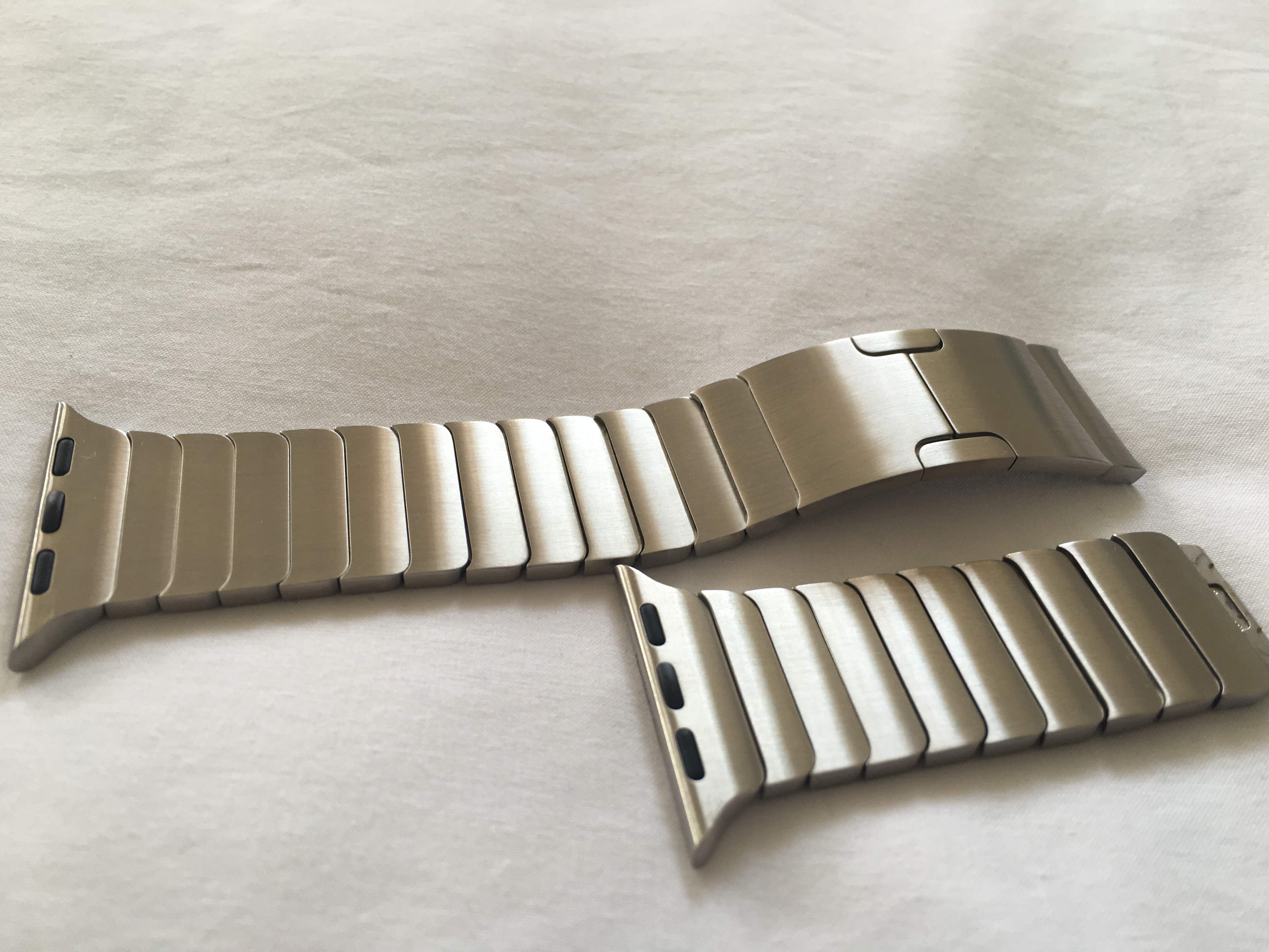

    Here's a couple of pics guys. All the little scratches are gone from my link bracelet since using the grey 3M Scotchbrite pad. You have to be very careful and light handed. Even 3 or 4 strokes of the pad can remove scratches. You must also follow the lines of the brushed steel so there are no horizontal brushes seen on the bracelet.
