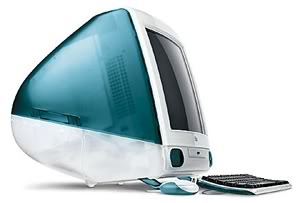

Now correct me if I'm wrong, but I thought the G3 and G4 iMacs looked completely different?
G3
G4
Sounds like it was a G4 iMac with the display on a pole, the G3 I'd think the water would just run underneath. The G4 on the other hand has components very close to the desk...
The bottom of the G4 does have vents in it, which could allow water right up into the area where the logicboard is. However, I think it would have to be A LOT of water to get into the drive
