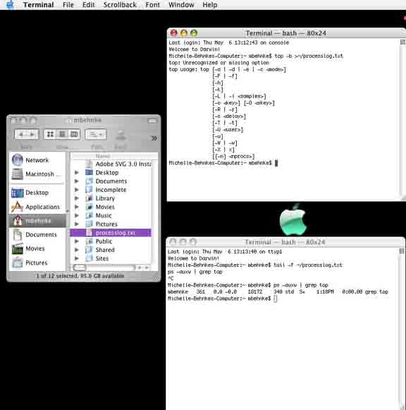

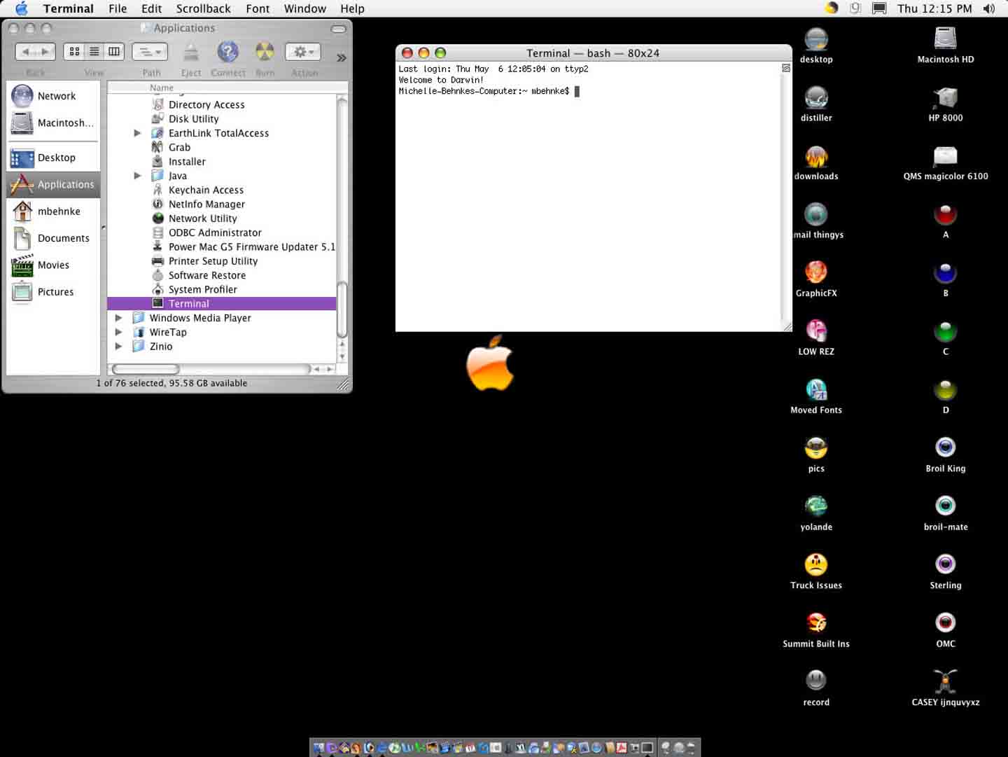

    ok - I am doing something wrong. When I open Terminal I get a little window - see first picture. If I go to File > New Command... I get the second picture. No matter what I do or type in either one it doesn't seem to be doing what it's supposed to do. So please tell me where exactly to go, what to do and what to type......

    No, no...you need to be typing the command in the Terminal window itself, not the new command prompt. Once the Terminal is open and you get that Welcome to Darwin message, type the command in my earlier post: "top -b >~/processlog.txt" (without the quotes). Terminal should appear to freeze - this means it's working. You can hide the Terminal window. If you want to use tomf87's tip for viewing the log file in real-time, create a new Terminal window by choosing New Terminal (I think - the shortcut is command-N) from the File menu and typing the command in that window.

    Oh CRAPPY! This doesn't seem to be working... The process log isn't getting bigger..... Did I do something incorrectly??? :(

  17. wrldwzrd89 macrumors G5

    Maybe you've caught it in between sampling intervals. Just check later, when it should have taken another sample. It surprises me that it is sampling so infrequently.
  18. abhishekit macrumors 65816
    abhishekit
    Joined:
    Nov 6, 2003
    Location:
    akron , ohio
    #18
    so many icons on ur desktop!! :eek: :eek:
    wat r u , a windows user ? :D
    and, whenevr u get the beachball..i just open the activity monitor, which is in applications-utilities, and see which process is taking most cpu..and generally its safari :rolleyes:
    but i never get any freezes, even if the ball comes, its fr some seconds..
    n may be its norton thats being the hog..
