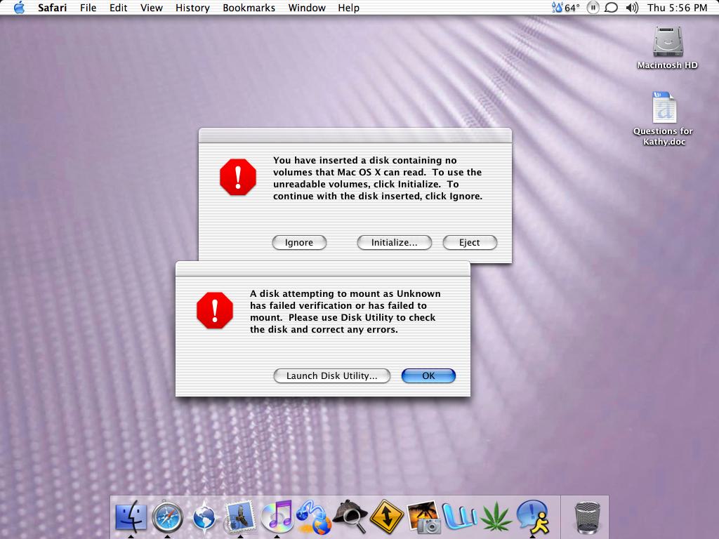

    Hrm. This popped up when I connected my iPod. I upgraded to 1.2.6, but it has worked since then. Now, it won't connect at all. All I get is this error.
    What to do?

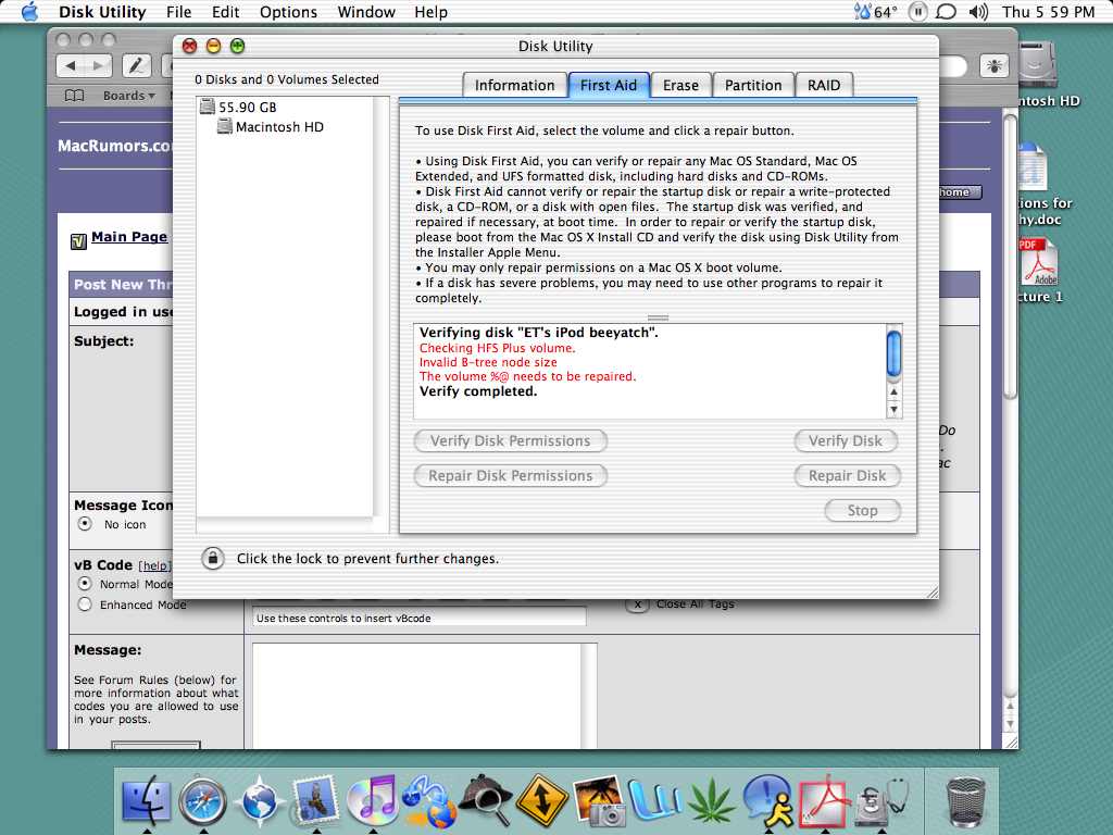

    and this is what happens when i click on "verify disk," and then the iPod unmounts. time for a reformat?

  3. moose macrumors newbie
    Joined:
    Mar 5, 2003
    Location:
    Colorado
    #3
    You too!
    I have a thread running for this very reason...
    I have the iPod fixed following the advice of some of the other members. Only problem is that now iTunes under X won't mount it as a source. But it will under OS 9 and iTunes 2. Chck out my thread for other's feedback...
    http://forums.macrumors.com/showthread.php?s=&threadid=22964

  5. Billicus macrumors 6502a
    Billicus
    Joined:
    Apr 3, 2002
    Location:
    Charles City, Iowa
    #5
    Did you try doing repair disk in that window? In general OS X is a little bit more picky when it comes to problems like this. Do you have the latest version on iTunes, of OS X, and I saw you said the latest version of iPod software was on it. What kind of iPod is it and how many songs do you have on it?:cool:
  6. coolbreeze thread starter macrumors 68000
    coolbreeze
    Joined:
    Jan 20, 2003
    Location:
    UT
    #6
    I did try repair disk. It said finished, but when I reconnected the iPod, I got the same errors in my first post above. I would love to just do a restore, but I can't because my iPod won't even mount. I am now in the diagnostic menu doing a HDD scan on the ipod. Still waiting...
    BTW. I am running the most current version of iTunes. It is a 10GB Mac iPod with about 890 songs on it. This is the first time I have had a problem with it ever. It was working fine before this fiasco. I didn't do anyting out of the ordinary (except update to 1.2.6, but it worked fine for days after that).
    Strange.
  7. moose macrumors newbie
    Joined:
    Mar 5, 2003
    Location:
    Colorado
    #7
    Ditto. Sorry to say, but in my experience, you can run repair until the cows come home and it will always see it, but it will never fix it.
    Mine is a 5 GB. 0 songs since the restore.

  12. losfp macrumors regular
    Joined:
    Jul 16, 2002
    Location:
    Sydney
    #12
    Did a restore with XPlay on my PC, and now it works! I'll have to sort out which mp3s I want to transfer back on there though!! but at least it'll mount and transfer on my mac ok now.

  14. moose macrumors newbie
    Joined:
    Mar 5, 2003
    Location:
    Colorado
    #14
    cool,
    I posted my process in my other thread... I had a successful, albeit contorted resolution to my situation.
    Best of luck... :)
