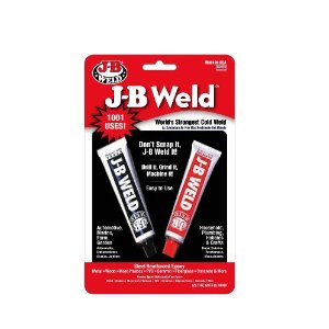

    It's at every auto parts store.
    [​IMG]
    It's amazing stuff. Don't know if it will work in this circumstance though but it's worth a shot.

    I bought the J B weld and i see on the back it says 4-6 hours dry so i guess i should do this tonight.
    What do you do? take the two tubes and mix them together then put it on the end of the driver and hold it on the screw hole ?

    Yes mix together equal amounts till the color is uniform. Have the iPhone masked, and the screwdriver prepared beforehand.
    Also have whatever method you come up with to hold the screwdriver in place ready to go. If it were me I would probably use a drill press--off!--with the screwdriver as the "bit." Then I would have the iPhone secured vertically, upside down, and get the alignment down perfectly. This would allow me to gently lower the screwdriver to the screw, and lock it in place. You might not be able to use a drill press but you get the idea.
    Use only a small--very small--amount of jb-weld. It tends to run down from gravity but I don't think that will happen with the very small amount needed for this job.
    If it were me I would be doing this using high magnification.
    Oh yea, keep in mind that after the j-b weld is dry you still can't move screwdriver--it will have tremendous leverage at its bottom and even light force will break the connection. If it were me I would try to turn the screwdriver while still secured (e.g., if in the drill press I would simply turn the screwdriver while it is still attached).
