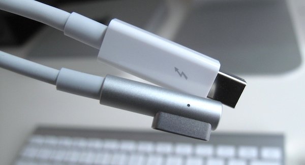

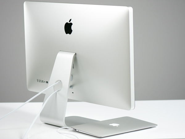

My Apple Cinema Displays were connected from a Thunderbolt cable that is hard connected to the monitor. I has a male Thunderbolt jack and a MagSafe connector. I plug the Thunderbolt jacks of the two monitors directly into the Thunderbolt ports on my Mac Pro. I have attached photos. The two monitor set up was working fine until suddenly it didn't.
