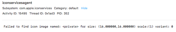

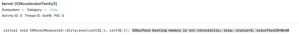

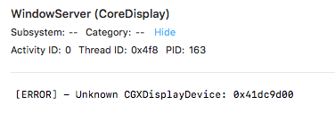

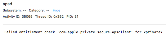

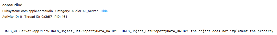

When you say FLAGS UP you mean in DEVICES section of console? I see yellow dots and red even. Is it what you mean? I never looked there before. GOOD I KNOW NOW. I usually looked in the syslogs trying to figure out how to interpret that information. no luck
So far I see:
