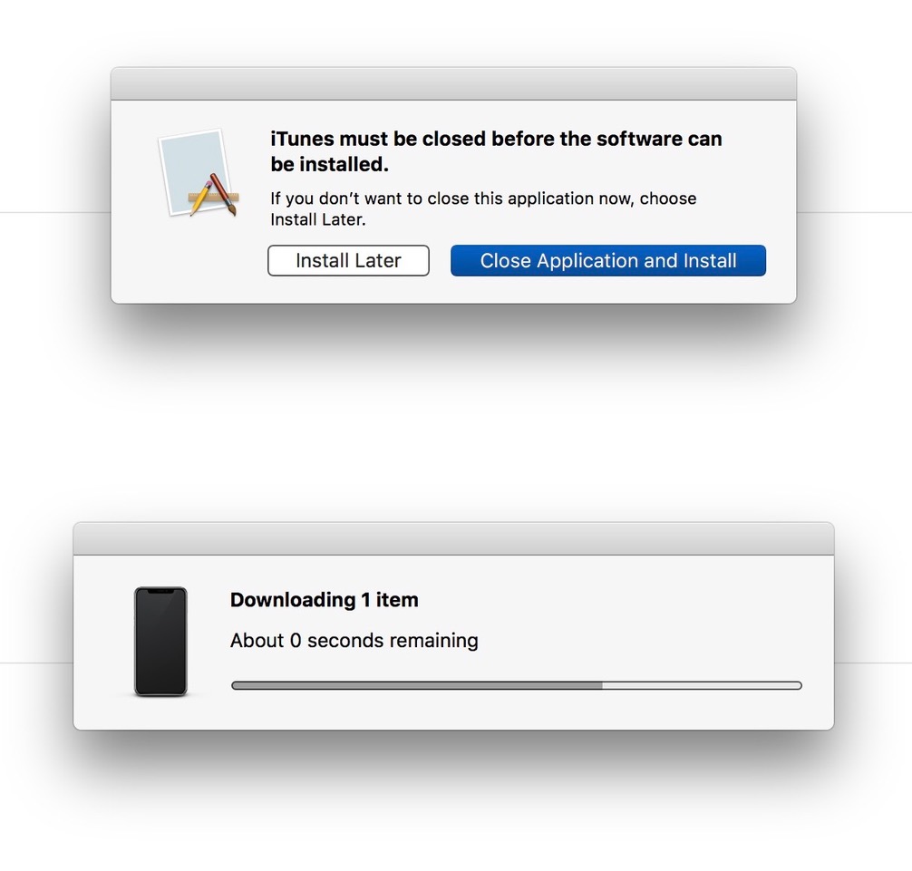

I had a similar experience when connecting my new iPad Pro to my iMac in order to do a restore off of my old device's backup. I tried two different cables, the Belkin and another. Then decided to restart my Mac. After the reboot, a message popped up on the Mac screen detailing that a download was required for iTunes to “recognize” the iPad ,(cannot recall exact words of message), and that iTunes needed to be closed for the download to proceed.
Thereafter, iTunes could “see” the new device with no problem.
Just a thought.......could your problem be the same?
Edit: I had taken a screenshot off the iMac of the process, see above. Before that download, iTunes could see my old iPad, no problem. But as soon as the new one was attached via cable, it was a no-go, or rather a “no-see”.

Interesting. Now that you mention it, I had this same experience when updating my iPhone to iOS 12. iTunes prompted for an update with that dialog box I had not seen before.
Reactions: laurenr
Yep, had to do the same for iPhone on iOS 12, so makes sense OP needs this update.
Would be a great pity if OP returned the iPad without at least trying to reboot his Mac to see if it forces the required download, as it did with my situation. Might just work for him.
