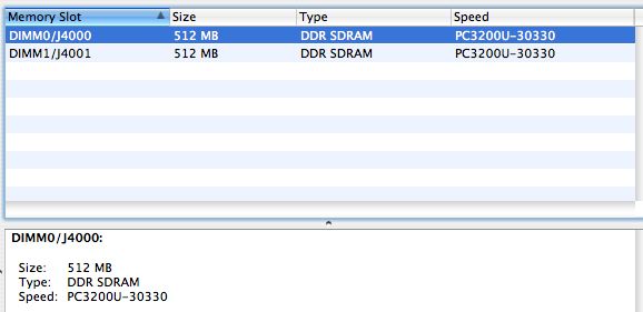

I ordered my iMac G5 with 1 512MB DIMM from Apple, and a bought a second 512MB DIMM from Crucial (Crucial brand, but bought for less from someone else).
Anyways, I opened up my iMac and installed the new chip, and also took a look at the Apple provided chip. I was happy to discover that the chip already in my iMac had the same Micron sticker on it my new chip from Crucial did. So both chips were from the same manufacturer and had the same CAS latency of 3. However, I noticed that my new chip from Crucial had all its little memory chips on the same side, whereas the Apple provided chip had memory chips on both sides.
So now my iMac is up and running again, and recognizes that I have 1GB of memory. However, when I run this Applescript provided by MacBidouille, it reports that my memory bus is still only 64 bit. Is there anything I can do to get it switch to 128 bit?
I've attached a picture of the memory section of my System Profiler, and also attached the Applescript so that others can test their iMacs. I'd appreciate reports from others who have run the test.

Um, did you ever think that because the chips are setup differently, they are different. Thus the idea that same chips produces 128bit, does not apply. English Translation: "We thus had the confirmation which it is not enough to put two of the same bars cuts to be entitled to the 128 bits."

Of course I did, that is why I mentioned it. If I hadn't noticed the difference myself, then we wouldn't even have a starting place for why I'm still stuck at 64 bits. However if the memory chip layout is the true reason for the problem, this is going to become a very serious issue for a lot people. When you buy RAM you don't get to specify how the chip is constucted, and you don't get to ask Apple to give you a chip with a specific construction when you order your iMac G5. This would make getting a 128 bit memory bus very very difficult, unless you throw away whatever chip Apple gives you, and install 2 new chips. Part of the reason I posted this in the first place is that this information is going to be very important to anyone looking at getting (or who already has) an iMac G5.
