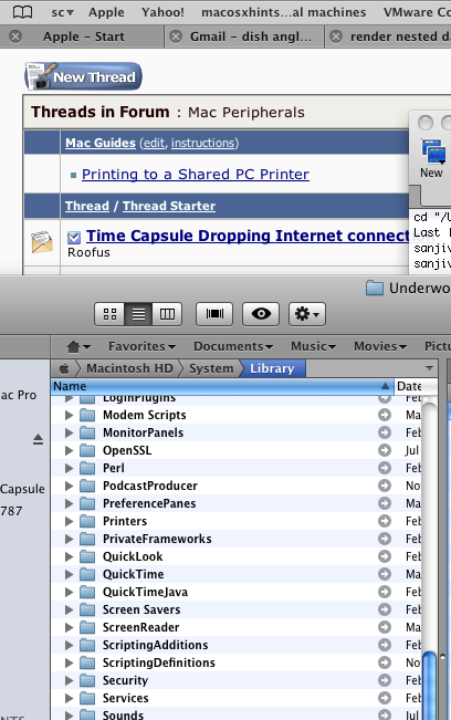

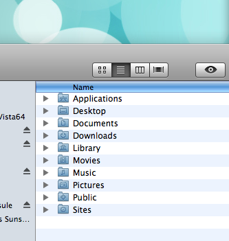

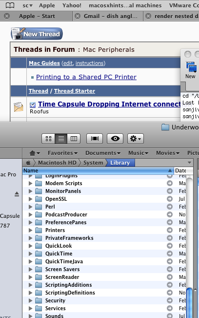

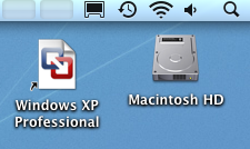

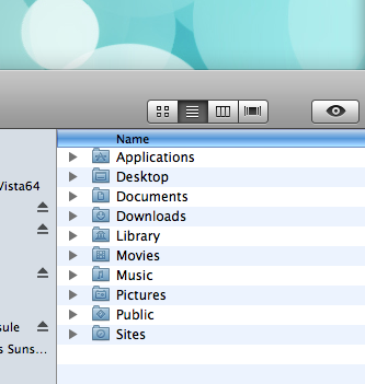

    Yes, I'm running at native resolution of 2560x1600. Screenshot attached.
    The second image is that of a desktop shortcut. I recall examining this icon display closely when connected to ACD at it was much more clear.

    The default font smoothing style is "Automatic - best for main display". With most monitors, that is equivalent to "Standard - best for CRT". When an Apple monitor is connected, it is equivalent to "Medium - best for Flat Panel".
    "Light", "Medium", and "Strong" use sub-pixel antialiasing, which helps make text sharper on LCD monitors. I prefer "Light" actually.
    Your screenshot shows "Standard" style rendering. Try setting the font smoothing style to "Medium - best for Flat Panel" or "Light" and reboot. You have to reboot (or log out and log back in) for the changes to fully take effect.

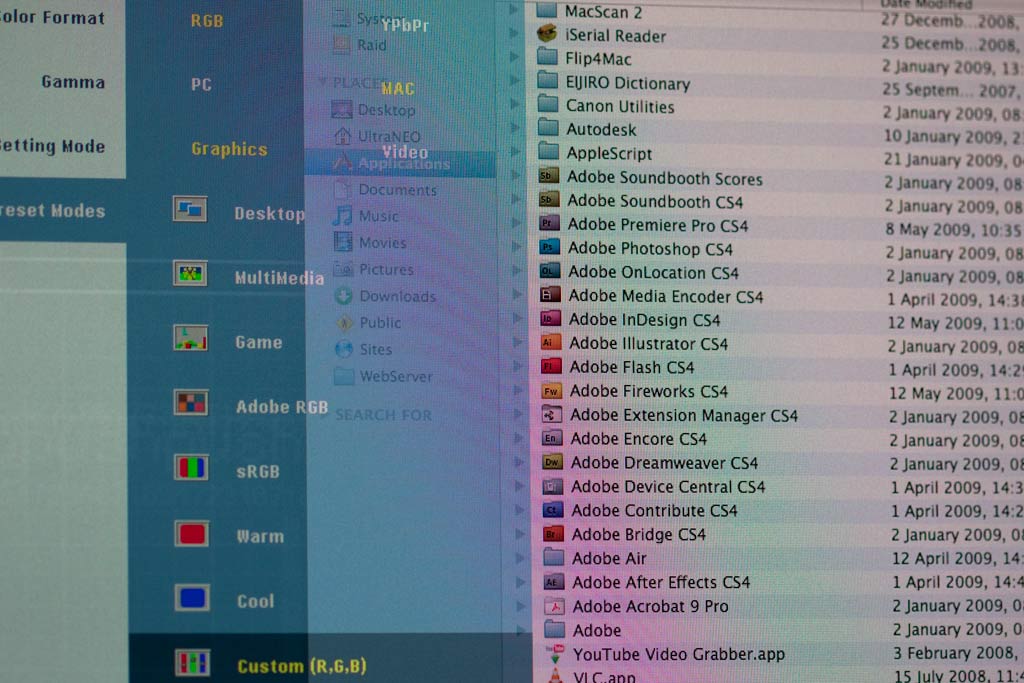

    Hello. I've been experiencing a some of the same issues as yourself, I have both an ADC30 and DELL side by side and they're both on the same system. Looking and comparing the text to each display the DELL does indeed appear slightly blurry/ghosting.
    After some tweaking on the actual monitor via it's menu, I've managed to solve the blurry text issue. So, Forget tweaking the colour profile for a moment.
    Out of curiosity what are your 3008WFP monitor settings, set to?
    You need to hit the Menu button on the display and shift the cursor to Preset Modes. I use mine for Graphics and Video editing, so my setting are:
    I've discovered if you set up your monitor for any other value, other then Custom RGB, the text display will be a little blurry with a slight ghosting around the fonts.
    Hope this helps you.
    It's not a screen grab but a actual photo of the screen hence the RGB effect.. Have a look at the text...
