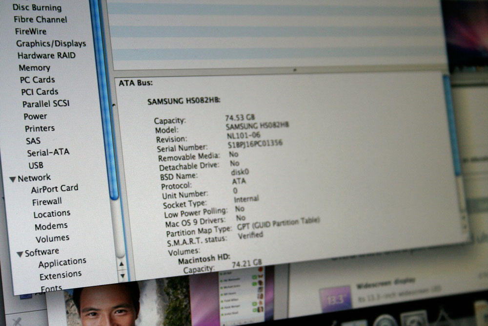

    OK found more info. Thanks to an image on AppleInsider I found the MacBook Air hard drive is a Samsung HS082HB Hard Drive with a PATA ZIF Interface and its 5mm thick.
    http://www.samsung.com/global/busin...up=72&type=60&subtype=68&model_cd=306&tab=fea
    [​IMG]
    From what I have determined all the larger 1.8" hard drives (100-160GB) are 8mm thick so the questions left are...
    Is there room in the MacBook Air for an 8mm Drive?
    Is the iPod 160GB Drive PATA ZIF and is it 4200 RPM?
    If both are a yes then I might have me a new notebook soon.

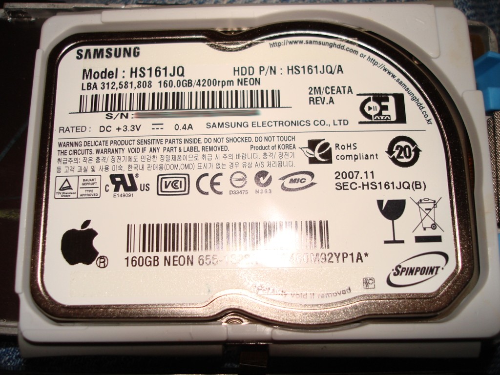

    Sigh so much for that idea. My poor 160GB is now scratched and slightly battered for the sake of curiosity.
    Samsung Spinpoint HS161JQ 4200RPM, 2MB Cache, CE-ATA Interface (needed to be PATA ZIF to fit the macbook air)
    [​IMG]
