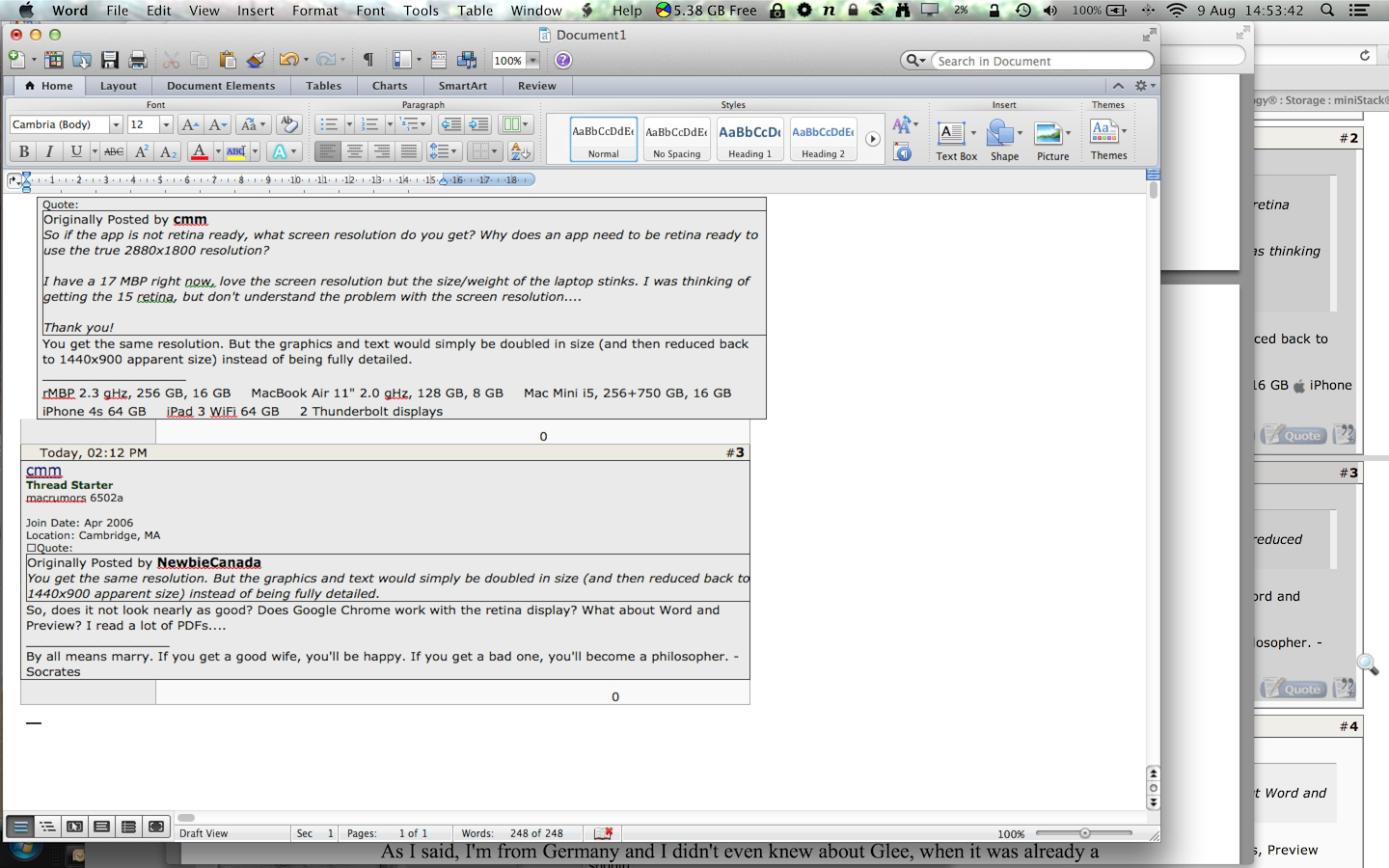

I've pasted some of the text of this thread into Word, did a screen cap (2880x1800) and reduced it in size to 1440x900 (the apparent onscreen size).
So you can judge for yourself how Word looks.

Thanks all! Word looks okay, but of course, the higher resolution would be better.
