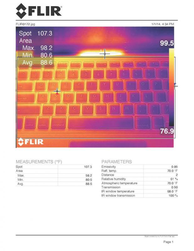

Your fans run when they need to, and air is released at the hinge. Most heat is on the left side of the machine because of the GPU location.
Here is a shot I took of mine running multiple programs (photoshop, Indesign, illustrator) while playing iTunes and streaming a move. The fans kicked on periodically as needed.
Don't sweat the fan issue, they are designed to run and ventilate at proper temperatures.
