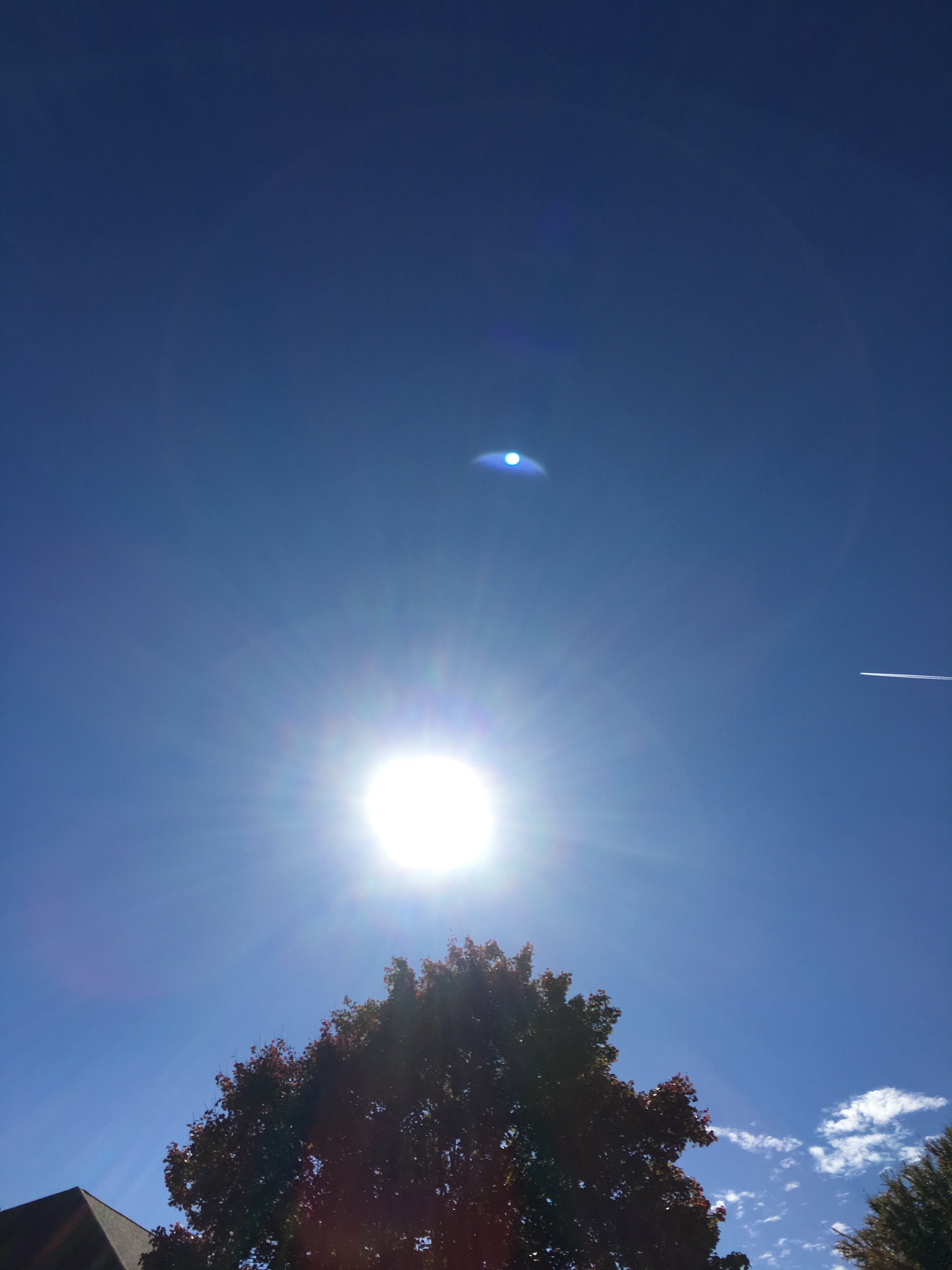

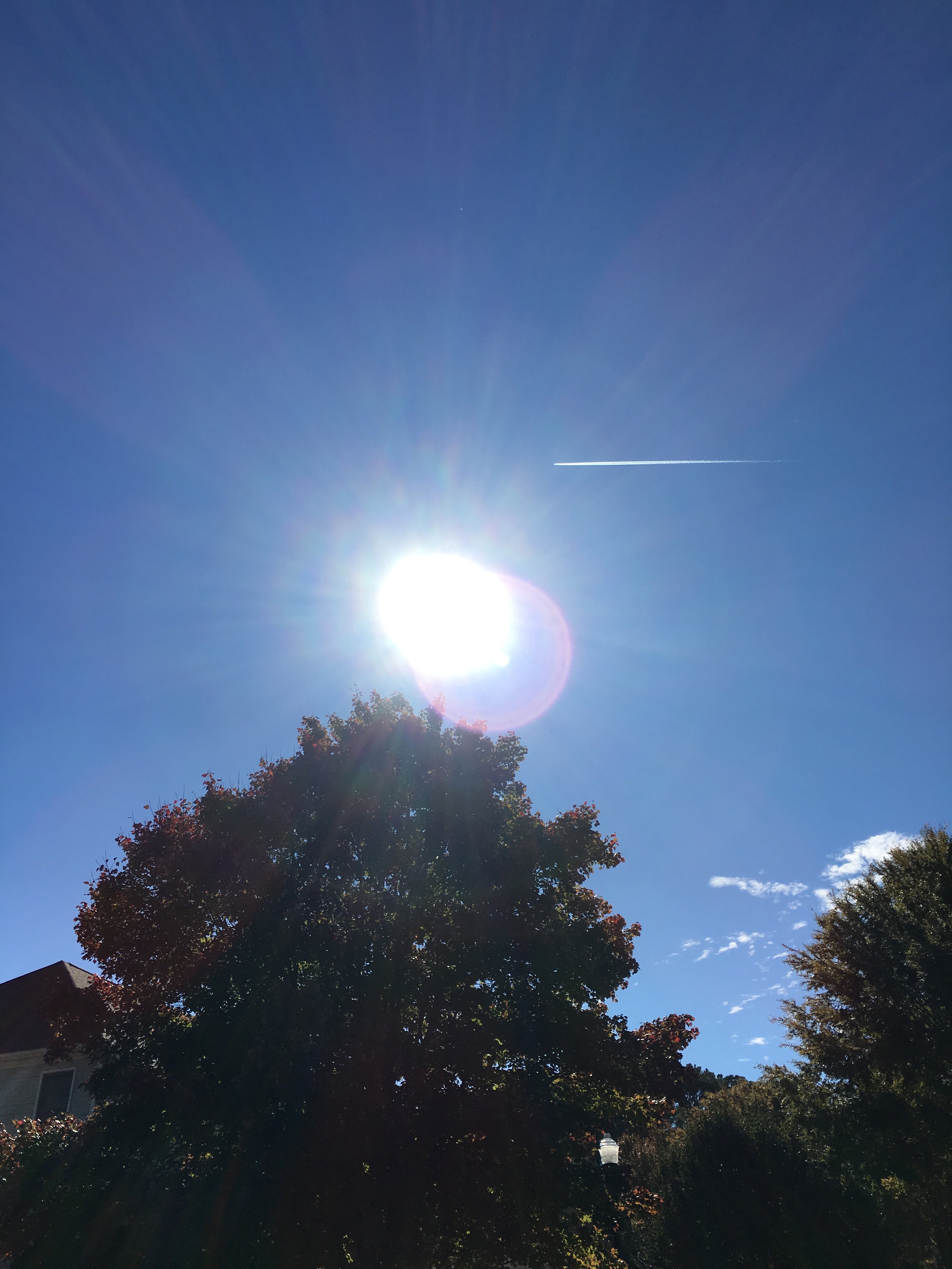

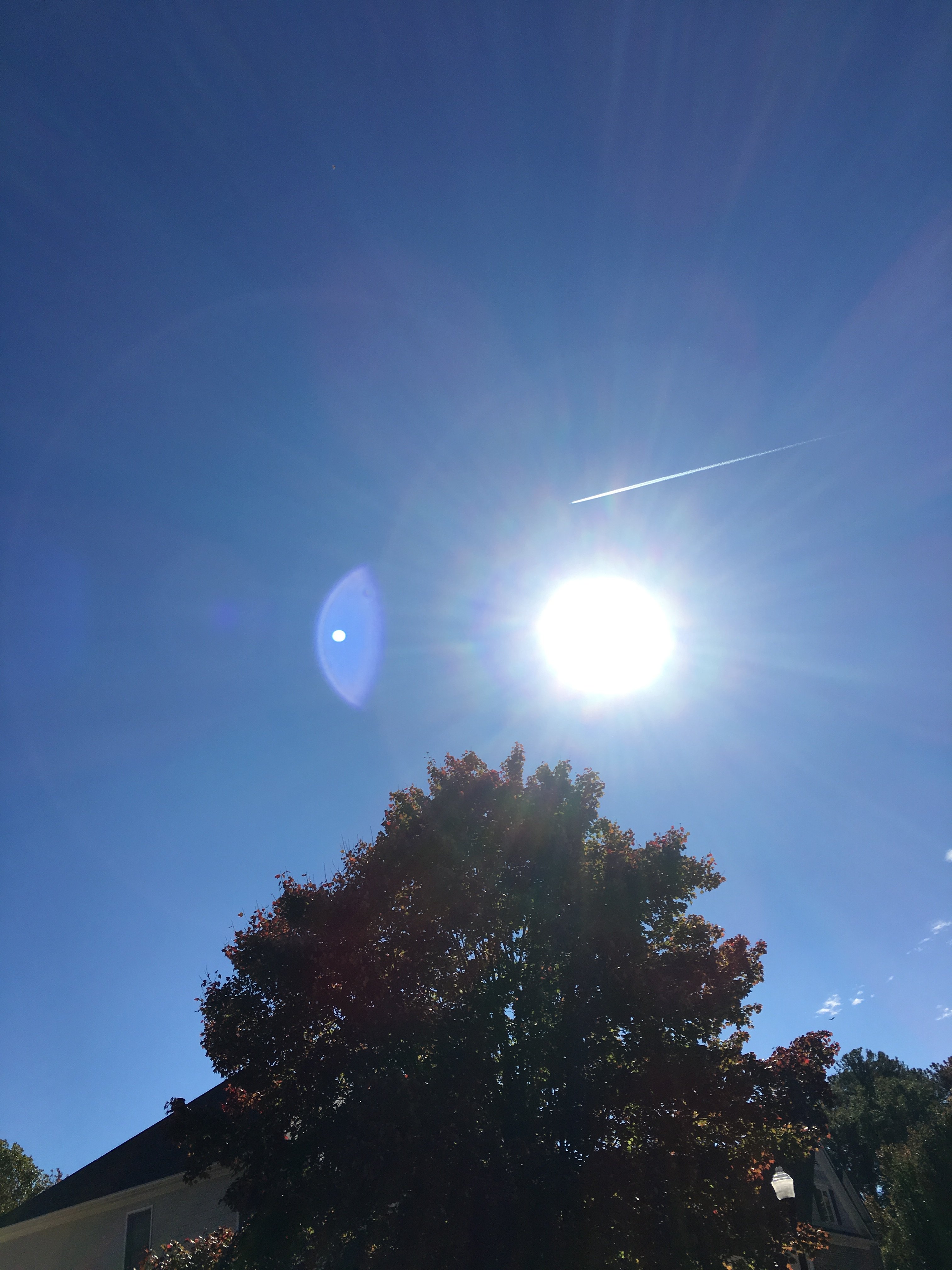

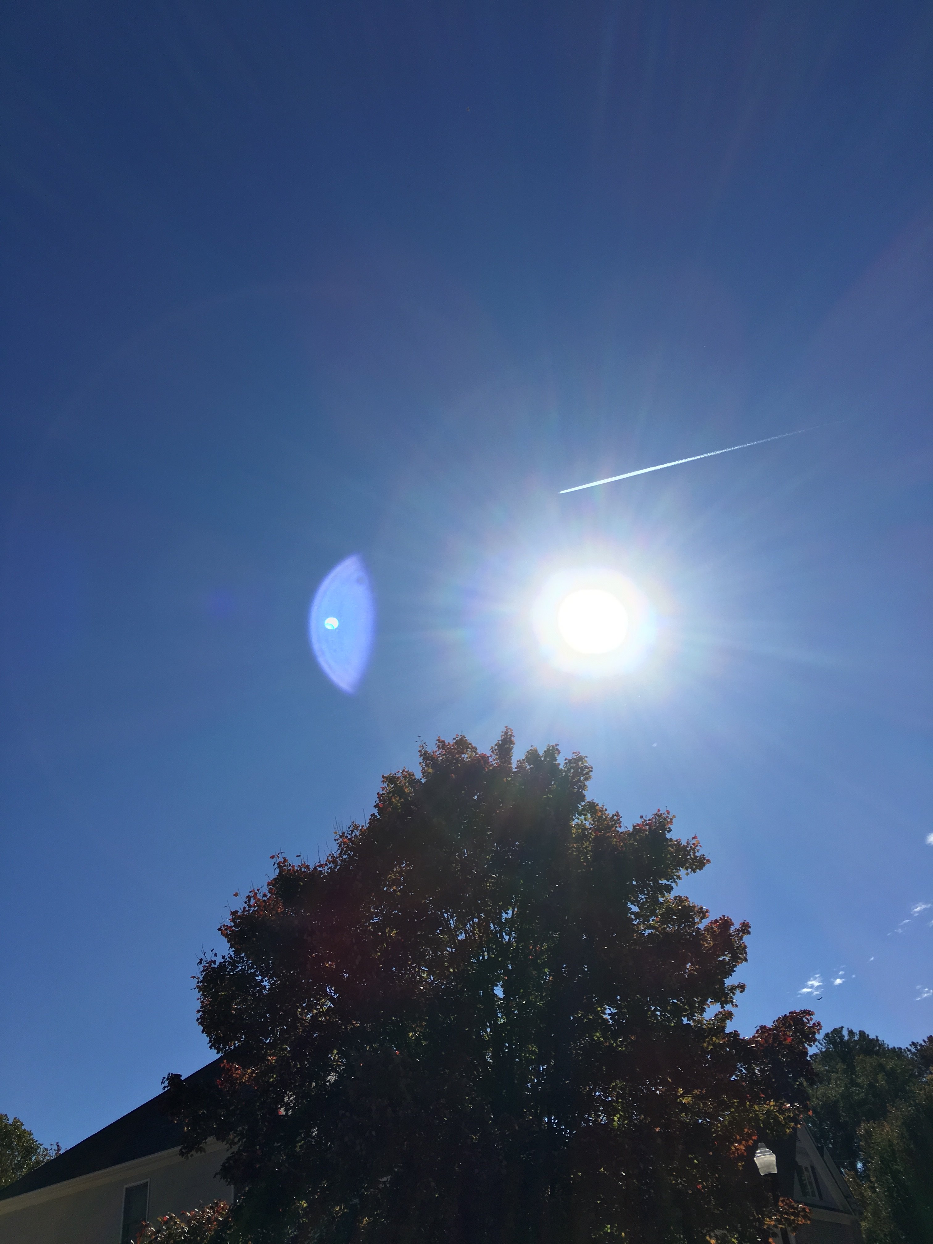

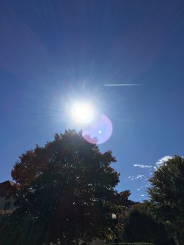

I was just taking pictures outside with my iPhone 6s and I decided to take a few of the sun. Later I learned that any camera is susceptible to damage to the sensor from this. How do I know if my camera was damaged by the sun?
[doublepost=1478610514][/doublepost]These are all the pictures I took.

Your photos seem to be exhibiting normal lens flaring. It looks fine, but I wouldn't suggest spending minutes at a time focusing the camera sensor at direct sunlight.

The artifacts are called lens flare, watch anything by Michael Bay and you'll get an eyeful of lens flare. It's normal.
