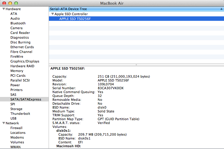

    I bought a new 2013 11-inch MacBook Air 2 days ago and it has a 256GB Toshiba SSD. The drive's name says, "APPLE SSD TS0256F." I don't see any reference to this drive other than on the Japanese 2ch, so I'm willing to bet it was introduced very recently (i.e. September). I'm not about to tear this thing open and look at the all-important controller being used, so I can't say for sure if it's using a Sandforce controller, though it's quite likely that it is. It looks like it can do about 700MB/s read and 500MB/s write, which is probably slower than the Samsung SSD's floating around, but not by much.

    I hope somebody looks this one up soon as I would return that machine if I were you if Toshiba has continued to use Sandforce controllers.

    ^^^^I googled it, and could only find Asian pages which I had translated. I THINK they said the dries had Samsung controllers with Toshiba SSDs.

    Well that's good. That would make sense if the complaints people have been having actually made it to someone within Toshiba. I'll just assume it's true and buy AppleCare next year if I'm still not entirely convinced this computer will be with me for the long haul.

    Thanks for the post. The failing Toshibas in the 2012s were all 128GB models, so hopefully these new 256GB 2013 models use a different controller.

    Most likely the 2013 Toshiba SSD's are using their in-house hybrid Toshiba/Marvell(thankfully not Sandforce!) controller as perusing through their latest SSD offerings are being powered by this controller.

    I work for an Apple authorized repair center. Toshiba SSDs are using a different controller than prev model.
