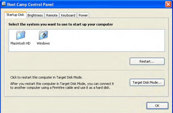

AFAIK, There is no Mac EFI (not UEFI) for 750Ti for self flash yet, you must send it to professional like MVC to do it for you.
Anyway, you can select start up disk in system preferences in OSX (and within Bootcamp apps in Windows), no need the boot screen.

i mean apps to choose a startup disk from windows so i will use mac because i dont have a booting screen
We know what you mean. I don't think you understand that you've been given the correct answer already:
Reactions: Lucas Godfrey
Comment
h9826790
macrumors P6
Apr 3, 2014
15,191
7,509
Hong Kong
thankyou but i didn't find it on my bootcamp
Did you really install Windows by bootcamp? Or install the Bootcamp driver / apps after your own Windows installation?
That apps is from Apple, and only can be downloaded inside the MacOS Bootcamp assistant. That's a large set of files including all drivers and this apps.
If you install Windows via Bootcamp assiatant. The installer should run automatically after Windows installation complete. However, if you install Windows by yourself, you must manually run the installer, otherwise that apps won't come out from nowhere. It's not a part of Windows, but a 3rd party apps (to MS).
