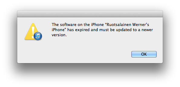

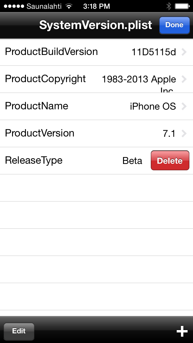

As I've promised at https://forums.macrumors.com/showthread.php?t=1688110 , I had a closer look at the possible compatibility issues under 7.1b2, particularly because it's much superior to 7.0.4 WRT the UIWebView / Safari behaviour. In addition, I wanted to be sure my own tweaks / apps (see for example https://forums.macrumors.com/showthread.php?t=1566350 and https://forums.macrumors.com/showthread.php?t=1538193 ) I've updated to iOS7 yesterday are compatible with 7.1.x.
Unfortunately, iH8sn0w's advice HERE (also repeated in this very forum quite often; for example HERE) doesn't seem to work. If you do remove the ReleaseType/beta key/value pair from /System/Library/CoreServices/SystemVersion.plist :
and, after increasing the date to, say, Feb 2014, hard reset the device (so that SystemVersion.plist is re-evaluated), it'll get into exactly the same reactivation loop as without touching SystemVersion.plist at all:
Did anyone have any success with actually testing the hack with manually-set system dates after applying the hack?
NOTE: I've only tested this on an int'l GSM iPhone 5 but not on an iPad or an iPod touch. (Prolly it's the iPad, which isn't in need of phone activation, that other people had success with?) I've tested two times:
- first, I immediately changed the date after editing the plist file and, only after that, did I reset;
- second, I reset after editing the plist file and only after the reset (which booted in just fine) did I change the date to February, 2014. (Needless to say, the next reset resulted in the activation boot-up sequence, resulting in the need of a full restore.)
ALL IN ALL,
(at least if you have an iPhone), don't trust this hack - it won't prolong beta2 beyond 24/January/2014. It does not seem to work at all - at least not on iPhone 5's.
EDIT (27/Dec 4:39GMT): the hack doesn't work on iPads either (see below). That is, it seems you should not trust it.
EDIT (27/Dec 18:50GMT): I've received other reports of the "hack" failing (see below). This all means I was right: the hack no longer works with 71.b2.

Perhaps in real time it'll kick in and work.
I don't think so. I've tested the stock (without even JB) 7.1b2 with the same methology (setup and, then, manually setting the system date to February, followed by a hard reset). It produced exactly the same symptoms.
This is why I'd like to know whether anyone has proof of this working. I know it did work back in the iOS5/6 days but Apple could have changed it in the meantime and iH8sn0w only called this the solution because of his past experience with older iOS versions, not necessarily 7.1b2. (Dunno if he has indeed tested the hack with 7.1b2 or just thought the old hack would work this time too.)
