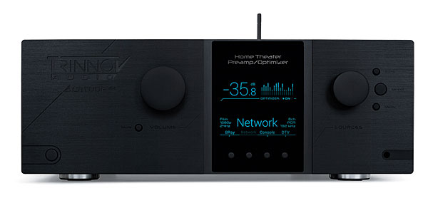

The viewer in the video seems to be a companion app to the Trinnov AV line of receivers, the base model is $17,500, and they go up to $29,000. And that doesn't include Atmos, if you want to do that, it's a $2,500 add on
