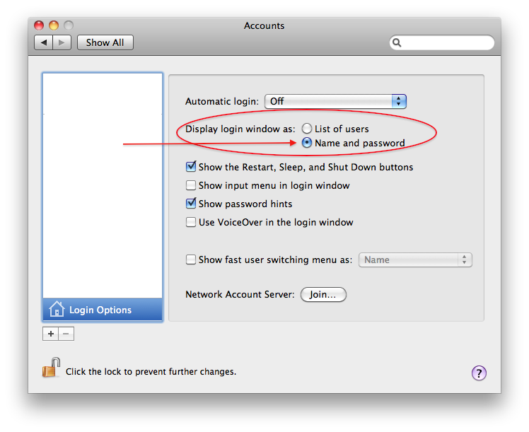

This maybe?
But that way, you will login as yourself (John Doe), not as Jane Doe.
