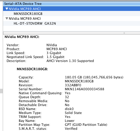

Hello,
I've upgraded my mini to a SSD Disk today but it's only working in SATA 1, it doesn't work in SATA 2, 3Gbit.
I've already tried SMC / NVRAM reset and didn't have any luck.
The SSD is a Mushkin Chronos 180GB SATA 3 (MKNSSDCR180GB).
Does anyone know how to make it working in SATA 2 mode?
Thanks!

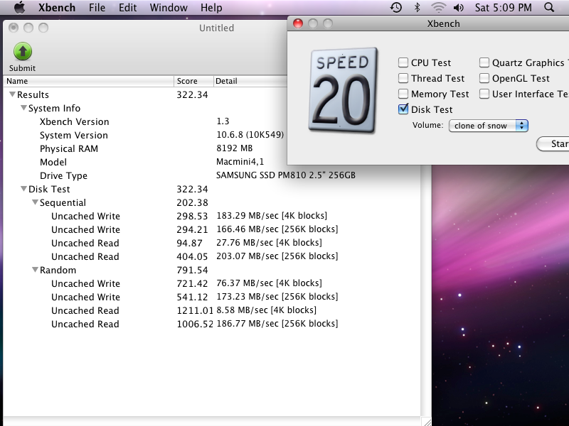

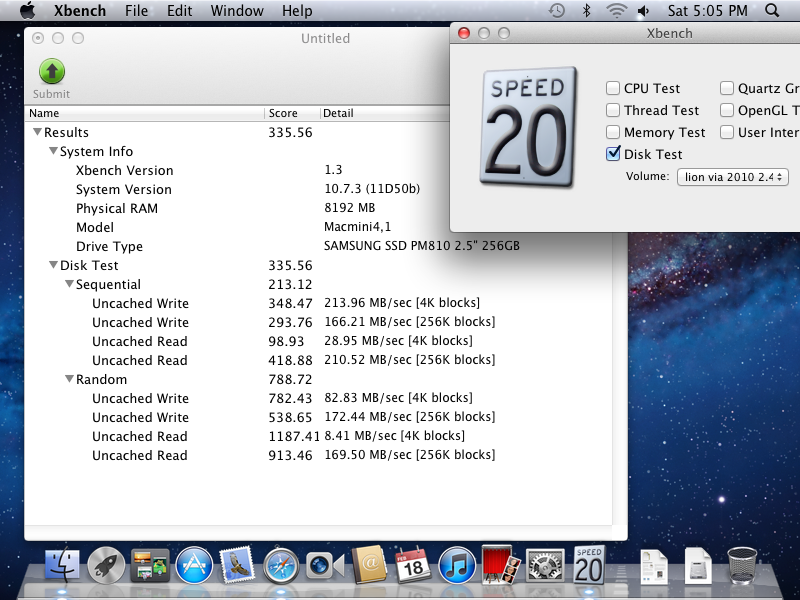

samsung series 470/830 works at full speed. can you humor me just a bit and run an xbench test.
http://xbench.com/ go to the upper right and click on the down load.
I just ran 2 xbench tests on my 2.4 mini from 2010. one was using the samsung in snow leopard the other was using the samsung in lion.
i would be interested to see your scores. if you use the machine for anything except long copies you will not suffer that much. I would like to see if your xbench scores are close to mine.

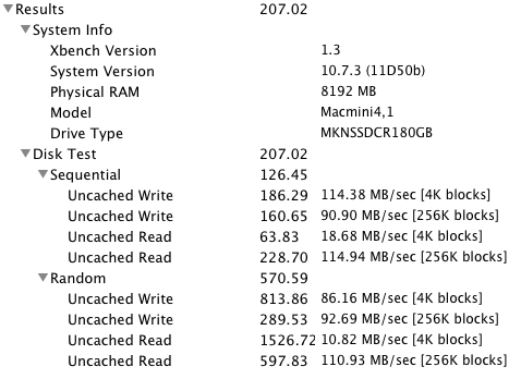

It's not about suffering or something like that. You can get mechanical HDD's to saturate a SATA 1 channel and they are much more cheaper.
Right now, my SSD looks like a good 7200RPM drive. The difference is that it cost much more!

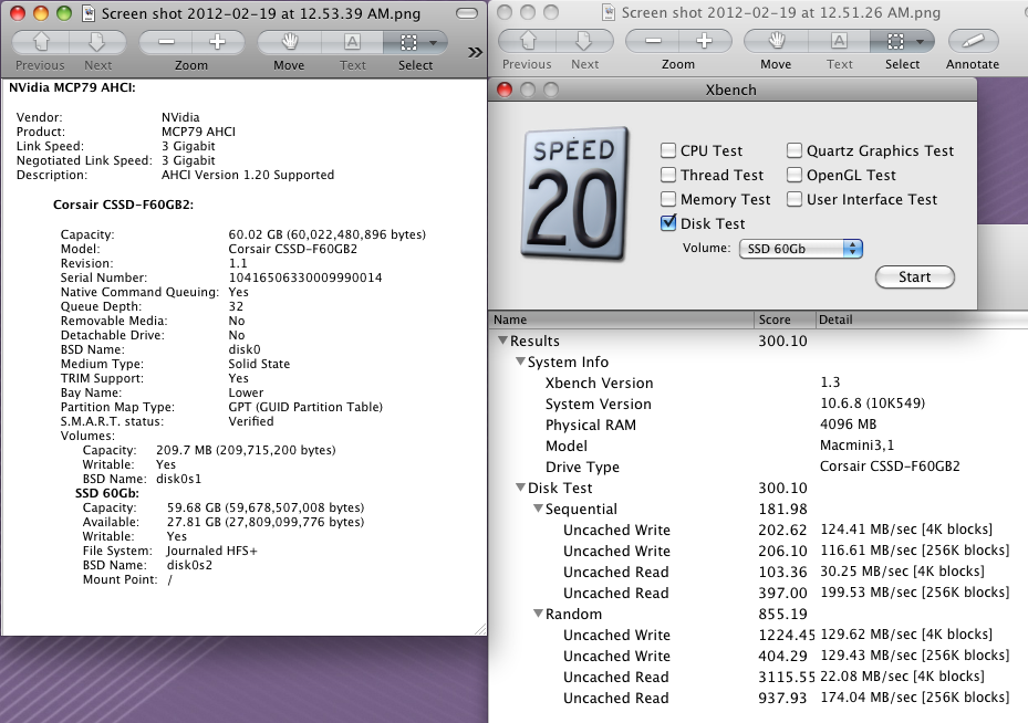

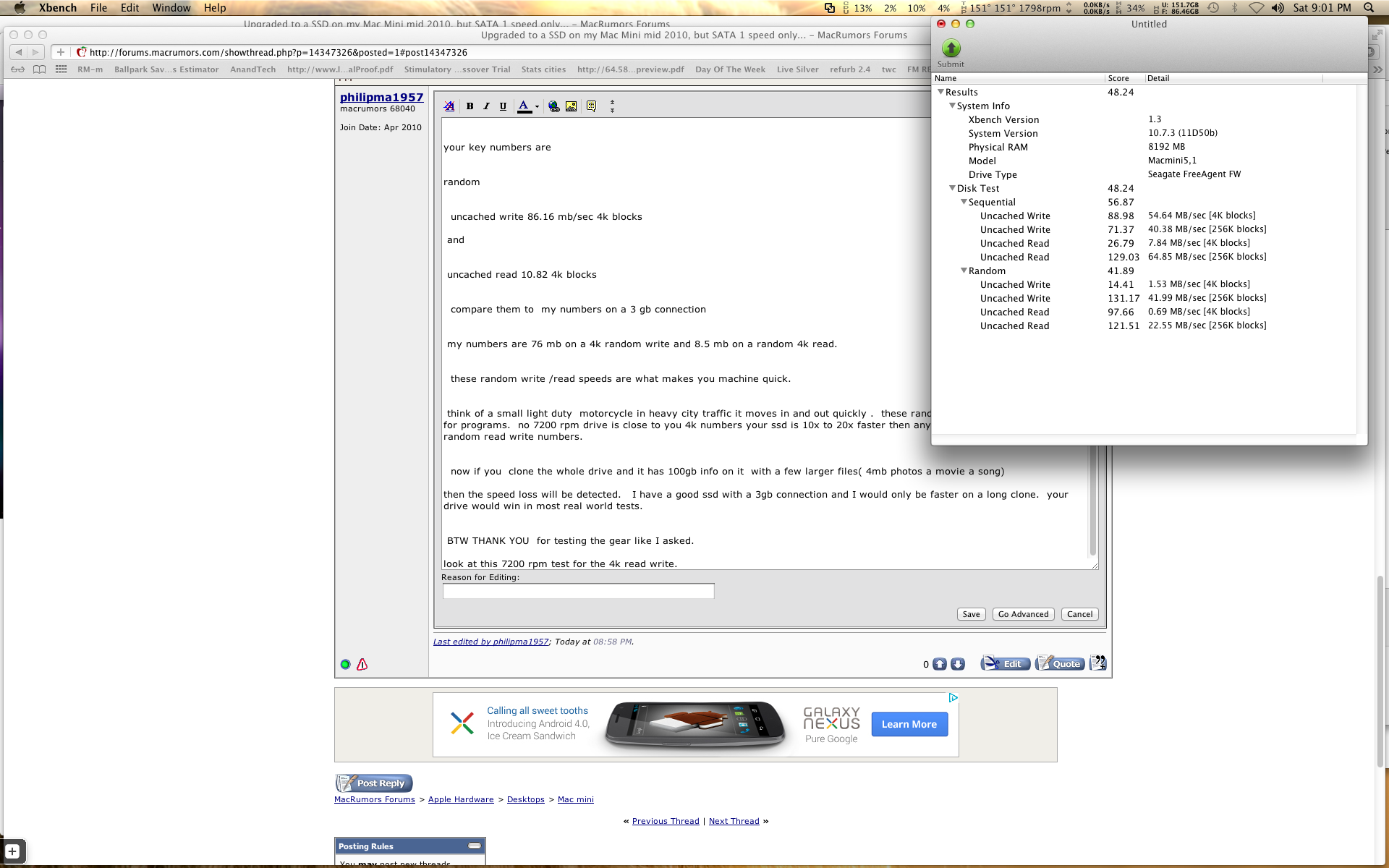

your key numbers are still unaffected, unless you are cloning this drive.
random
uncached write 86.16 mb/sec 4k blocks
and
uncached read 10.82 4k blocks
compare them to my numbers on a 3 gb connection
my numbers are 76 mb on a 4k random write and 8.5 mb on a random 4k read.
these random write /read speeds are what makes you machine quick.
think of a small light duty motorcycle in heavy city traffic it moves in and out quickly . these random w/r are all your key files for programs. no 7200 rpm drive is close to you 4k numbers your ssd is 10x to 20x faster then any 7200rpm drive in the 4k random read write numbers.
now if you clone the whole drive and it has 100gb info on it with a few larger files( 4mb photos a movie a song)
then the speed loss will be detected. I have a good ssd with a 3gb connection and I would only be faster on a long clone. your drive would win in most real world tests.
BTW THANK YOU for testing the gear like I asked.
look at this 7200 rpm test for the 4k read write. 1.53 and .69 you are 86 and 10.8 that is very fast no 7200 or even 10000 hdd will get your speeds.
I would still be annoyed that the firmware does not match up. I am only trying to explain that you are not losing that much speed in most cases.

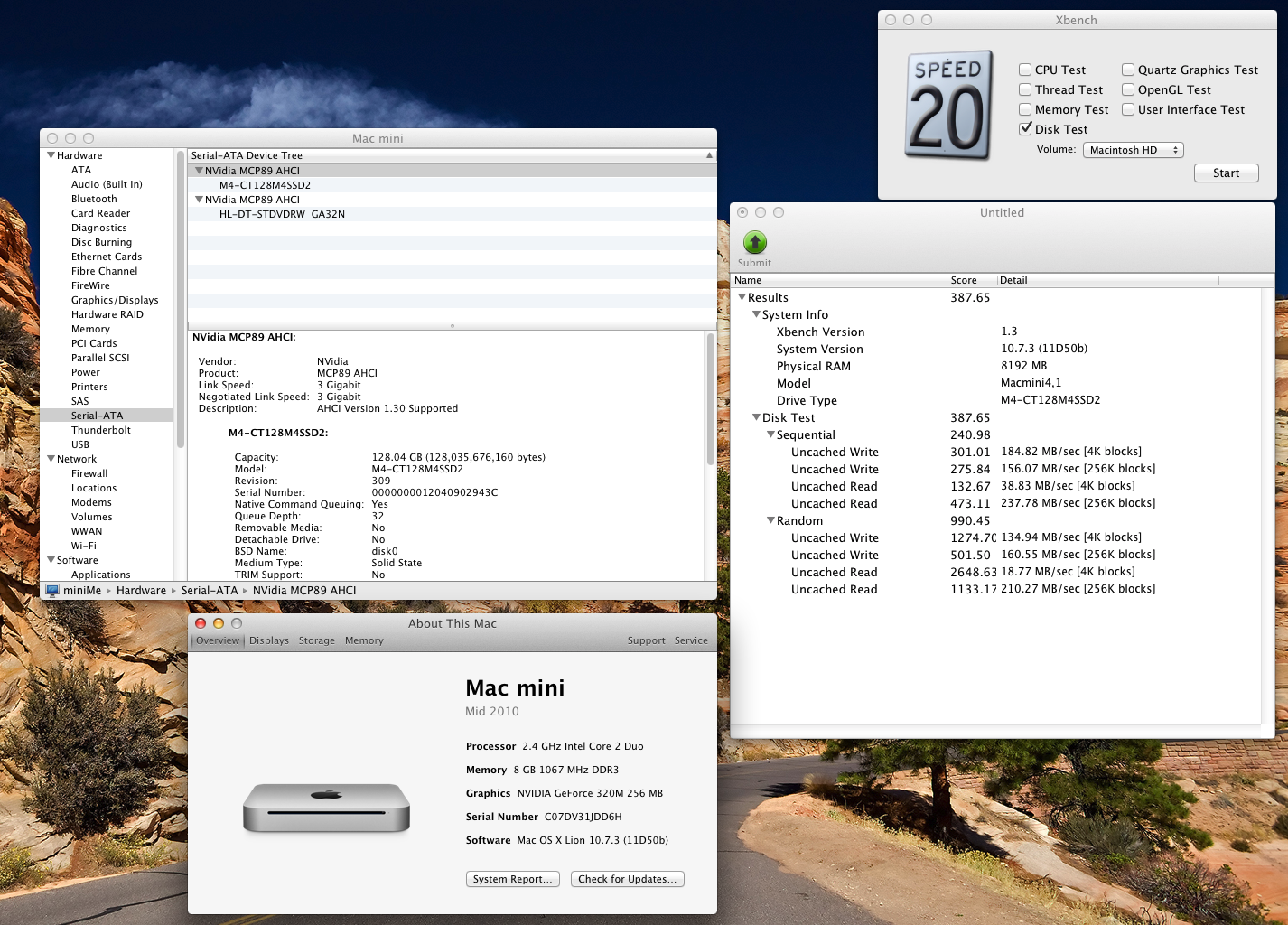

Just finished installing mine and cloning over my old 10.7.3 install. It's running at SATA 2 (3.0gbps) as expected. Attached my xbench.

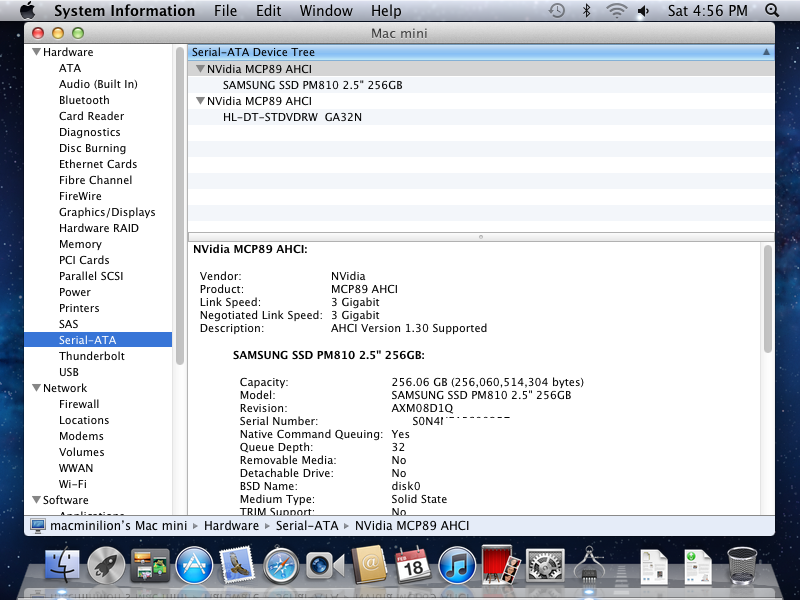

The problem with SATA 3 SSDs running at SATA 1 speeds on SATA 2 connectors only occurs with SandForce-based SSDs in conjunction with the NVidia SATA 2 chipset used in some Macs (see screenshot in first post).
Thus, if your Mac has the NVidia chipset, get an SSD that doesn't have a SandForce controller, e.g. a Samsung 830.
