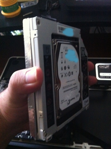

    The only think I was going to offer (having recently done what you're about to), was to check the depth of the HDD Caddy, as the one I ordered initially turned out to be too deep.
    However, looking at the pix supplied on that Amazon link, there's one of the caddy and the optical drive side by side and they look identical.
    [​IMG]
    Looks like you're good to go, enjoy!
