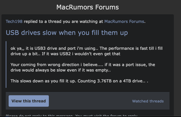

ok ya,, it is USB3 drive and port i'm using.. Regular spinning drive..
Your coming from wrong direction i believe.... if it was a port issue, the drive would always be slow even if it was empty..
This slows down as you fill it up. Counting 3.76TB on a 4TB drive.. .

I know why I didn't see the OP post about the "Regular spinning drive", the post was edited. I was really surprised that I could have missed that so I checked my email and this was the original post not mentioning anything about HDDs:
