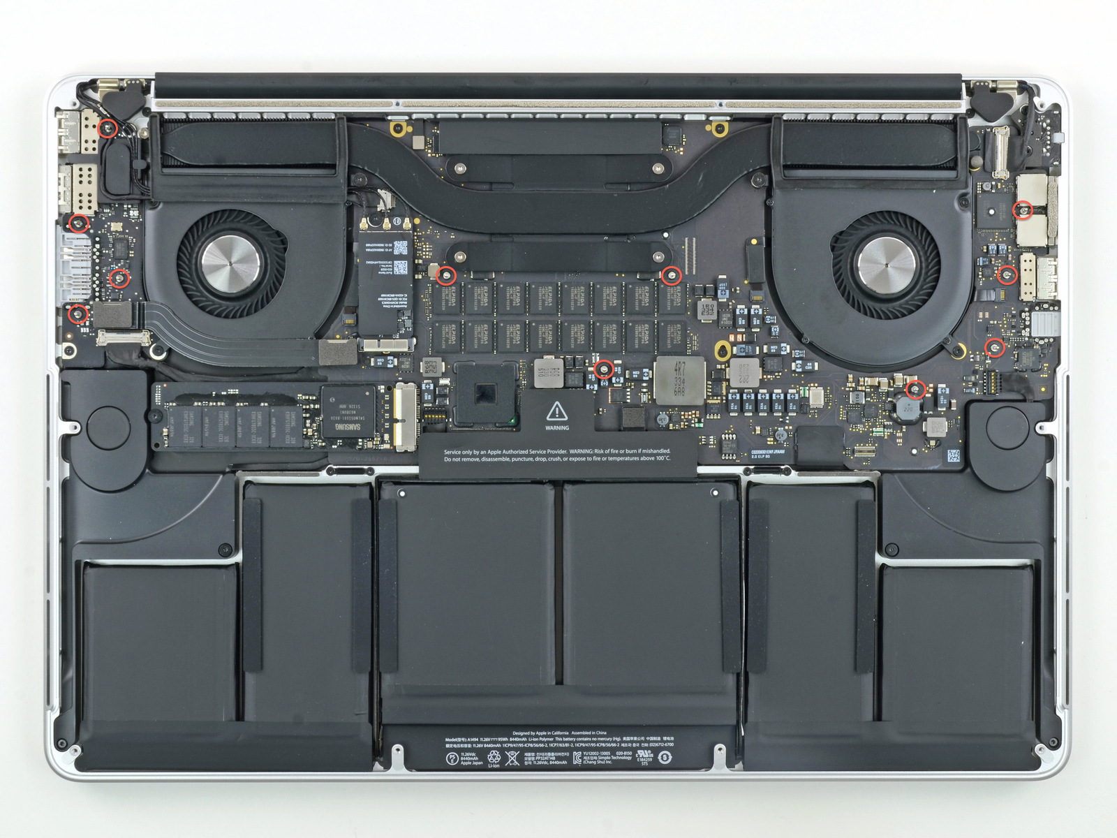

    It is normal but yes a tad irritating. As was noted by richard371 the sound comes from spring loaded grounding pins on the main logic board that contact the bottom panel. Looking at the iFixit teardown of the rMBP you can see the positions of them in red circles in the attached image.

    Not sure if it's a necro thread or not but I have the same problem as everyone else. I spent almost 2 hours at Apple yesterday (never go in earlier than your appointment!) waiting for someone to check it out. The technician said the same thing, it's the grounding spring and that it's within normal manufacturing standards. This is according to their own knowledge base. After tightening the screws down there is much less flex causing these issues so I'm not too concerned at this point, but I've only had this laptop for 1.5 weeks now. That's kind of scary for a less than 2 week old $2600 laptop.

    I've got the same clicking noise, when i showed the guys they said they will look into and send a video to apple, apple said its an issue with those springs which are on the logic board and cannot replace it unless i have performance issues with the logic board.
