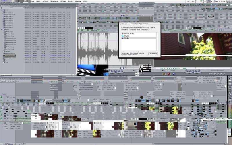

    I've now experienced the same type of video corruption as posted by djc6. Seems like it's becoming a daily occurrence (strange, since it worked fine for the first 2 weeks). Screenshot below.
    This results in a system freeze which required a hard reset. What are you guys doing about this? I'm not used to Macs crashing...this is like working on a PC all over again.

    I don't have a Mac yet (my first one is on the way!!) but that corruption looks an awful lot like the corruption I'd get from pushing my X800XT-PE's RAM too hard on an overclock, which causes the RAM to overheat, in turn causing video corruption.
    In other words, I'd suspect overheating. In preparing for my new iMac's arrival, I've seen this tool mentioned numerous times on this board and others: smcFanControl. You might want to try it out to see if better fan management helps your temps, in turn helping that video corruption. If the HD2600 Pro in the new iMacs is actually an underclocked XT (which has been confirmed), that alone tells me that Apple's engineers were trying to lower heat levels in the iMac (why else would you underclock a video card?) ... So, yeah. I may be wrong, but it looks to me like heat may be the culprit here. It's worth a shot, anyway.

    It looks like your video chip could be on the way out. I had a GeForce 6800 in my PC that did something similar and it had to be replaced.
    I think you might have to ask for a replacment. Bad luck :(
