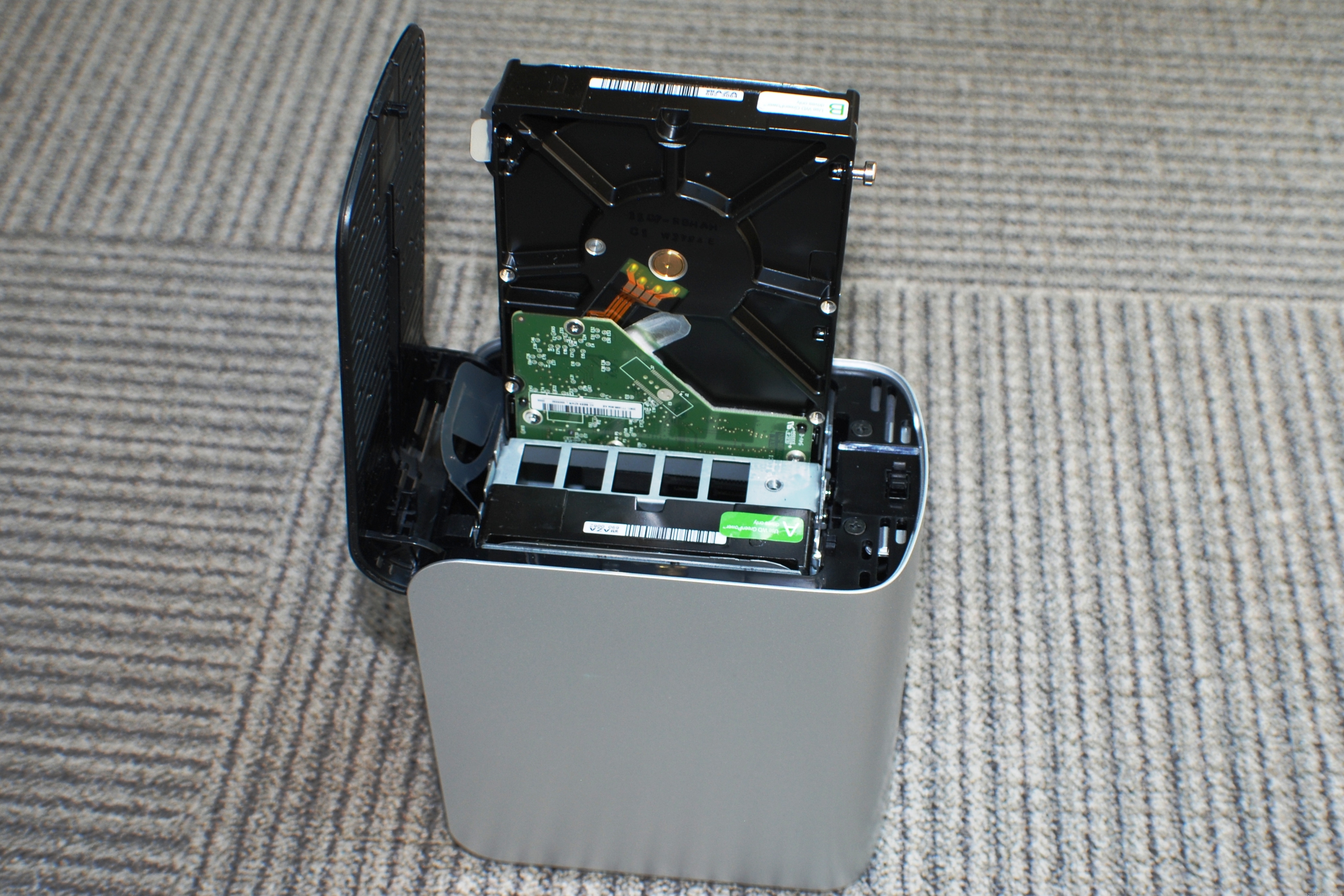

    Well, of course they do. Selling an 8TB Thunderbolt Duo makes them way more money then just upgrading the hard drives.
    [​IMG]
    Pop open the top, install two of the 4TB WD Greens (or 4TB WD Reds for $10 more if you run them 24/7) and watch what happens.
